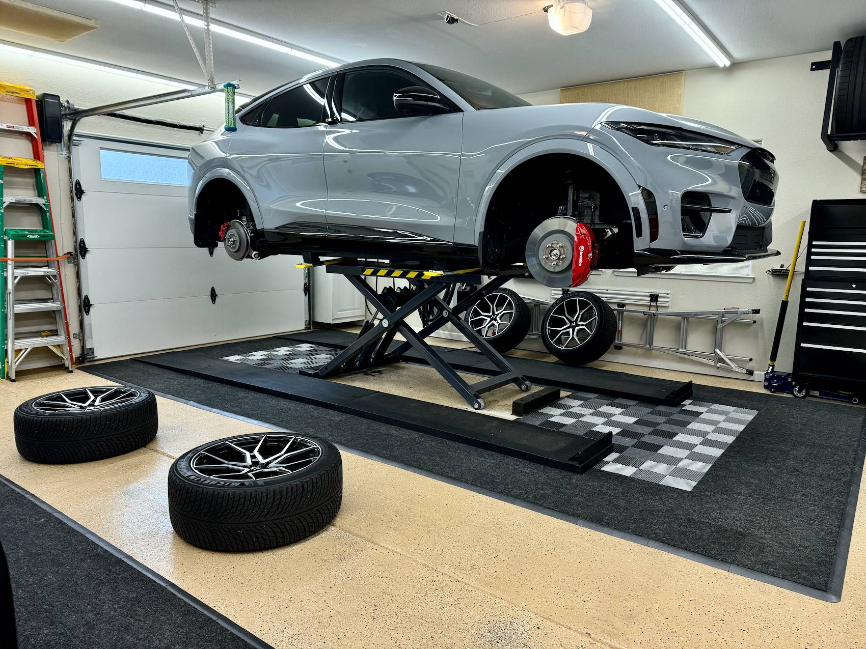

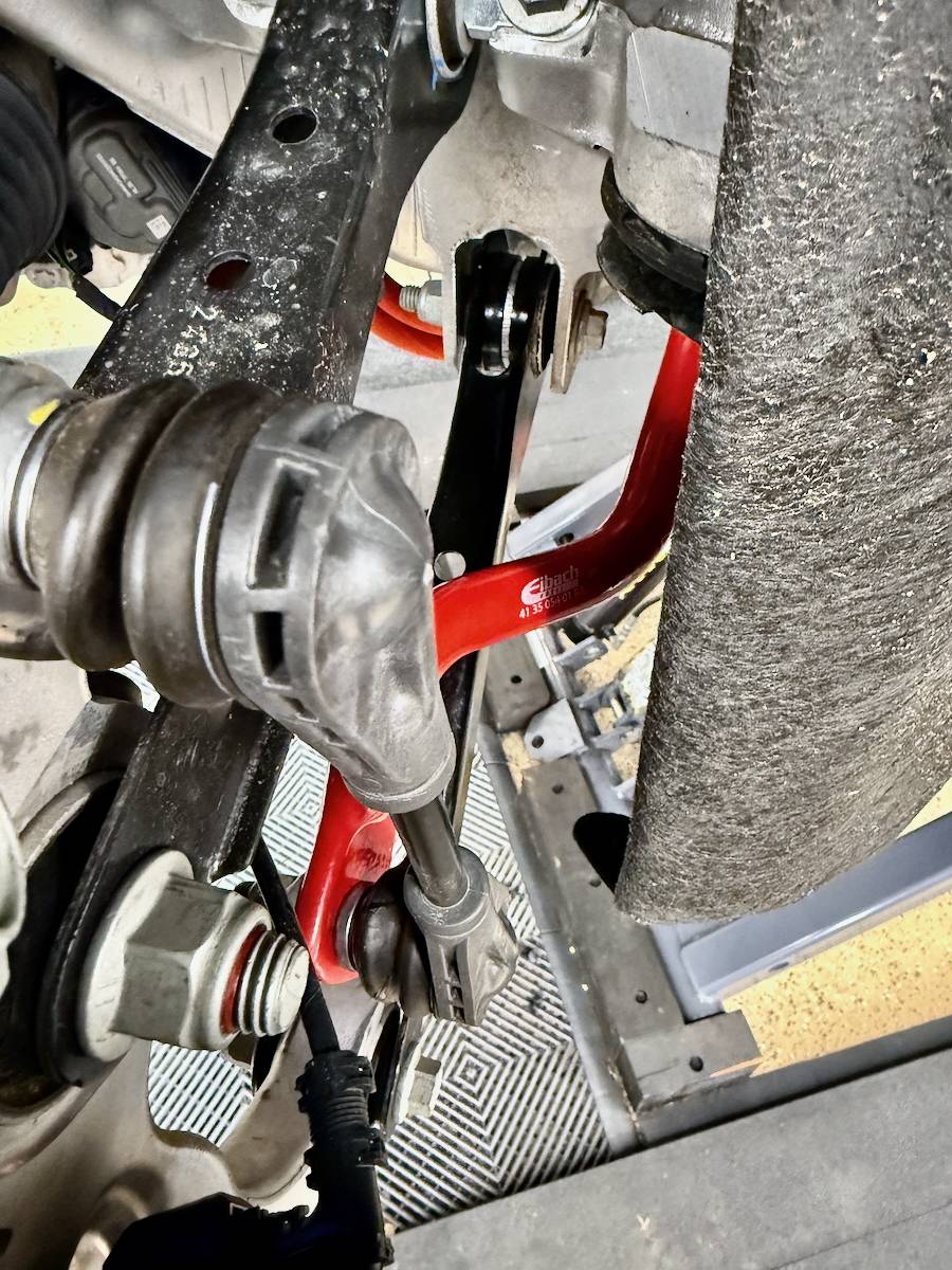

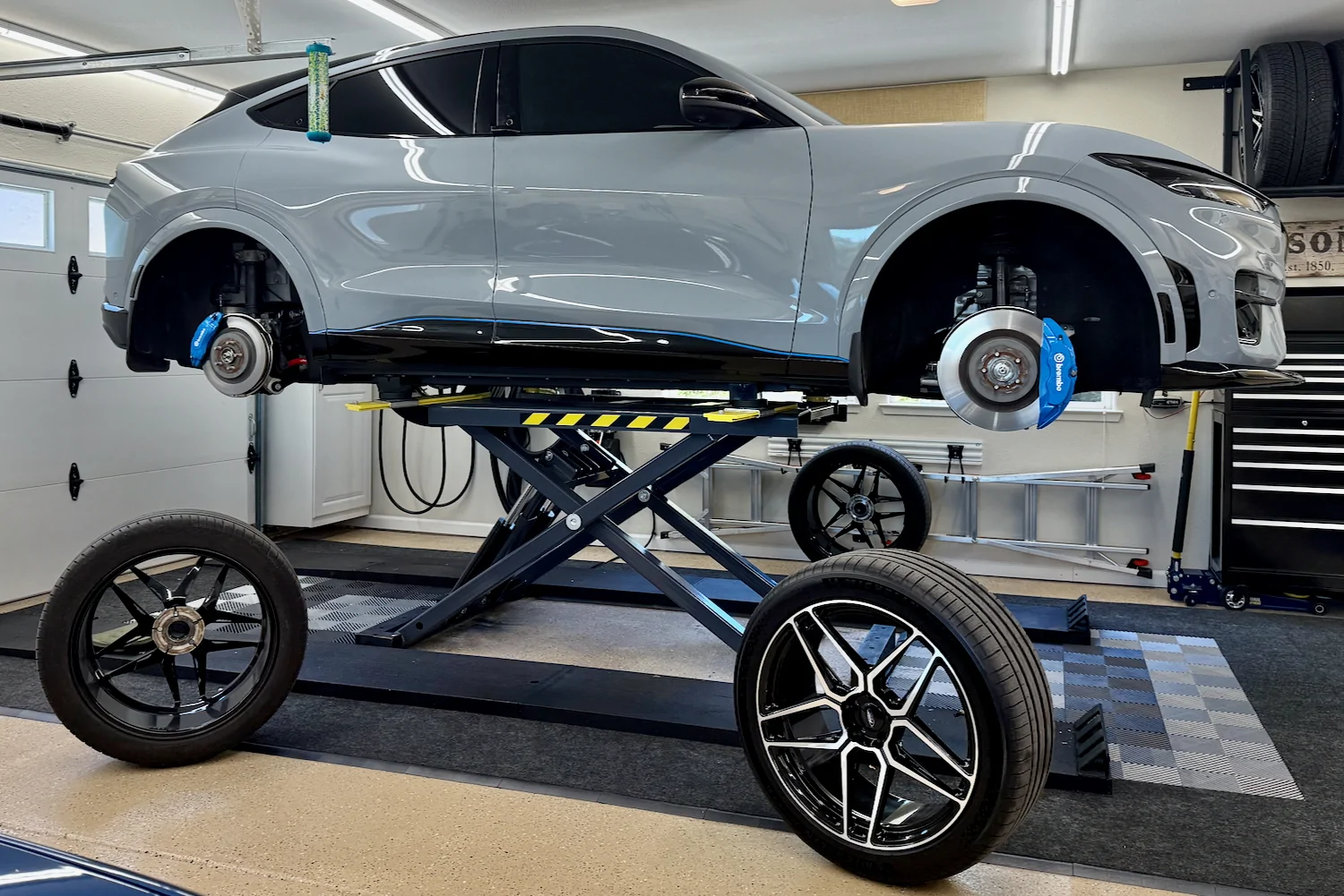

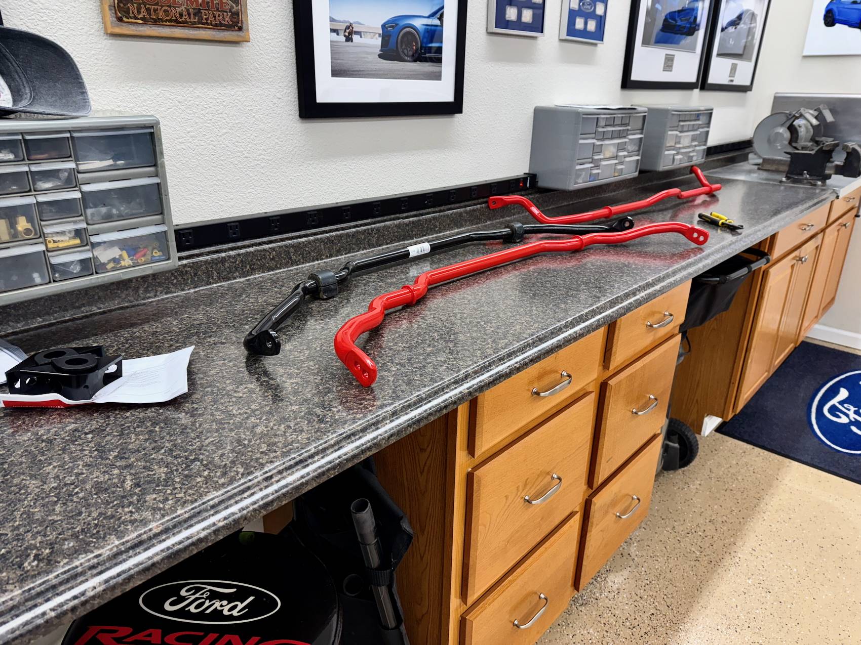

Replaced OEM sway bars with Eibach front and rear sway bars. Replaced one of the splined bolts that attach the front struts to the wheel knuckles with regular bolts for front camber adjustment. Replaced OEM strut tower bar with the 3-point Steeda bar.
MODS - WHEELS / TIRES / BRAKES

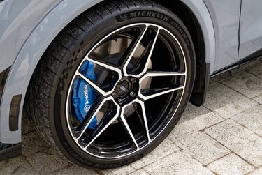

Summer wheel/tire setup: Signature Wheels SV701 gloss black with polished face 21"x9.5" ET 40, Michelin Pilot Sport EV Performance Summer tires 275/40/21.
Winter wheel/tire setup: Signature Wheels SV706 gloss black with polished face 20"x9.5" ET 34, Michelin Pilot Alpin PA4 N-SPEC Performance Winter tires 275/40/20
I use custom titanium lug nuts. 😊

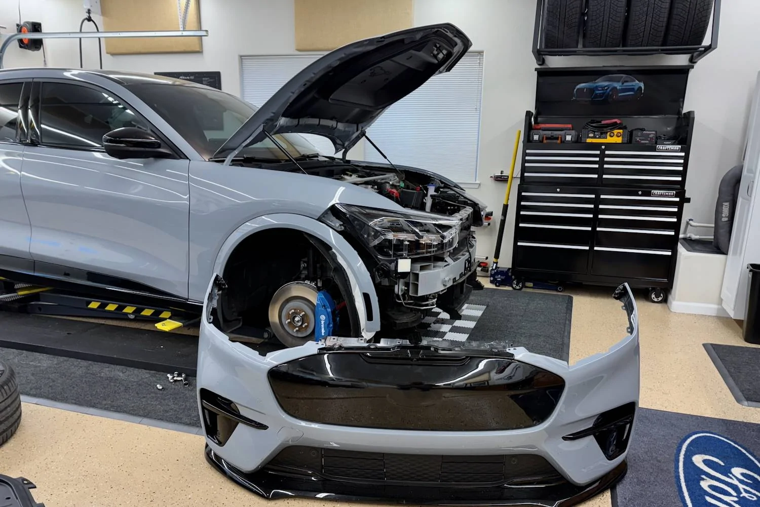

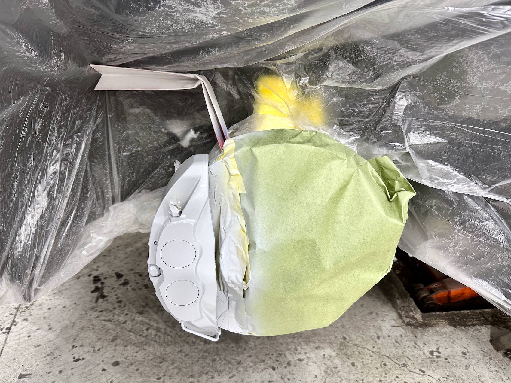

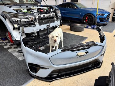

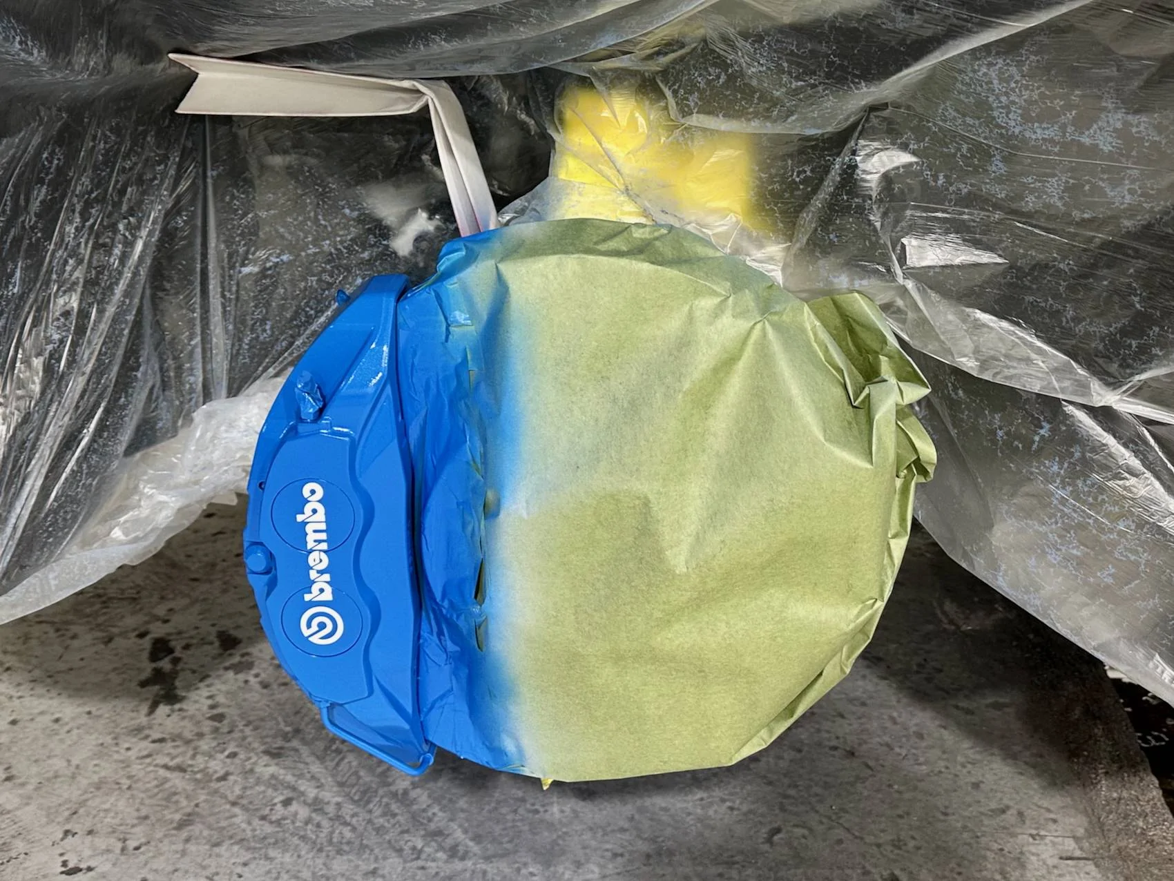

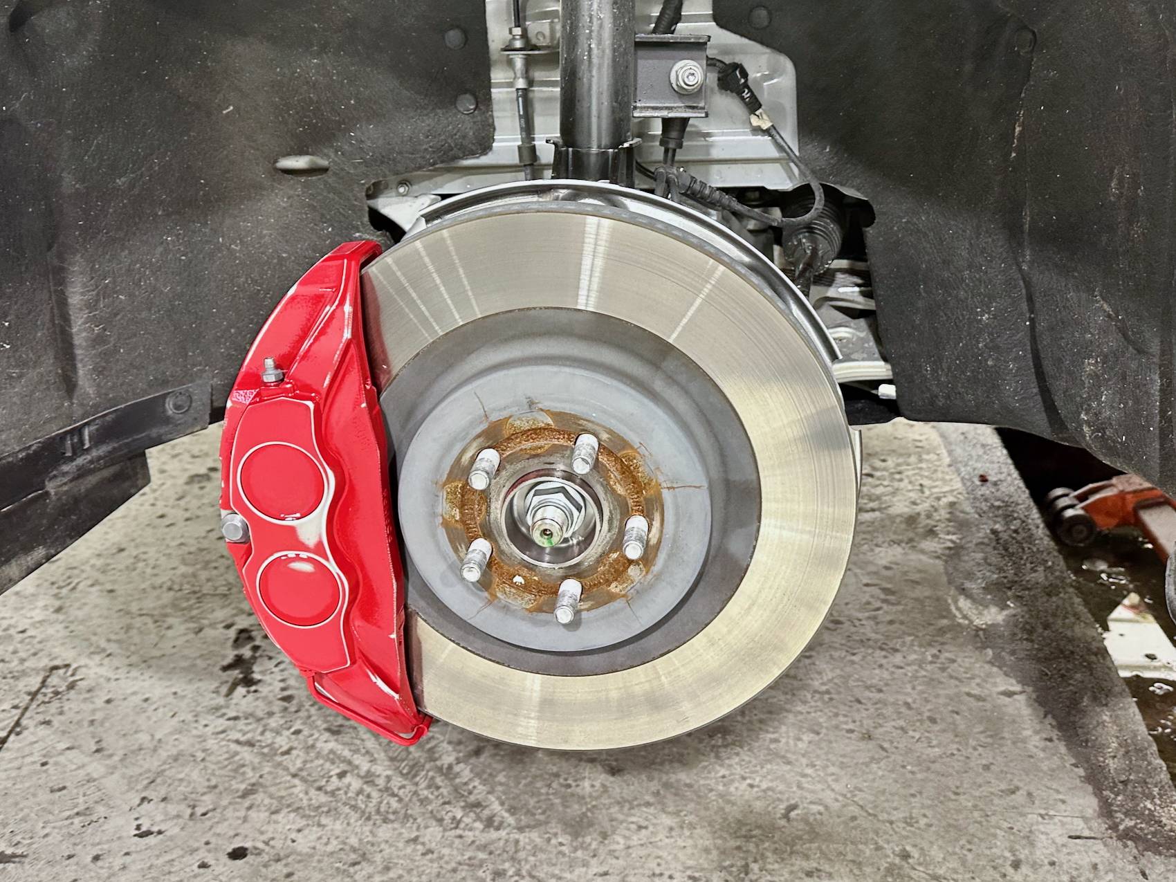

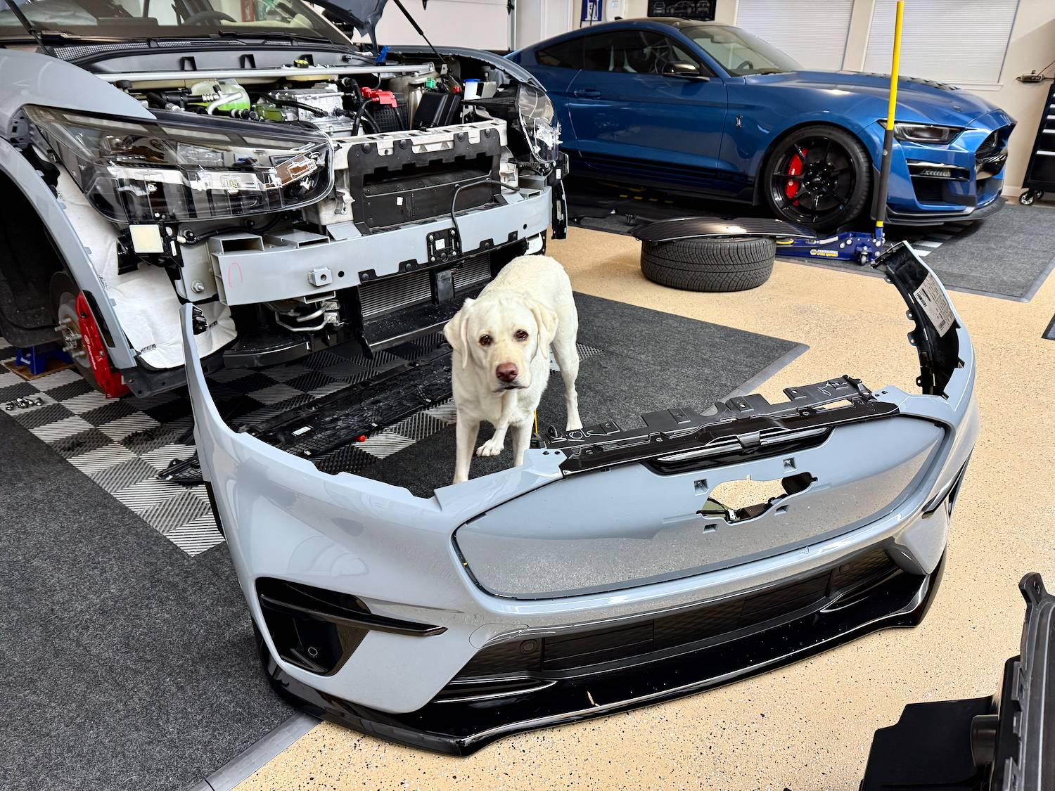

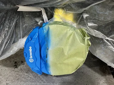

Tinted all exterior lenses (side markers, backup, third brake light, tail lights). Wrapped roof in gloss black (covered with PPF) plus a strip of gloss black between the tail lights at the top of the liftgate. Removed side Mach-E emblems on doors. Added AOSK mud flaps. Replaced rear license plate with a Reviver electronic LCD license plate. Drilled two 2" access holes (then capped them) above the LVB positive and negative connections in the frunk. Eliminated the Pedestrian Audio Alert sound and back up beeping by replacing the speaker with a resistor. All exterior paint treated with Ceramic Pro 9H ceramic coating. Ceramic Pro Crystal Clear Windshield Protection Film applied to the outside of the windshield. Replaced GT emblem on liftgate with custom painted Glacier Gray/Gloss Black Ford oval emblem. Replaced front grill with ponyless grille and used a wrap with similar GT design. Hood and front bumper covered with PPF. Had my red calipers painted Ford Grabber Blue Metallic. Removed rear window wiper. Replaced grill again with gloss black ponyless grille with custom painted Ford oval emblem.

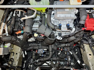

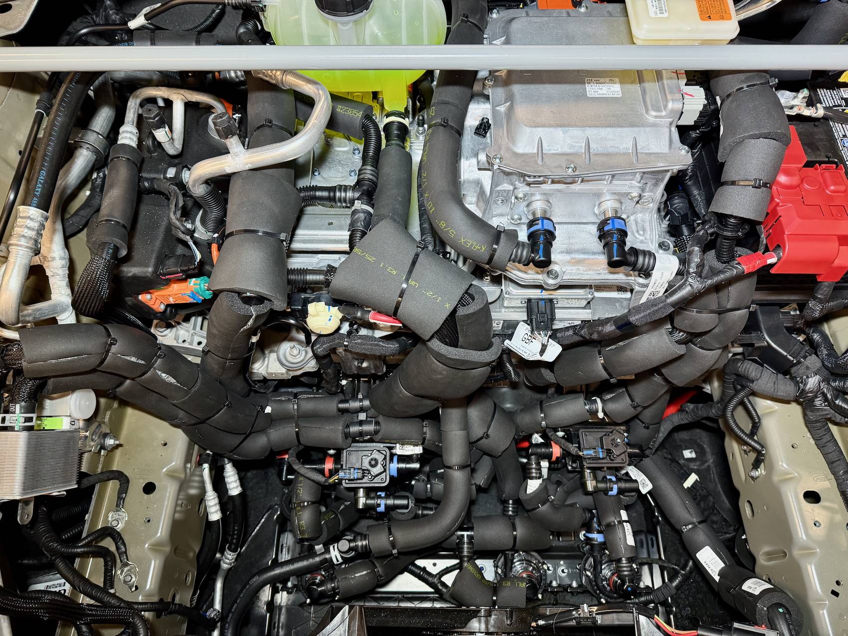

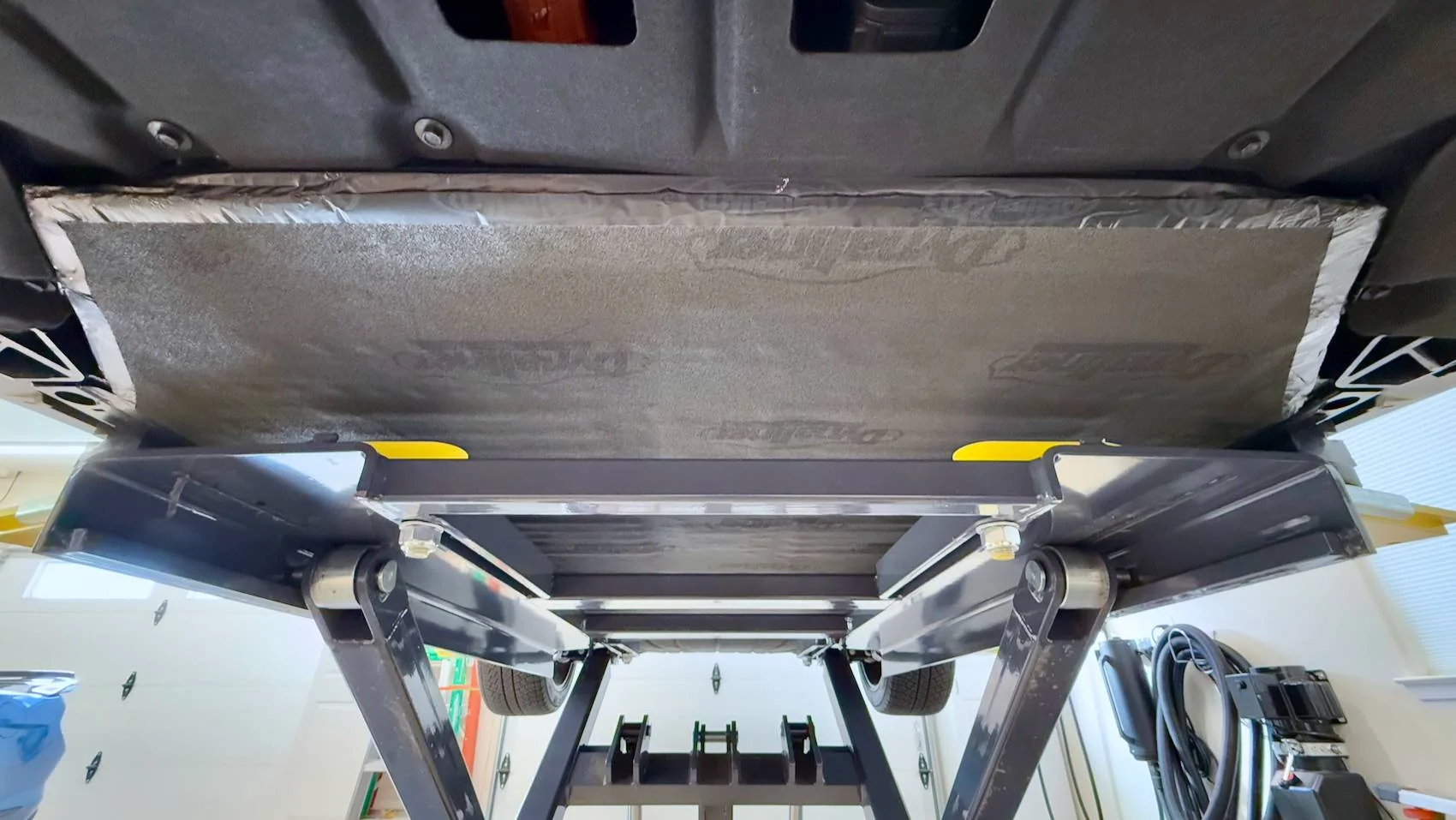

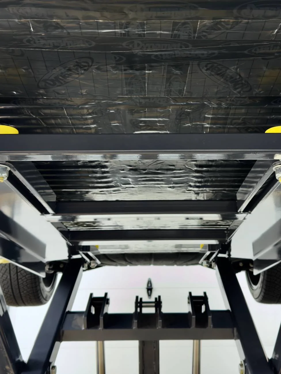

For testing purposes only, insulated bottom of battery case with Dynamat ProX and Dynaliner 1/4" closed cell foam. Insulated all battery heating/cooling hoses under frunk tub.

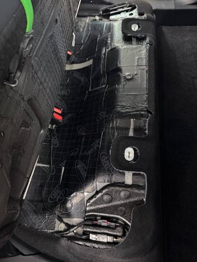

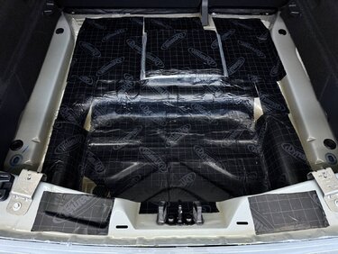

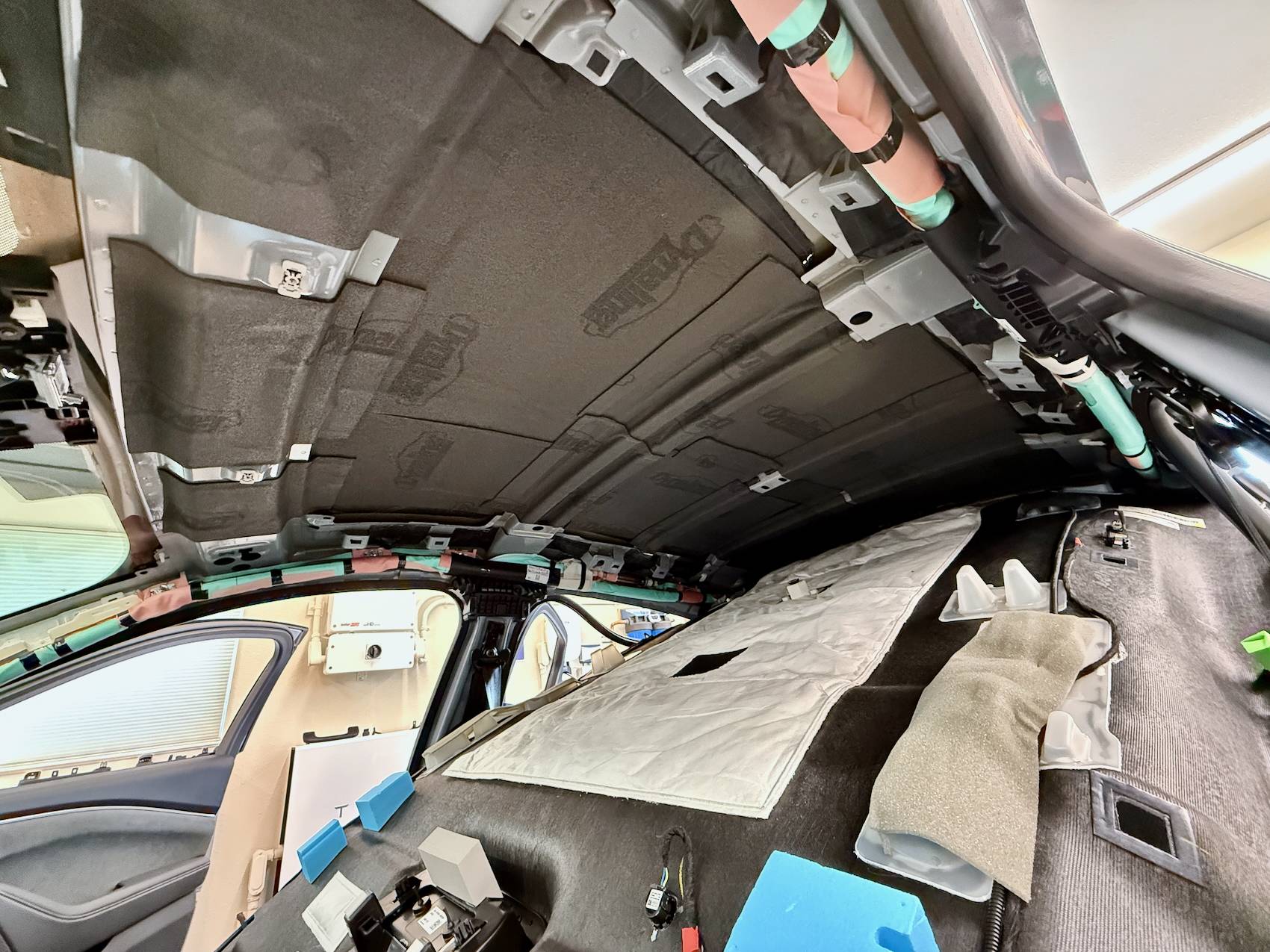

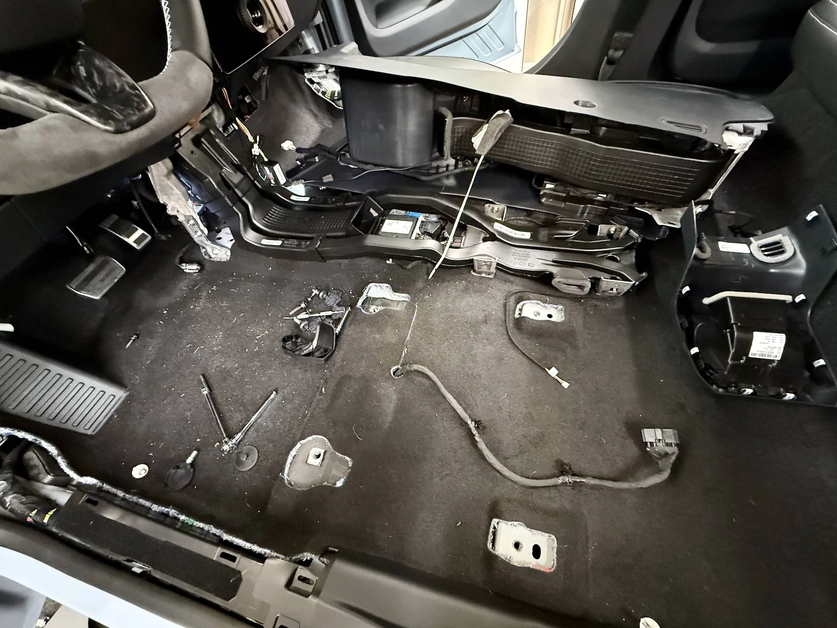

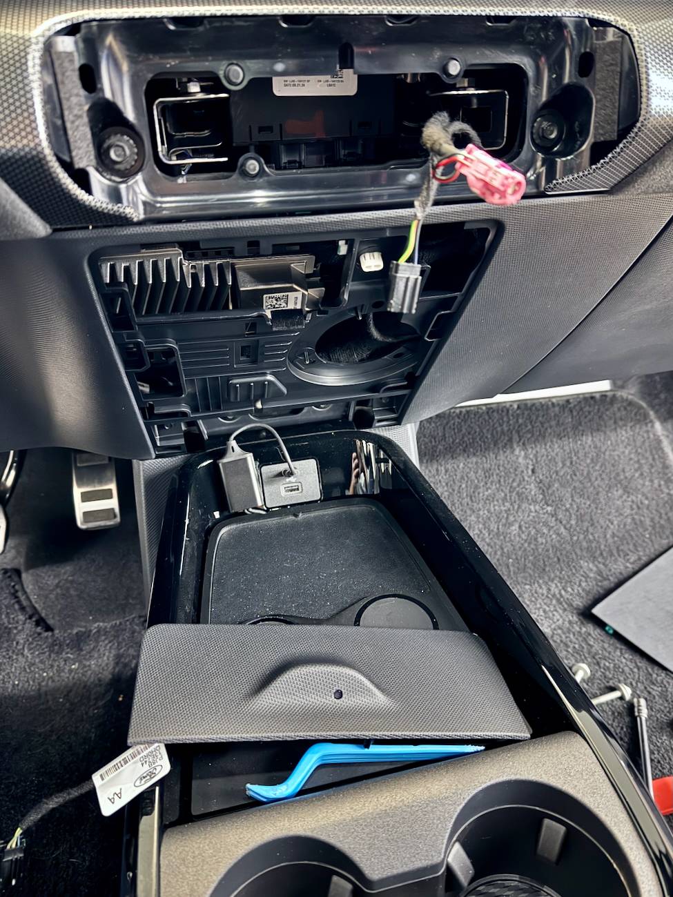

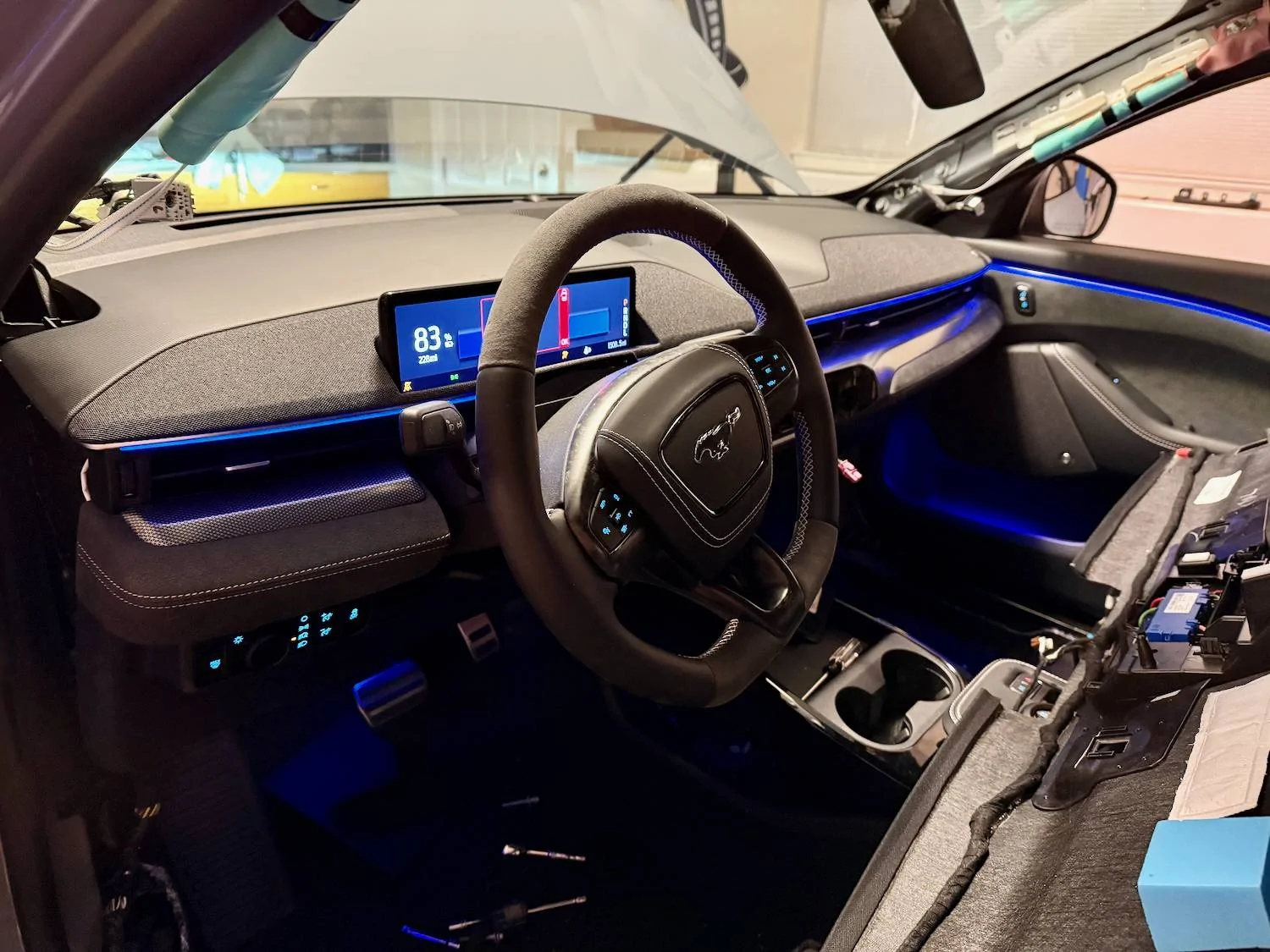

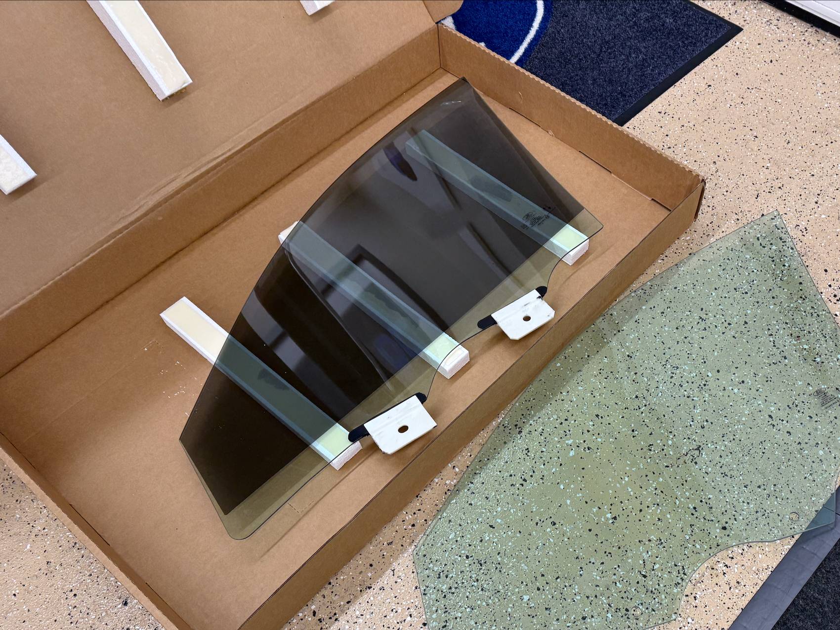

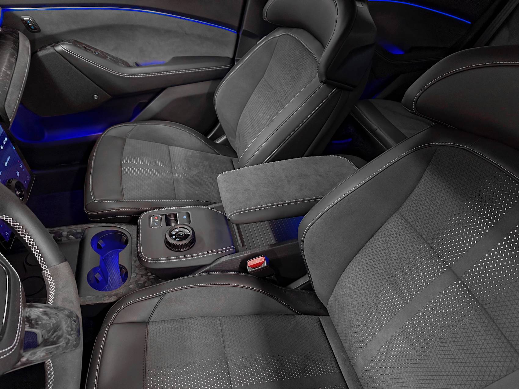

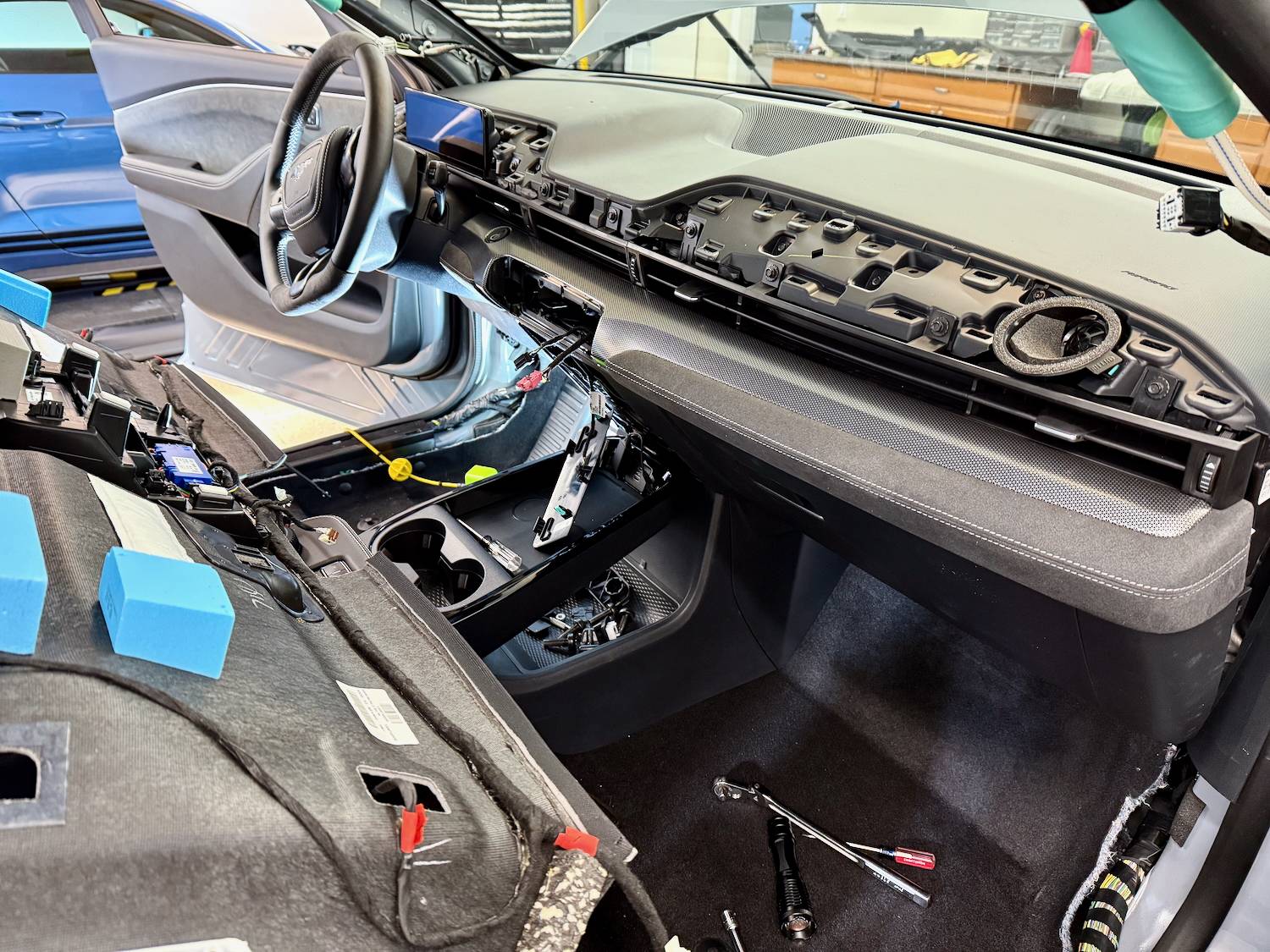

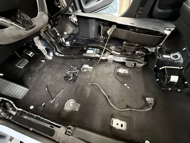

Added BSKT satin forged carbon fiber appliqués for all four door switch panels and dash trim. Replaced steering wheel with custom BSKT wheel in Alcantara and leather including leather center horn pad and satin forged carbon fiber switch trim. Replaced console armrest with custom BSKT Alcantara and leather armrest. Replaced gloss black console trim with BSKT custom satin forged carbon fiber trim. Added TWRAPS dual MagSafe charger pad. Added NAVIKS Sync motion lockout bypass device. Replaced factory mats with Lloyds Ultimat Mats. Sound deadened all four doors, liftgate, under rear seat, entire floor including cargo floor and entire roof. Replaced driver and passenger front tempered glass with laminated (acoustic) glass and ceramic tinted to 35%. Ceramic tinted windshield, rear door and liftgate glass 70%. Removed warning stickers on the sun visors. Covered the carpeted cargo quarter panels with CanvasBack protection and their fold out rear bumper protector. Covered the rear seat backs and cargo floor with AOSK's protectors. Covered brake and go pedal with AOSK's sport pedal covers. Added 5 SPURS satin black crowns on gear shift, volume and headlamp dials and their satin black button over the start/stop button. Installed EV-Vida ambient lighting. Wired the "P" (parking) switch to open/close the liftgate. Added back in the liftgate interior illuminated switch that was removed in the '24 models. Replaced non-lighted HomeLink garage door buttons with lighted ones. Replaced door sills with illuminated "Mach-E" sills.
MODS - IN-CAR ELECTRONICS

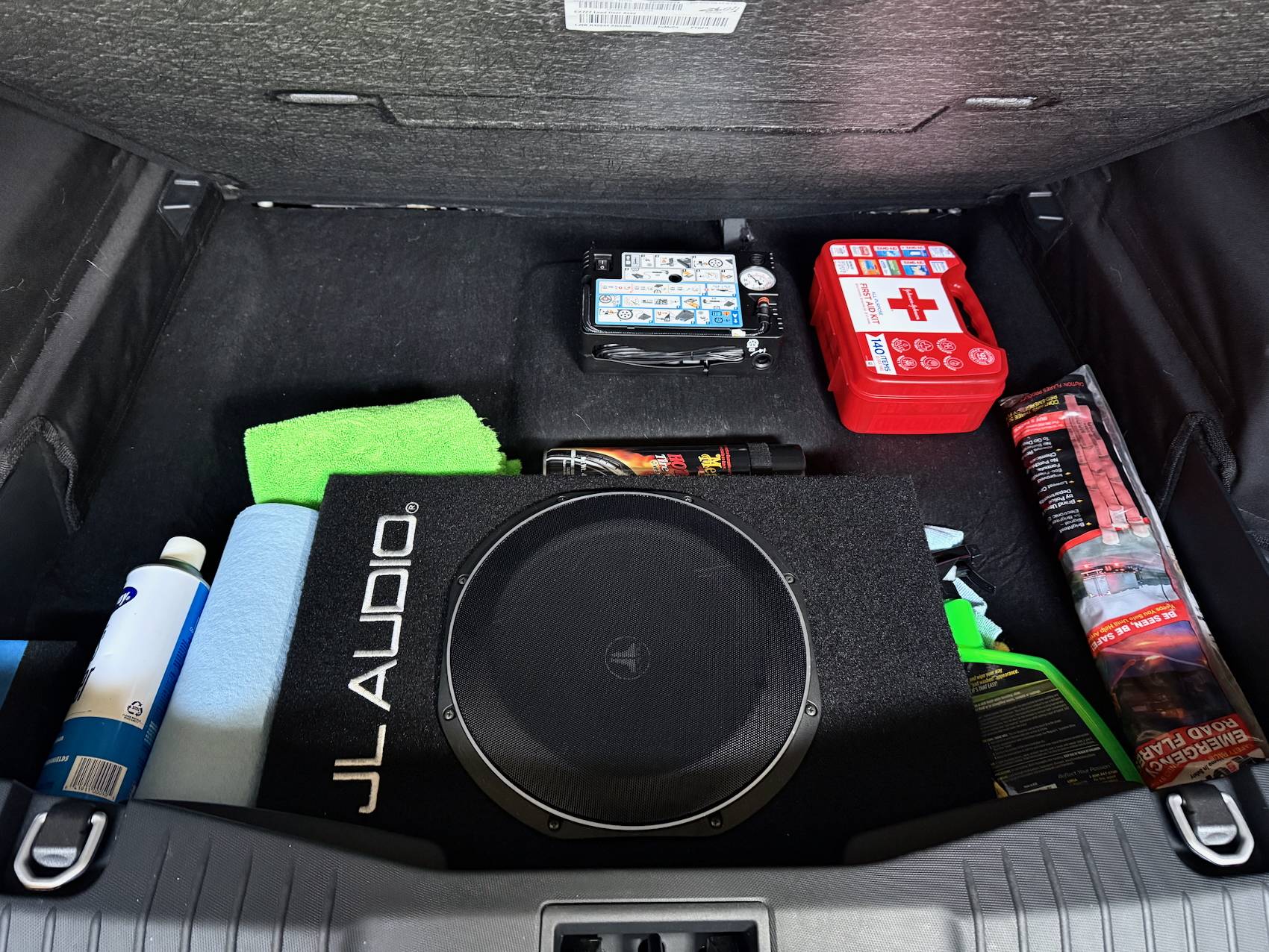

Added JL Audio 12" sub with 400W amp in lower rear cargo area. Added a remote volume control for the sub at the front of the console. Replaced 6.8uF capacitors in dash tweeters with 4.7uF capacitors.
