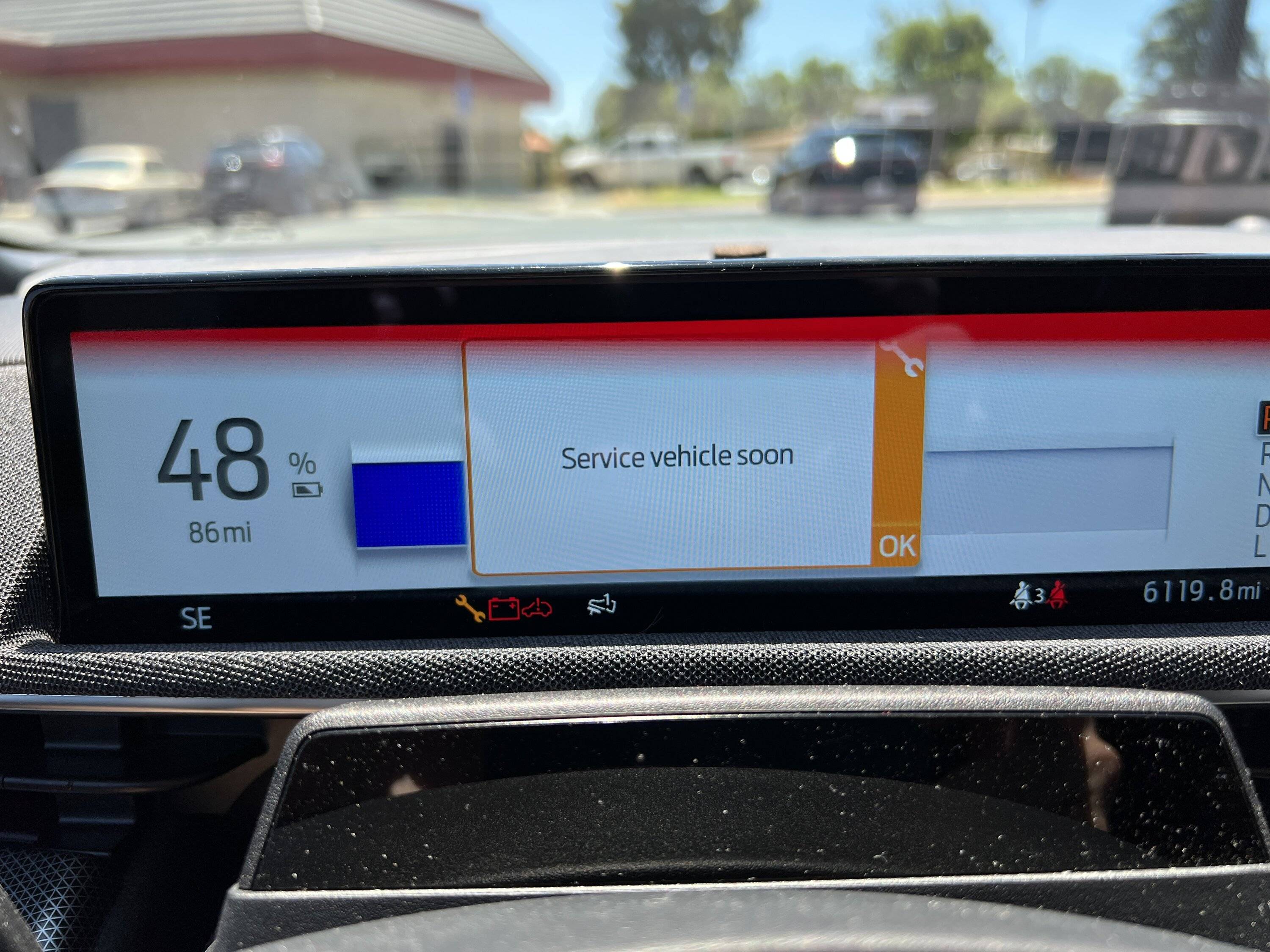

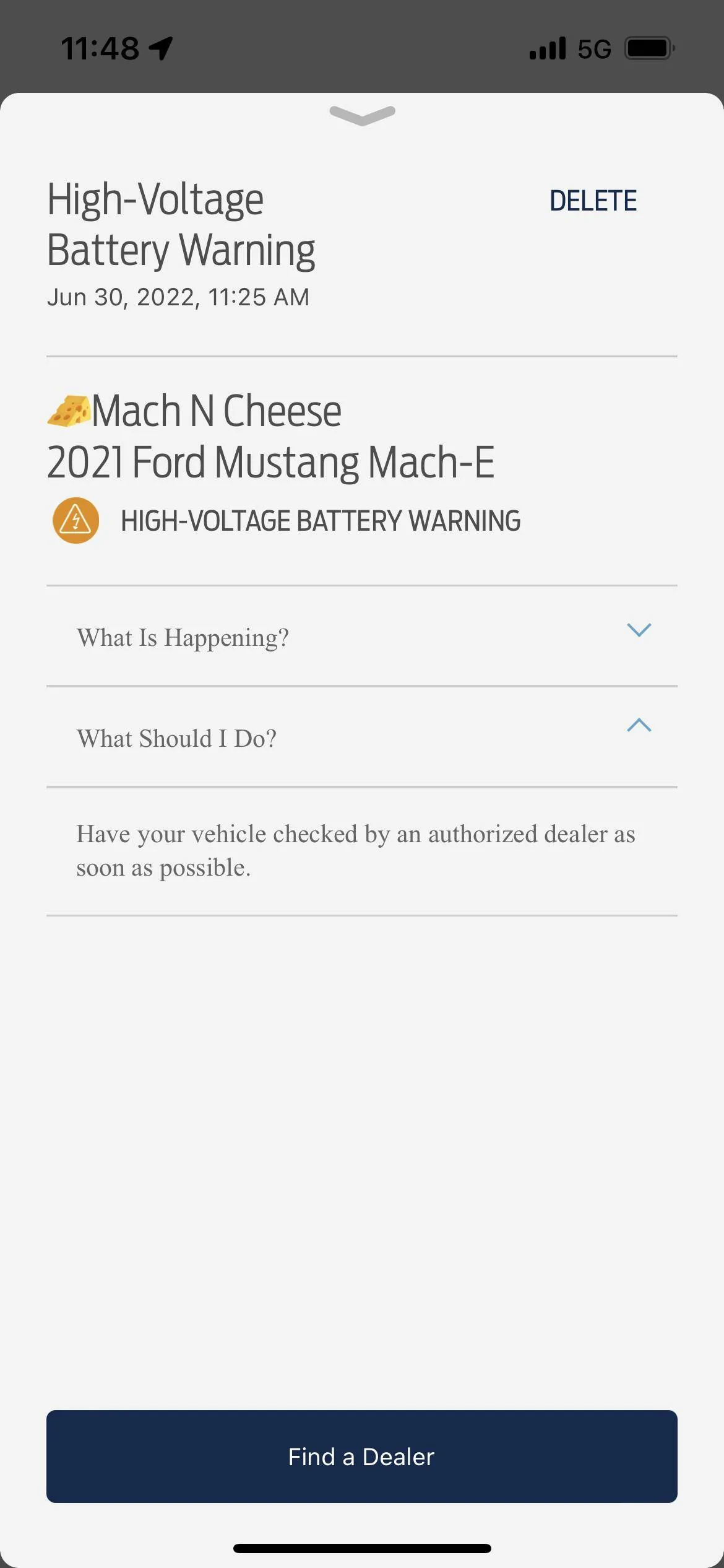

You get this message WHILE DRIVING:
No other information. But your power is then limited A LOT. Check out this power jail!

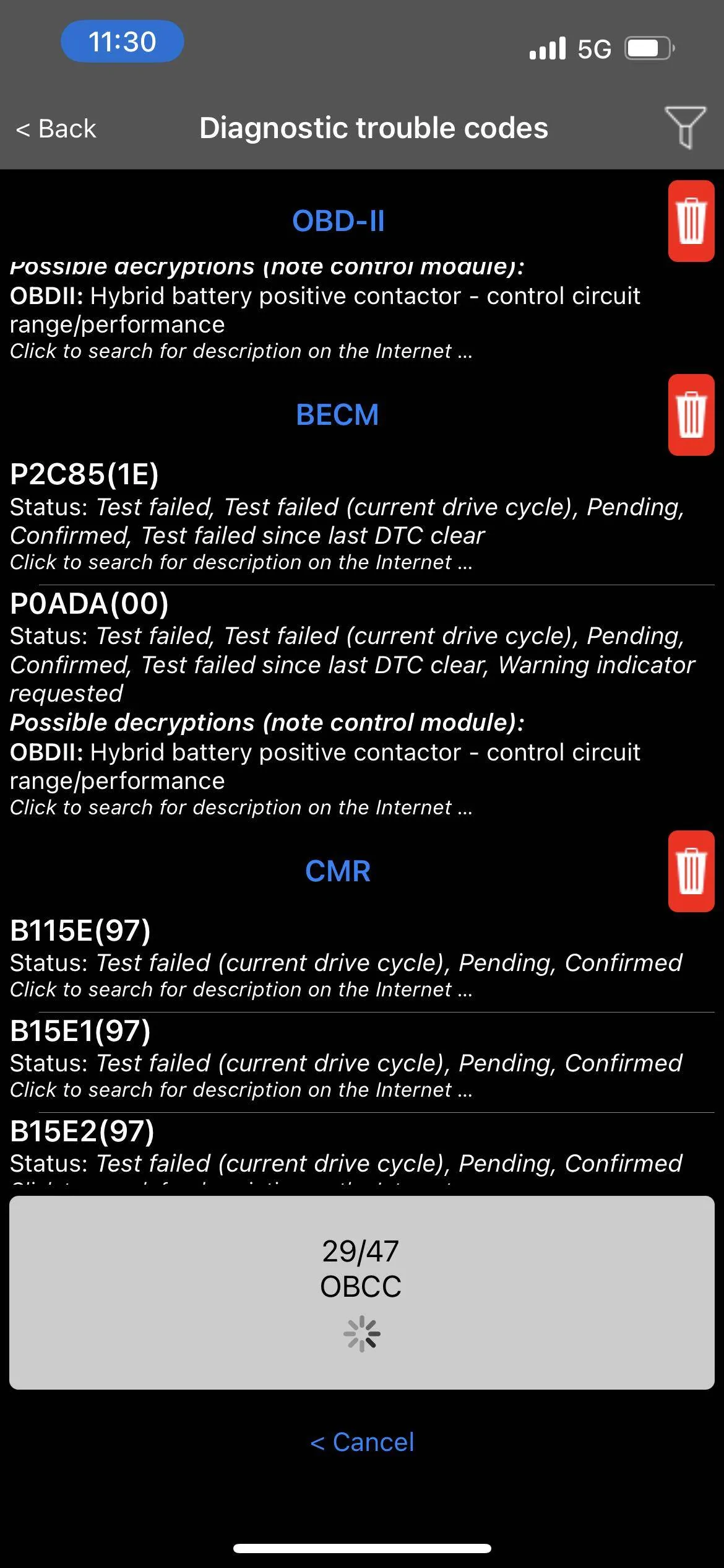

DTC codes I had:
Note you can clear these codes, and the car will pretend everything is great .... but really it is not. Don't kid yourself.

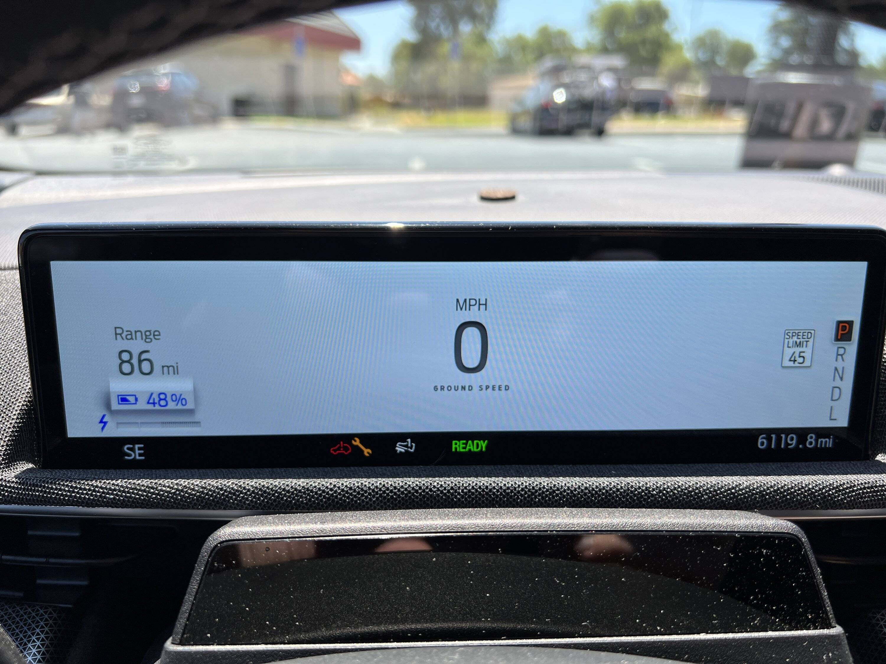

DO NOT turn off the car if you get this wrench warning, you have a danger that it wonβt turn on again and will be bricked. If you stop the car, much less turn it off, make sure you park nose-out because you very well might need a tow. Drive slowly, limiting power requested, to a dealership ASAP.

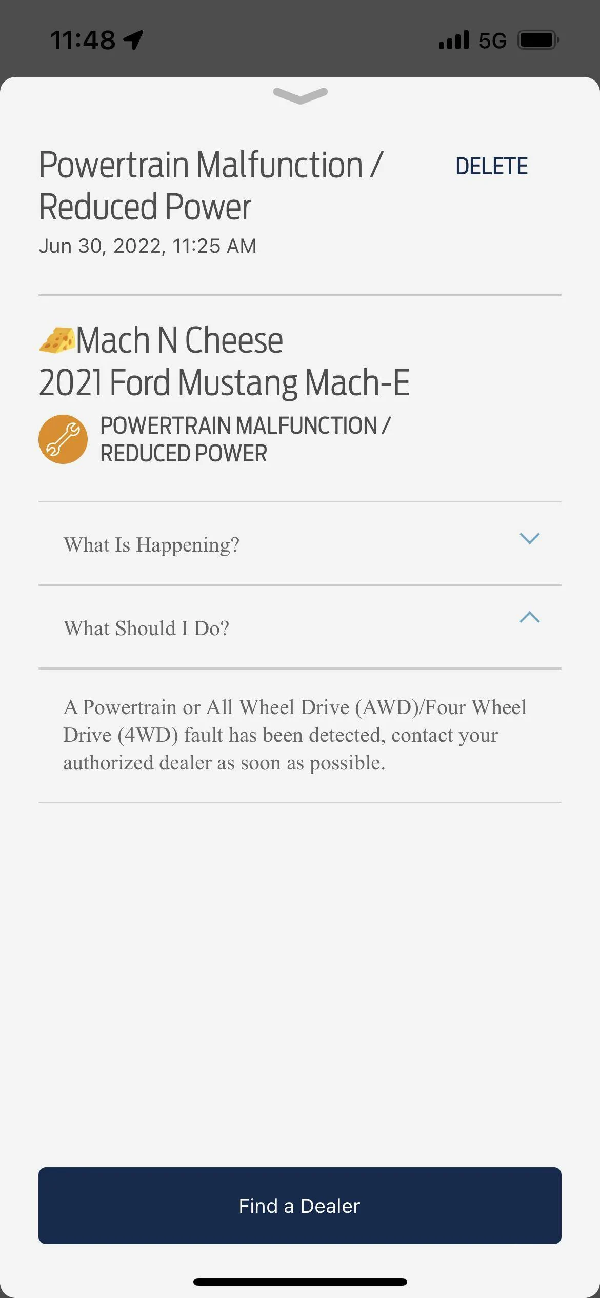

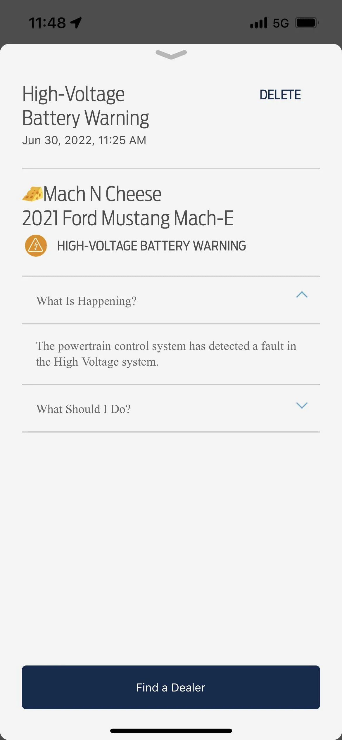

A little more from looking at FordPass.

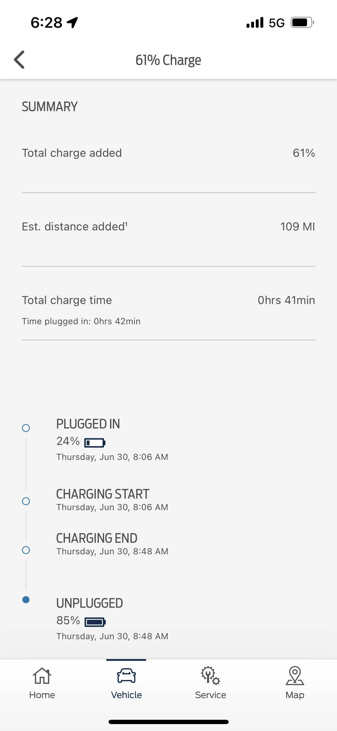

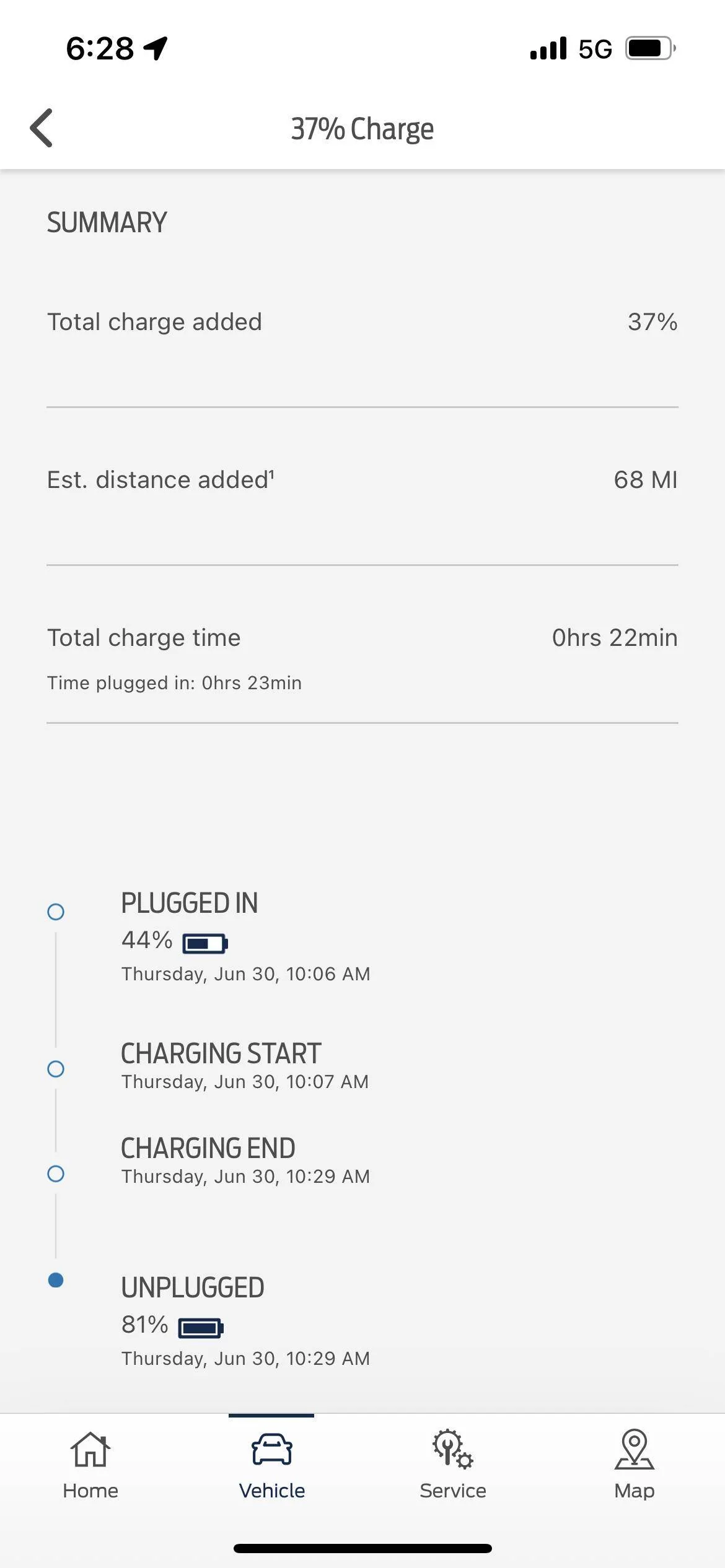

And my two DCFC sessions:
Second charge below ended actually about 45 minutes I believe before the SVS (Service Vehicle Soon) code:
Again completely normal behavior we should be expected to do with these cars.
DTC codes I had:
