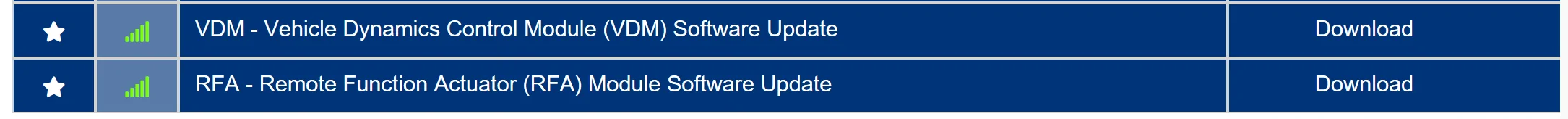

As always let me preface this by saying that the following is available via FDRS and it is NOT available from your dealer (for free) or via OTA. We assume that one day you should get them OTA, but no clue as to when.
Second, I only know for sure that these updates are available for the GTPE/Job2 line of vehicles. As this thread progresses I'll modify the title and information based on what we gather. Per @generaltso the RFA module update is also available for Job1.
RFA Module is in control of the systems that work with PaaK (I'm looking forward to see what's in store)
VDM Module update might have something to do with the random errors people are getting for the Magnaride suspension fault, but we'll know more in time.
The VDM module is only on the GTPE trim and it is not on any other trims including non-PE GTs (thanks @benk016 for clarification).
WARNING - If you decide to flash them yourself be sure to use a power supply to the LVB:
RFA -
Flashed without error
Database successfully updates and update removed
Approximate time 25 minutes
VDM -
Approximate time 3 minutes

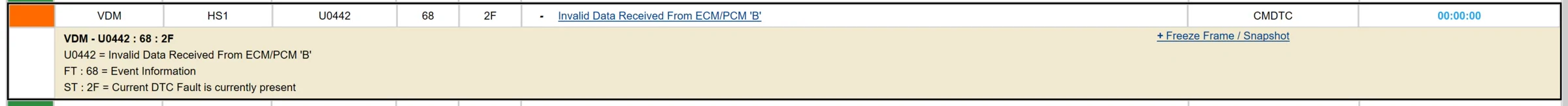

WARNING: Causes Persistent DTC (unknown consequences):
Test Drive: No alerts or abnormalities. Noted that Bluecruise failed to engage on my initial attempt. De-activation and subsequent re-activation enabled it.
RFA -
VDM -
