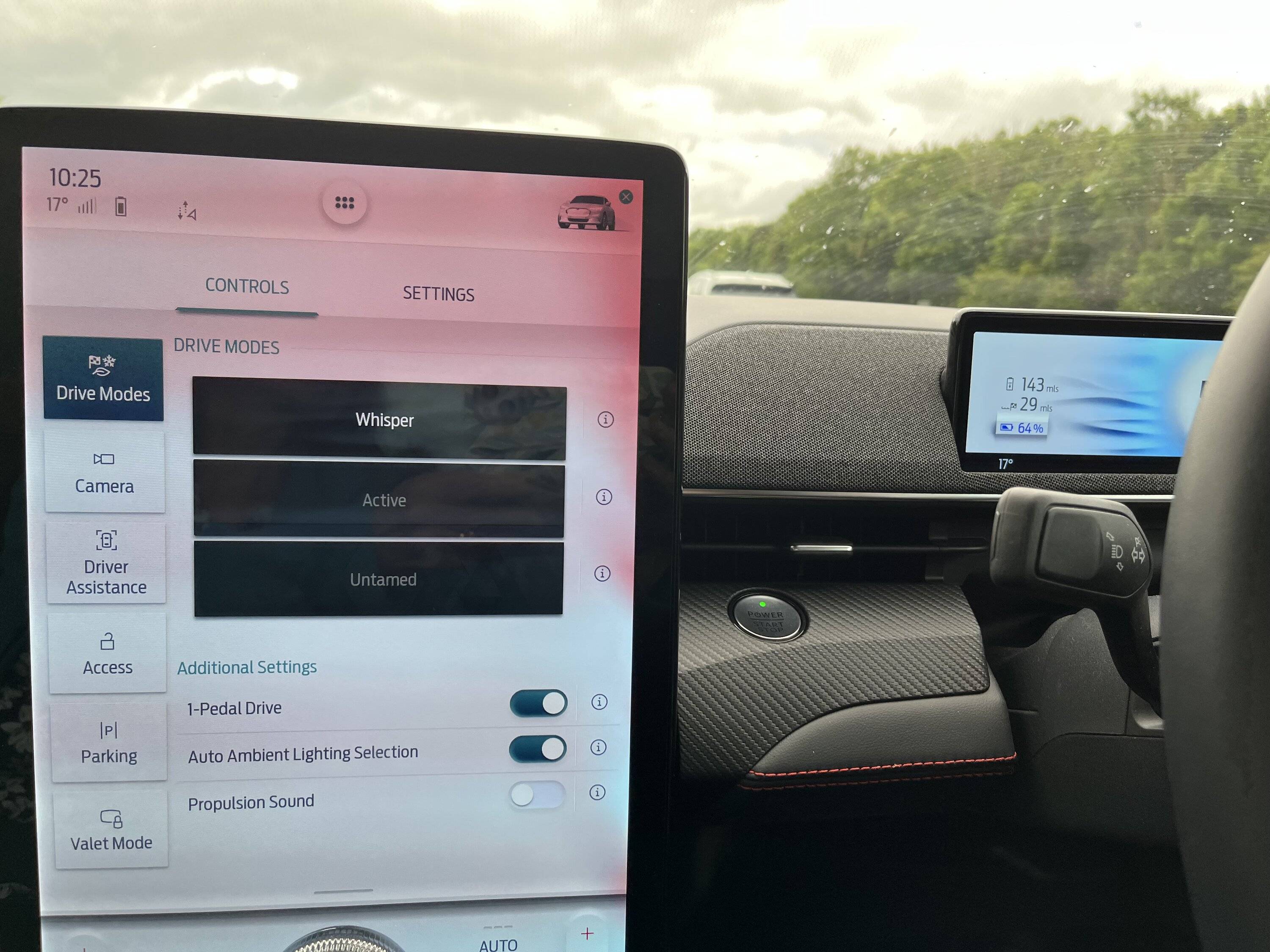

This has now happened 4 or 5 times in 3 months of owning the car, twice yesterday: driving at a steady speed of 60mph on the motorway / highway in Whisper Mode, no cruise control in use, 1-Pedal Drive turns itself off. The icon on the bottom of the IPC disappears and the driver feels the car change behaviour / feel as 1-Pedal Drive is no longer active. Checking the vehicle controls shows the setting still set to ON as seen in the attached photo. Turning that onscreen control OFF and then ON again while driving has no effect. The only way we have found to get 1-Pedal Drive back is to bring the vehicle to a halt, shift to N or P, and then 1-Pedal Drive will immediately re-engage. No error or informational message is displayed at any time.
