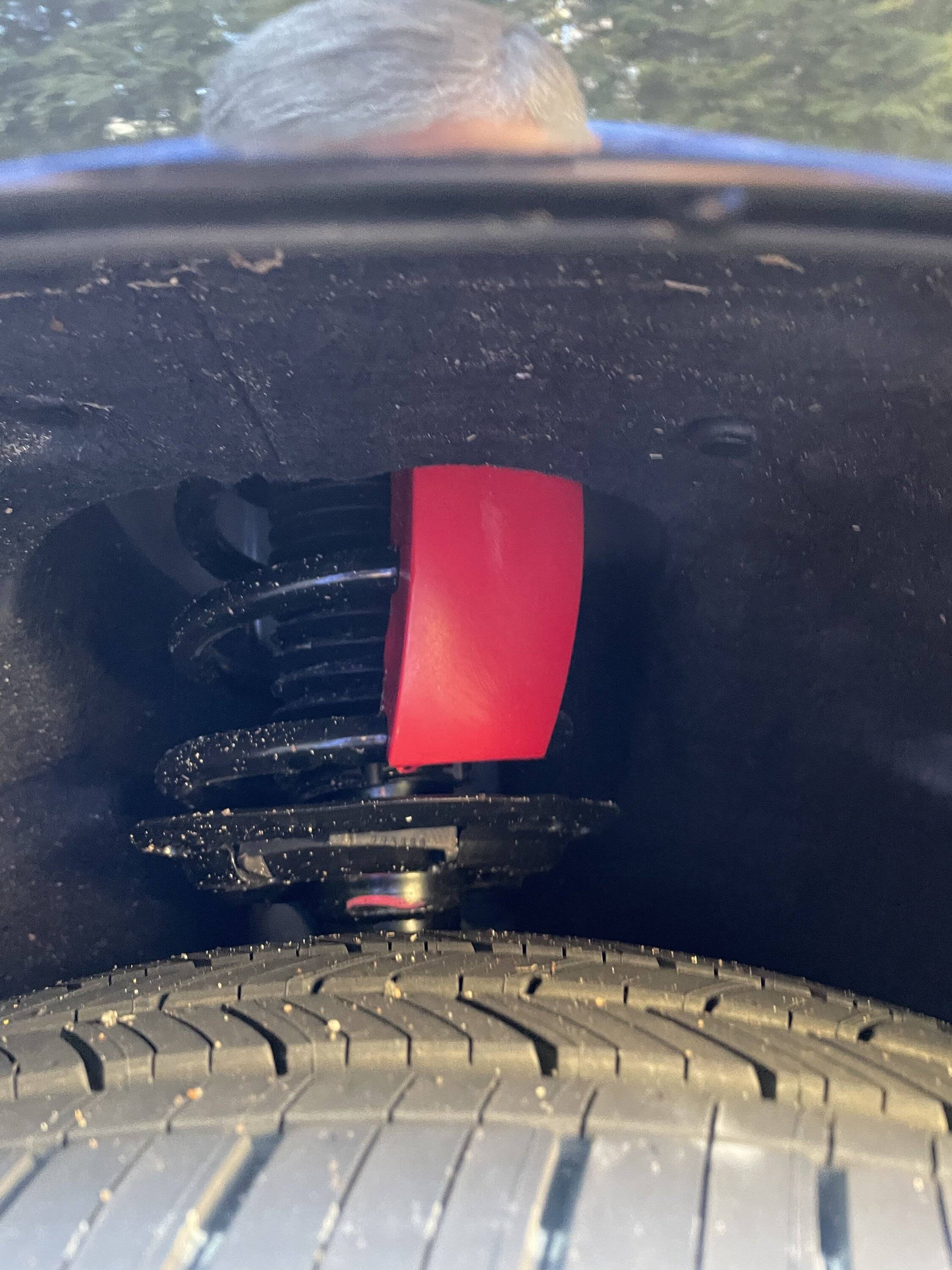

Thank you for this! If I hadn't seen this post I wouldn't have checked, but sure enough my dealer left them in. Guess it's more common than one would hope. Appreciate it!In case you hear a moaning sound from the front end, the spacers put in the springs for shipping may not have been removed during delivery preparation. They are bright red.
