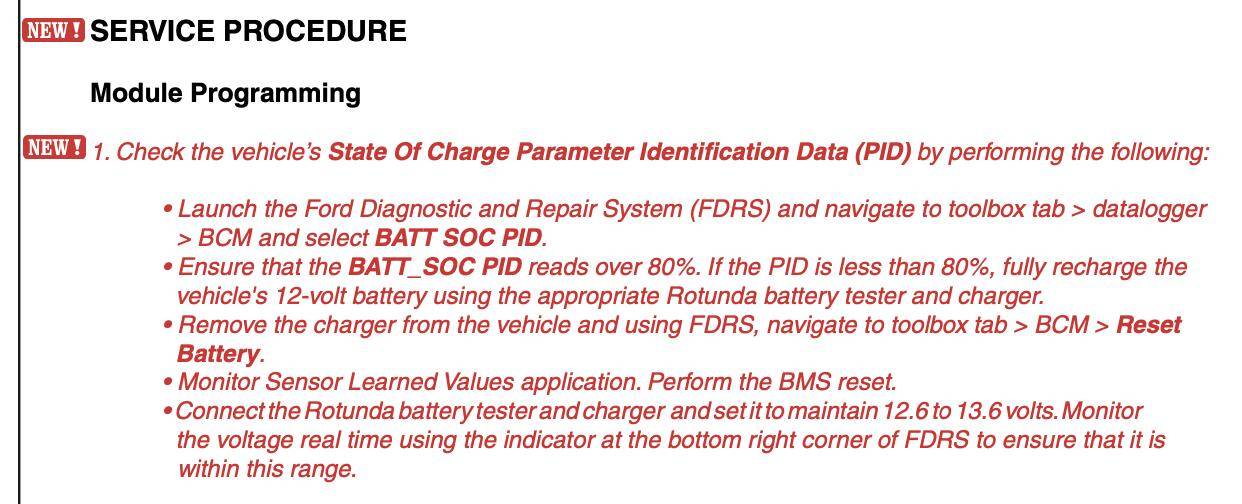

I've been getting this message for a couple of weeks now. I am trying to schedule for my dealer to take a look at it and do the glass recall, but they are backlogged and windshields are back ordered. In the meantime, I'm trying to figure this out and decide if I should leave it parked until it gets diagnosed.
Basically, the first time I start the car for the day I get a "12v Battery Fault - Service soon" message. On other starts during the day, there is no error message. I have the little voltage monitor that plugs into the 12v outlet. When I first turn the car on, it is reading 14.5v. After the car is off, it drops to 12.5 to 12.9v (I'm actually trying to remember the exact numbers, but it was in that range).
