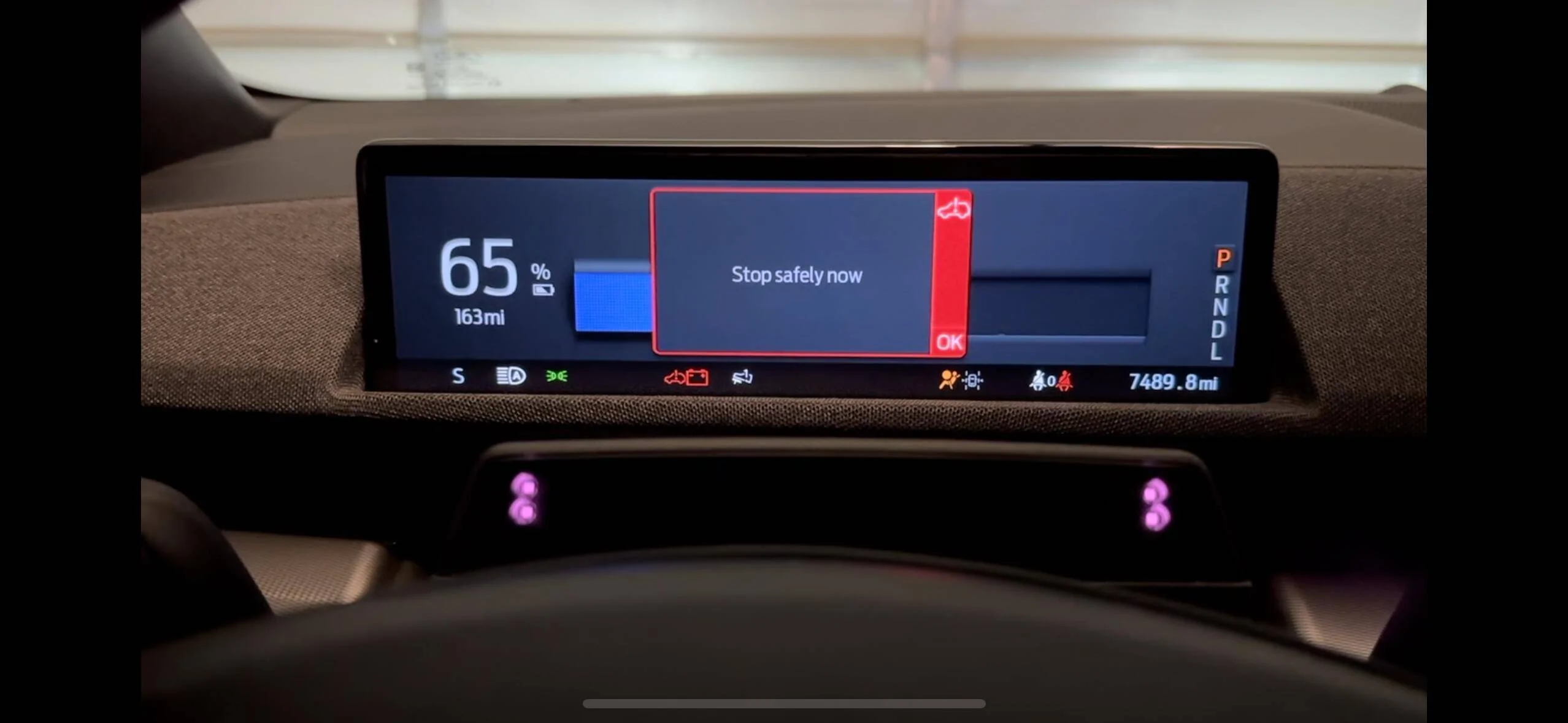

21 GT failed at 7489.8
Ford Mustang Mach-E 2021 GT/GTPE MMEs Without HVBJB Failure - Tracking List IMG_2758
The very short story version:
Bought MME 02-22-2022
MME 08-08-2022 for defective pump on front motor and repaired on 10-18-2022 with brand new front motor. 7K miles.
SSN four days later on 10-22-2022 when I parked in the garage. Plugged in the charger and got a FordPass alert for a charging error. Towed back to dealer. Took another month for the repair.
Ford offered us money to keep the car. We almost kept it but someone reasoned with us that if it happened again, we’d be kicking ourselves for not getting out of the “night-mare” when we could. It became the opposite of a dream car. We dealt with four months of frustration, most caused by a horrible dealer in (cough Metro Ford) OKC.
Manufacture Buyback on 02-21-2023. Exactly one year from purchase. Mileage 12416. Rocked to Green Day songs on the way to the buyback (frustrated to be selling it back to Ford) and American Idiot was the swan song as I pulled in.
I’ve been watching the forum since then and seeing that my “second version” HVBJB is failing for others, I’m glad I took the advice to give it back to Ford. That being said, I’m willing to buy another Mach-E but I don’t have the patience for the bad dealership warranty experience and stress I went through. I found two dealers (found in the long story, not posted.) here that I think would give me good service so I’ll probably wait for the second gen. If it wasn’t for two particular members. One asked to remain anonymous and at one point they sent me the best PM that made me laugh so hard - “I hate your dealer.”. They know who they are. 😉 I think the repairs would have taken three times longer.
