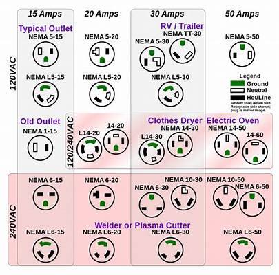

I’m dumbing this down to the number of plugs because we’re brand new to EVs, and I know almost nothing about electrical engineering. We had solar installed, including an EV plug. The receptacle is made for 3 prongs and the Mach E plug has 4. The solar company says the necessary cord is on back order… predicted delivery in March. Is there something we can buy now that will allow us to plug the car in there, or are we stuck with snail pace charging from a standard plug?
