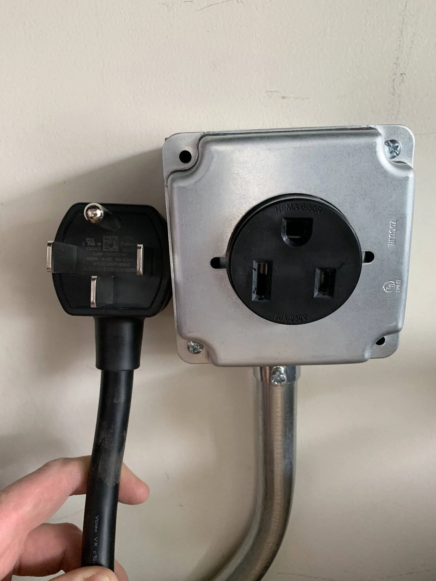

Have the solar installer verify the gauge and type of wire used in the installation. Once you know that, you will be able to discern how much current the circuit can withstand. ??It is new… an add on to our solar installation. They’re going to provide a cord that supposedly acts as an adapter, but it’s on back order, current ETA is March. I’m hoping to find something much sooner.
Yep. Get the electrician back and hopefully swap for free. Or about $15 at Home Depot if you want to DIY, but make sure there is a GROUND wire in that box...That looks like new work, ask your electrician back to change the outlet.
If you look at the plug between the blades, you will see the writing NMEA 14-50 40A 250V~. The electrician needs to install a NMEA 14-50 outlet in place of the NMEA 6-50 that is there now.
Ground wire in the box, but not necessarily run back to the panel. Using EMT (shown in his picture) as the EGC is code-compliant.Yep. Get the electrician back and hopefully swap for free. Or about $15 at Home Depot if you want to DIY, but make sure there is a GROUND wire in that box...
everything needed for a proper outlet/breaker installation to use the included Ford mobile charger with your MME is available online. The Solar company telling you materials are backordered until March is a terrible excuse for not completing the work.I’m dumbing this down to the number of plugs because we’re brand new to EVs, and I know almost nothing about electrical engineering. We had solar installed, including an EV plug. The receptacle is made for 3 prongs and the Mach E plug has 4. The solar company says the necessary cord is on back order… predicted delivery in March. Is there something we can buy now that will allow us to plug the car in there, or are we stuck with snail pace charging from a standard plug?
there should be a 50amp dual pole breaker for this circuit, L1,L2,N wires should be 6AWG, ground may be 8awg.... and the receptacle has to be a NEMA 14-50 to match your MME 240v 'tail'....It says 50A on the receptacle. is it possible that it’s not?
Had the same issue back in the summer as the outlet was installed prior to getting the car. I simply went down to Home Depot and bought the correct receptacle, shut off the breaker and replaced the receptacle. I did do my homework online/youtube about correct way to wire it. Take pics/ vids of the original receptacle's wiring as your removing for reference. If uncomfortable get an electrician!!!This is what I’m working with
This with 6 gauge wire is exactly what is recomended, with a 60 amp gfi breaker.only if the electrician ran a neutral. in this application it would work, but is dangerous.
A 60A breaker in conjunction with a 50A receptacle is not code-compliant.This with 6 gauge wire is exactly what is recomended, with a 60 amp gfi breaker.
It looks like 3/4” to me. Hard to tell for certain in a picture.Is that 1/2” conduit? If so, there is no way there are 3x#6 wires and a #8 ground in there. Best case there is 2 #6 and a #8 which is not code as well, so my eyes must be off and it’s 3/4” at which case, very tight squeeze with 2 hot, neutral and ground regardless of what the tables say.
OP- are you sure that is a 50amp circuit in the panel?? Please check that and let us know, regardless of what the plug receptacle says.
