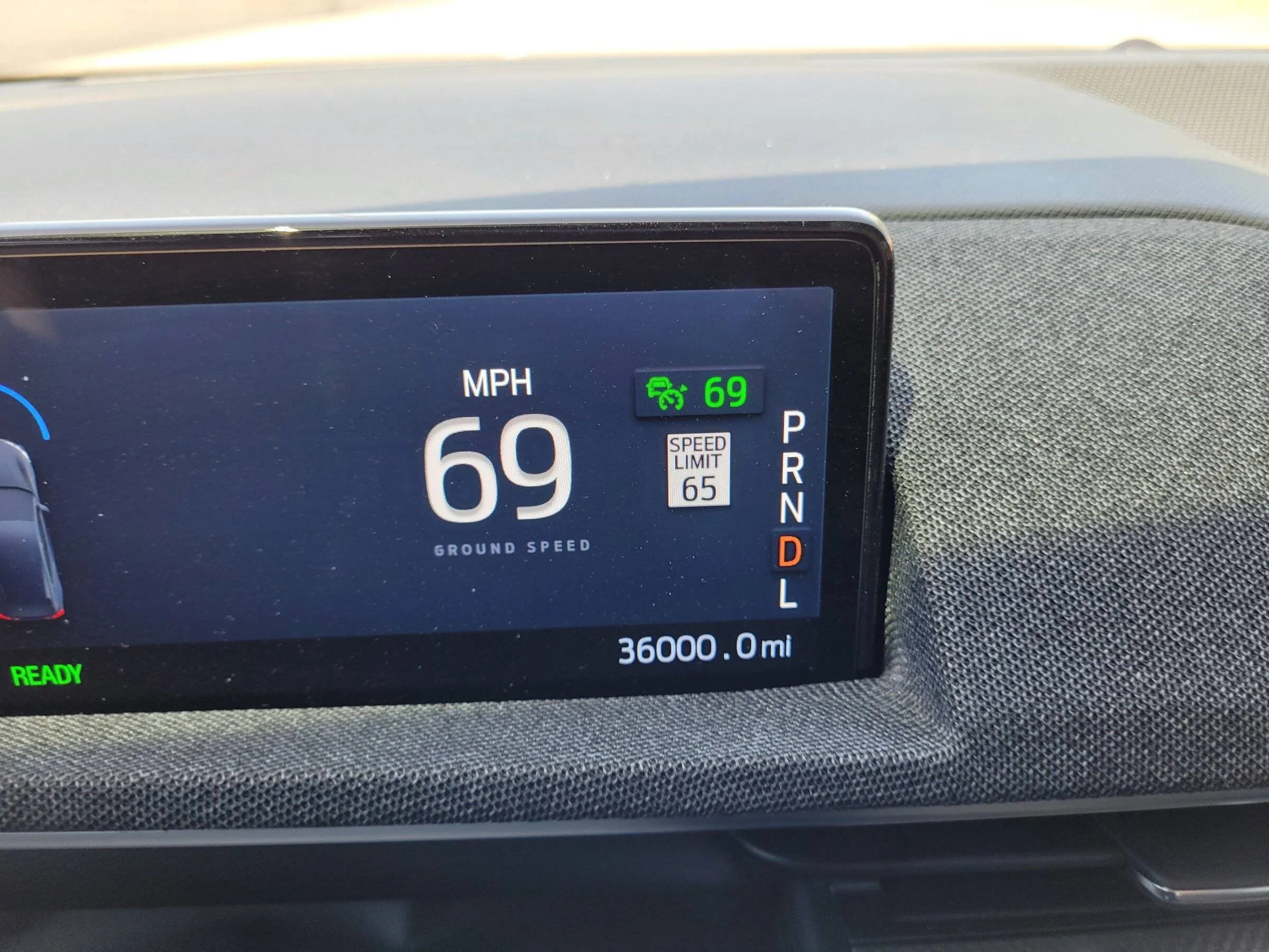

This car gets a split score from me due to extenuating circumstances. 82 points for the first 35,000 miles and 56 points for the last 1,000 miles unfortunately. If given the choice and I could go back in time to Feb 2021, then I would definitely purchase the car again. But if I had to make that same decision today, I would look for some other car instead.
So now that I've had some time behind the wheel, there are some really great things about this car that I appreciate.

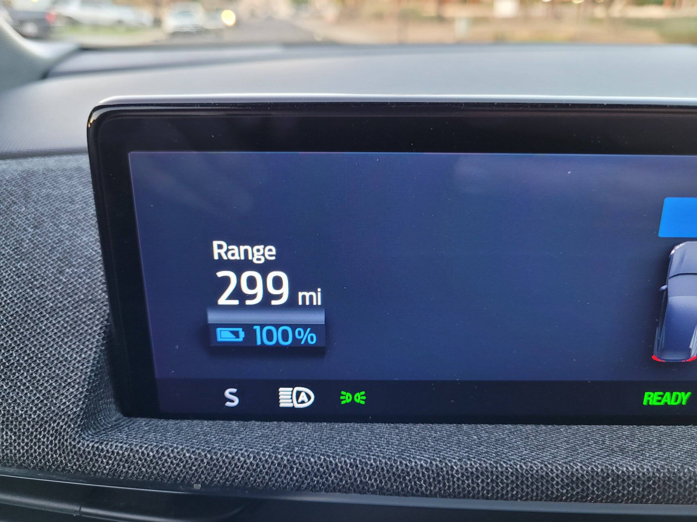

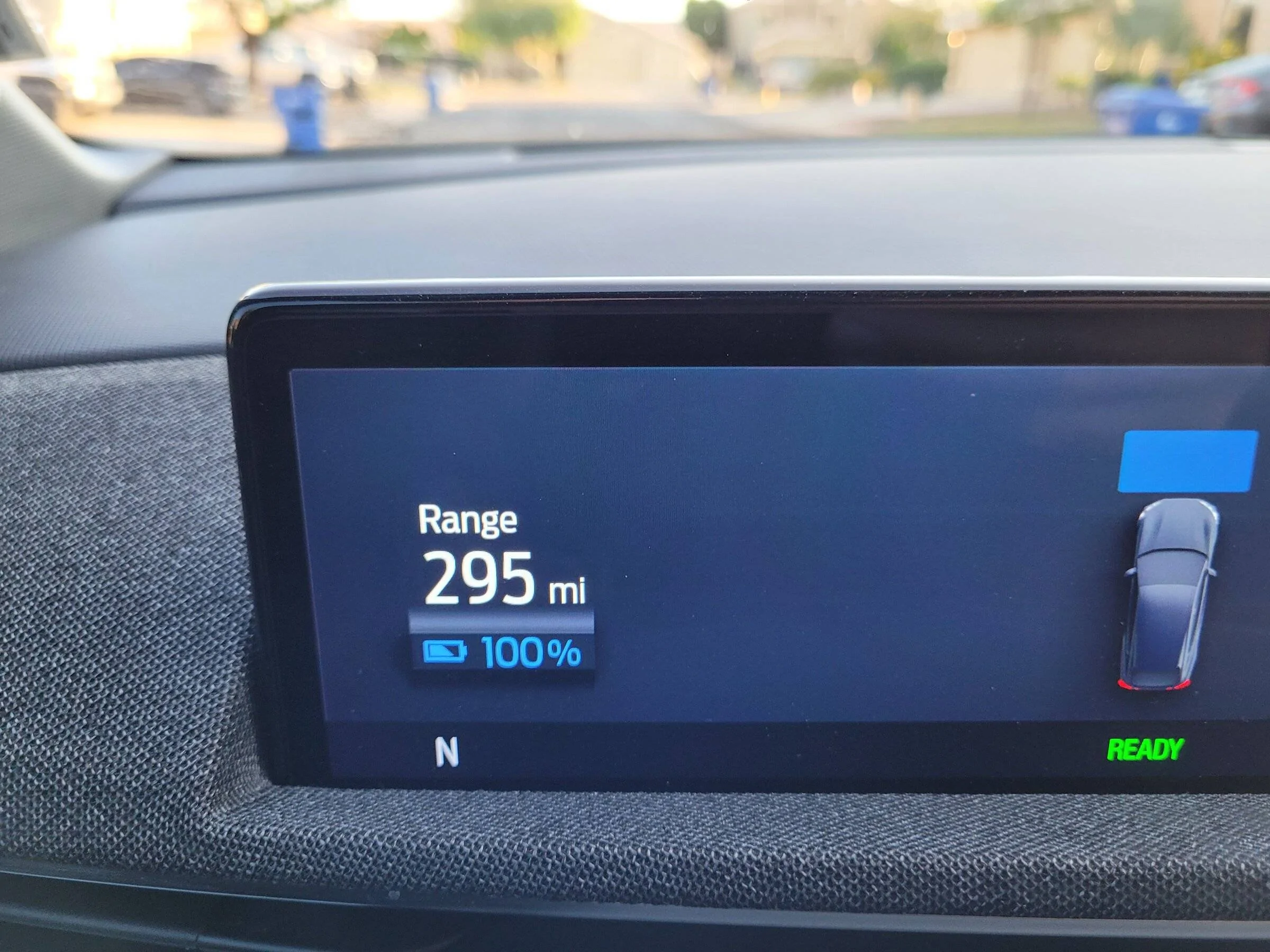

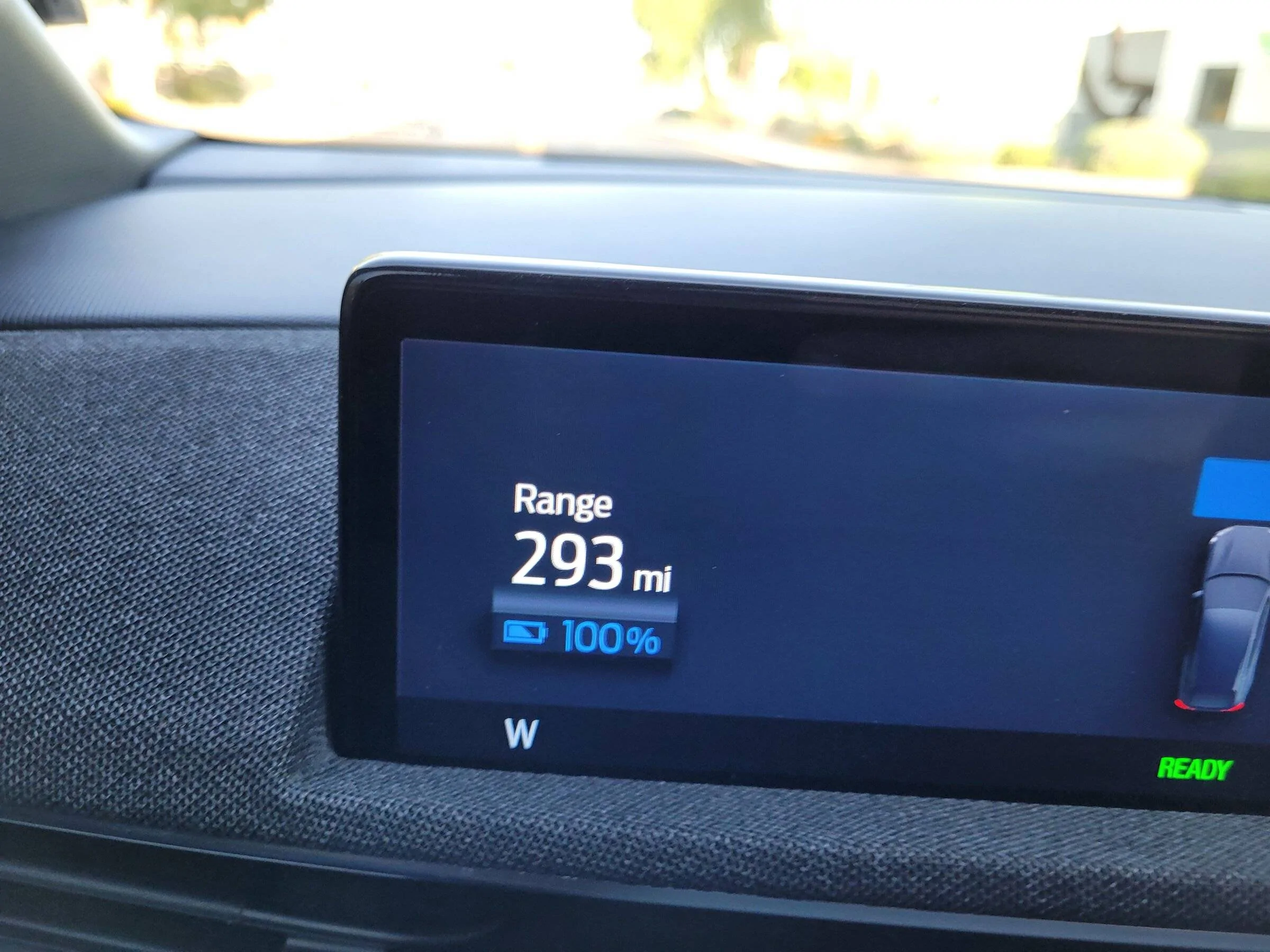

Have you noticed any battery degradation in 36k ?
No observable deg yet. I charge to 100% displayed because I can't trust the charge schedule to work. So if it forgets to charge overnight, I can still usually have enough charge to get to work and charge there.
Last three days shown attached. My estimated range will decrease slightly as summer approaches because I use my A/C more often.
