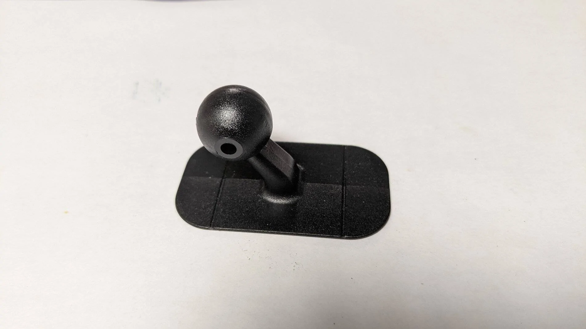

I decided to create one but wanted it to use the Natomount magnet. This is what their base looks like without the washer and magnet:

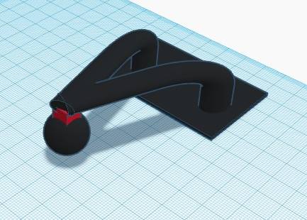

I wanted to invest as little as possible so I used an online CAD app called TinkerCAD. It took a few days to figure out but I eventually came up with a Triangular design that:

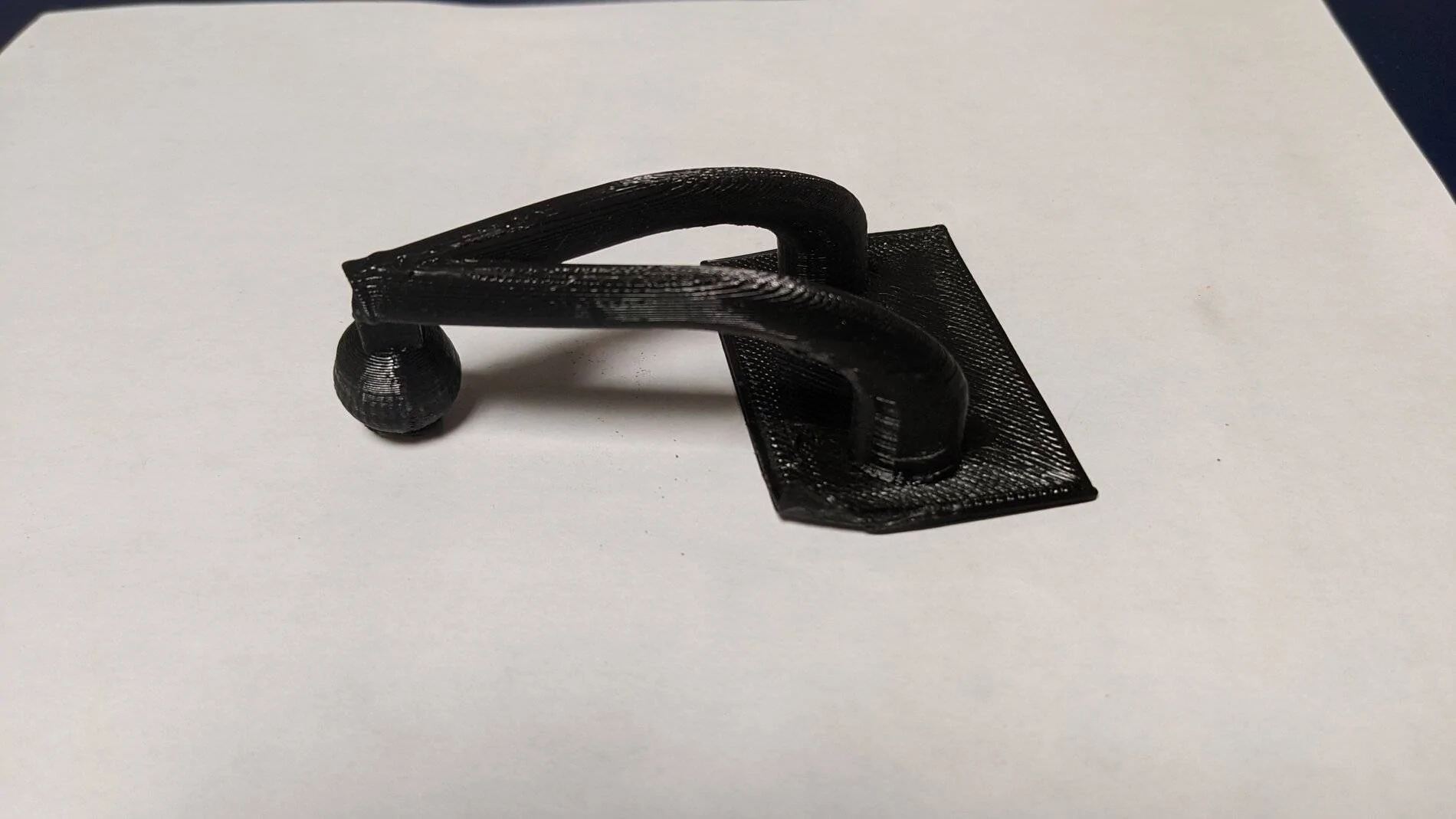

This is the 3-D printed version:
The final product was printed first in PLA plastic. This melted into a blob on the first sweltering day. My subsequent designs were then printed with ABS plastic and seem to withstand the heat very well.
The wide base is taped to the back of the display using 3M Permanent Double Sided Extremely Strong Mounting tape just like the Natomount devices do. This can be obtained at HD or Lowes. You will have to purchase a Natomount to get their magnet and screw attachment. A thin piece of metal sticks to the inside of your phone case. Be aware, on many phones the metal sticker will prevent wireless charging (not a concern for me).

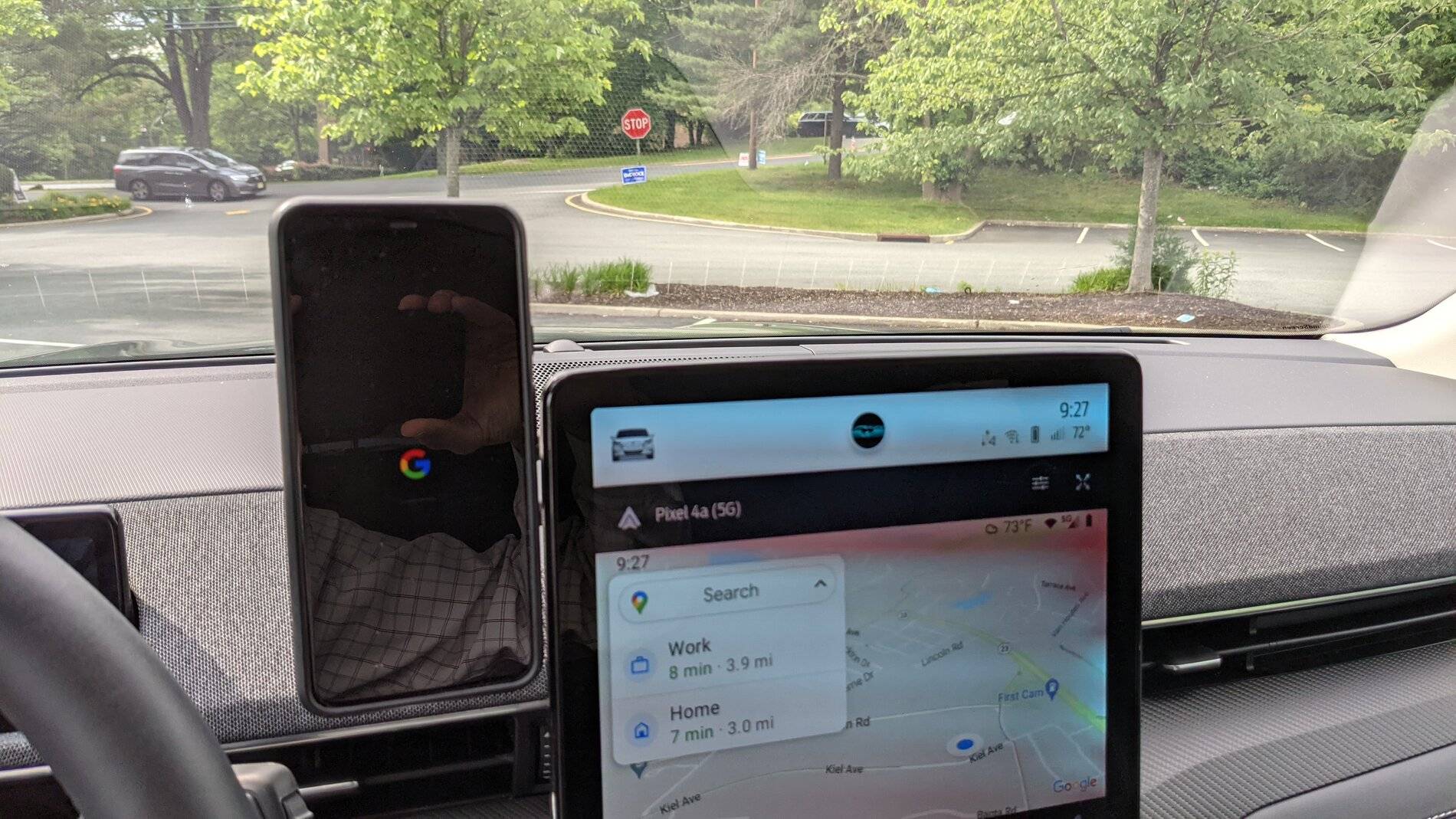

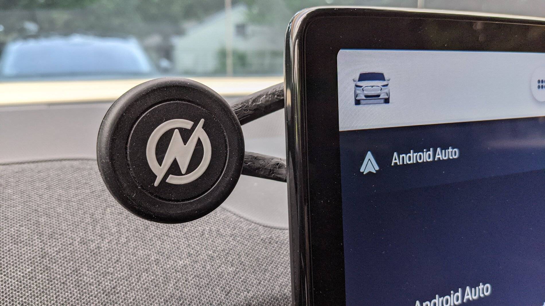

The final result:
- Had the same size ball as the Natomount so the magnet would connect, and
- Supported the weight of my monster phone.
The final result:
