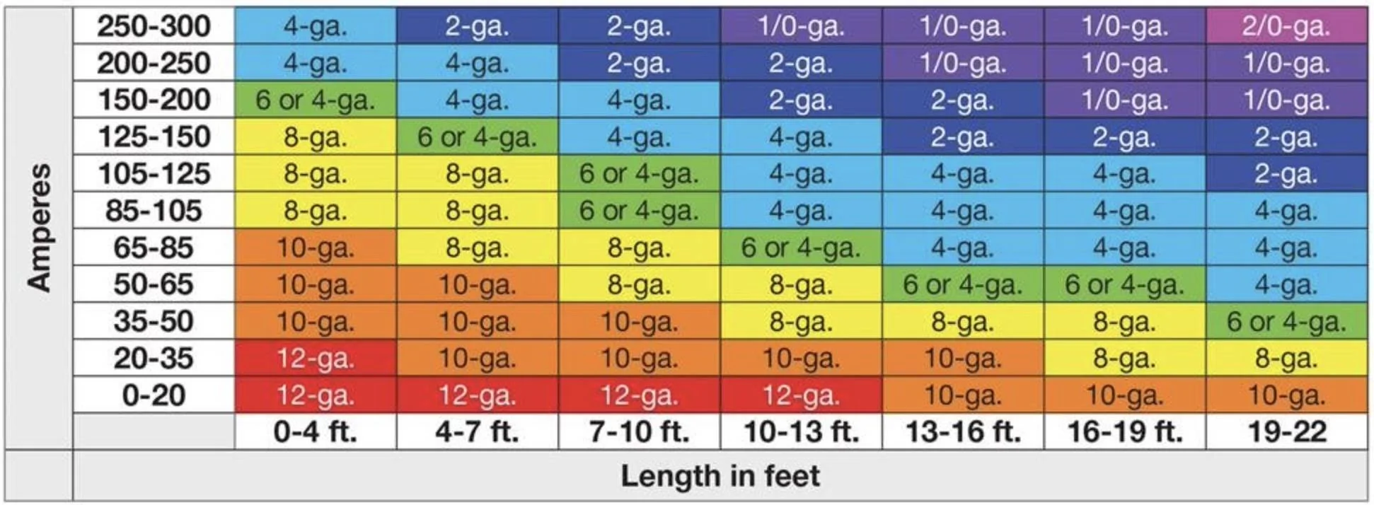

JL Audio recommends 8 gauge wire for this particular 400 watt RMS amp which has a 30 amp fuse. At that amperage, if you run a power line less than 16 feet, you can get away with a 10 gauge wire. My power wire length was around 15 feet but I still went with the recommended 8 gauge.
