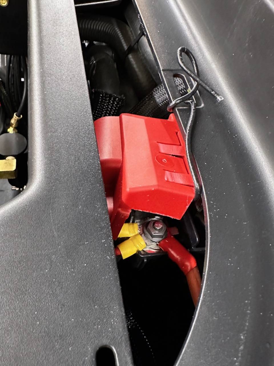

@markboris - do you happen to know what the lug size is on the terminal where you attached the power wire up front? I need to grab some more ring terminals and want to make sure I grab the right size.

I don't know the exact size but it is not large at all. I'm not able to get my measuring caliper in that small area but as long as you get a ring terminal that will fit a 1/4" drill bit, you are fine. Bring one with you to make sure it fits through the hole in the terminal. The terminal is smaller than 1/4" though.
I grabbed a quick photo so you can see it if that helps.
