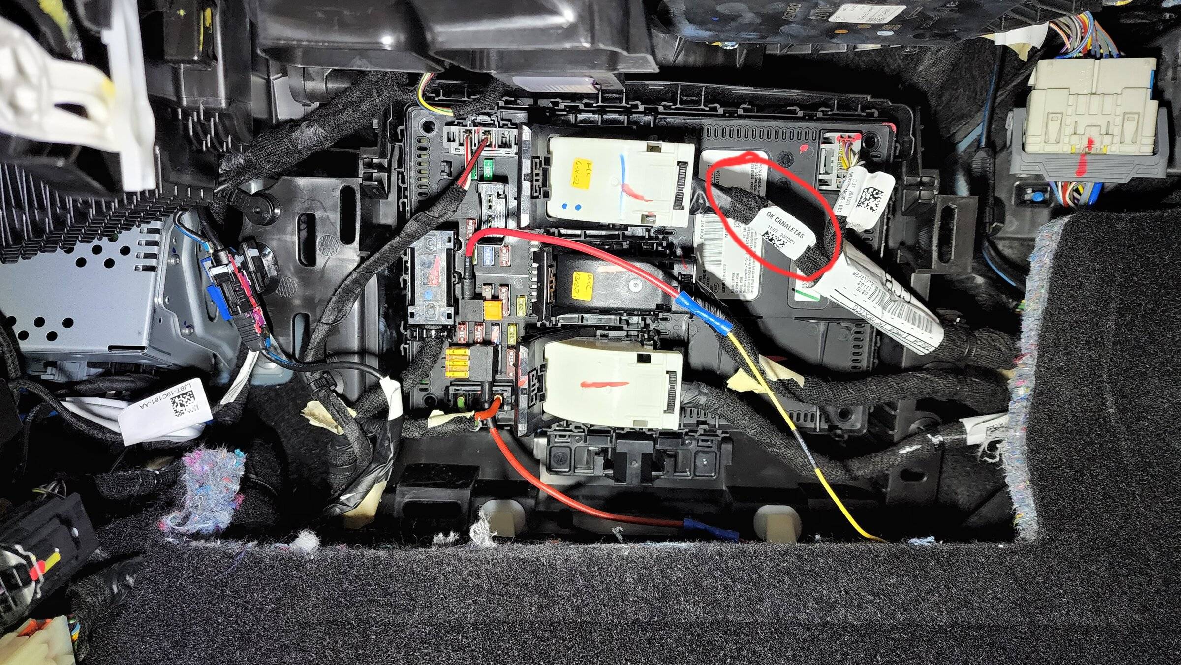

Thanks!The only way to trigger the Frunk beside using the main screen is the button inside the frunk. That button connects to the Generic Function Module (GFM) behind the center screen (slightly below it). It’s a real pain in the ass to get to. Moreover, if you use that button to pop the frunk, it will display an alert on the IPC letting you know that button was used and to check the frunk to make sure nobody was stuck in there.
I’ll dig up a wiring diagram shortly.
