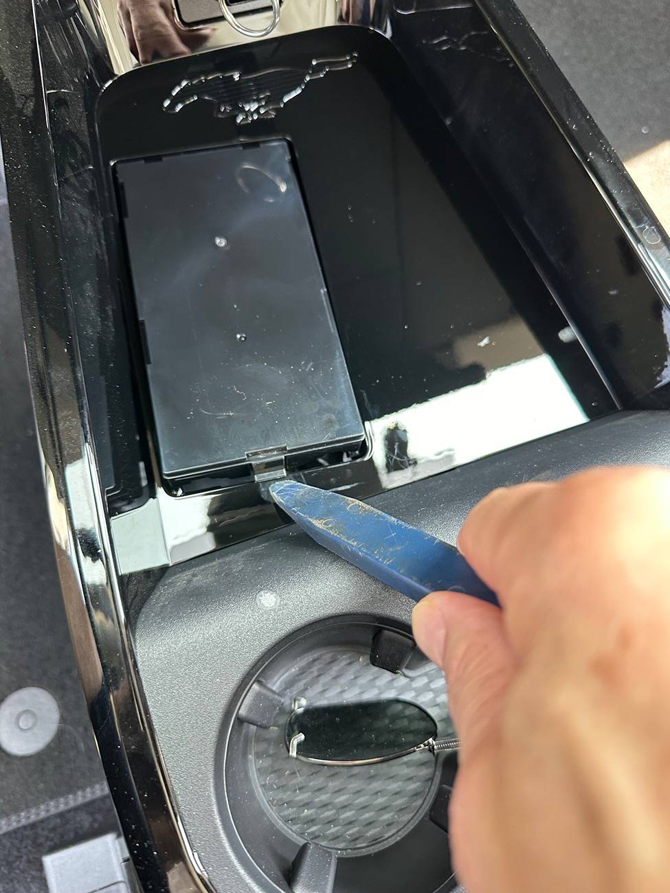

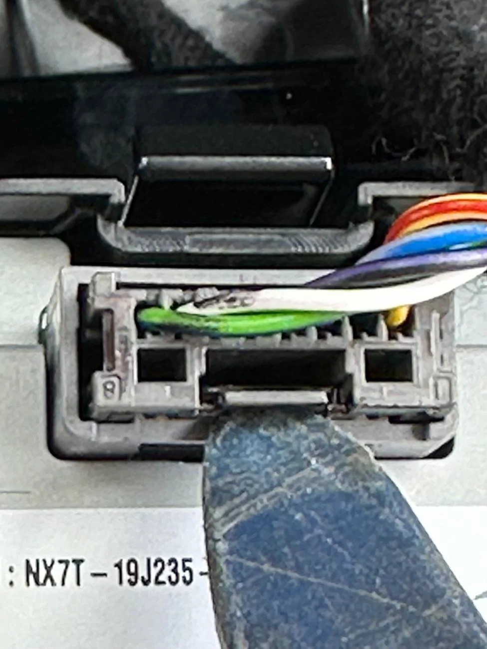

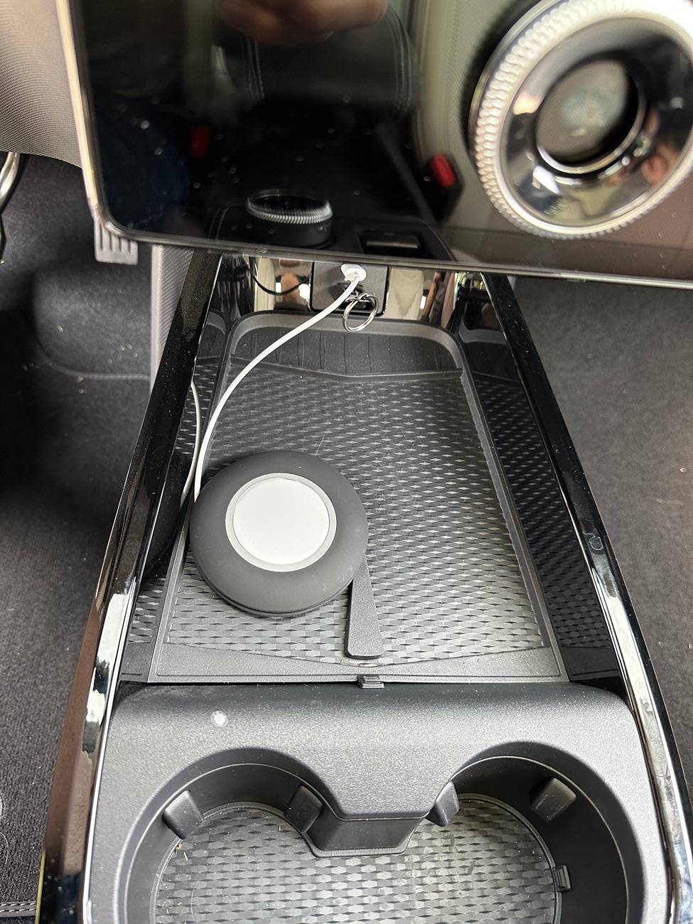

Or, pop out the ford charger, unplug it, pop it back in and get this MagSafe charger at Walmart that wraps the extra cord plug it in and done. If you wait for ford to do something it will be on the list right behind the mythical NACS adapter. The reason people get different chargers is the ford charger seriously overheats your expensive phone!
