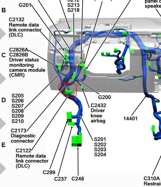

Not all updates are done over the air.
A common use for the OBDII port is to connect to the onboard modules for diagnostic purposes and read PID data. Can also run self check and test commands from that interface.
The ODBII port is under the dash near left knee on LHD models.
