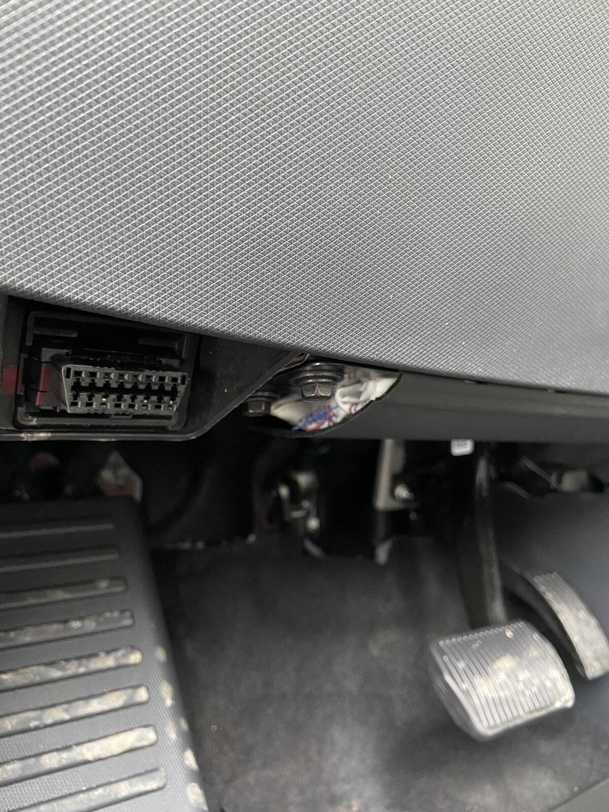

my understanding is the S and X have one, while the 3 and Y got an EPA exemption.
e.g. OBD2 connector location in Tesla Model S (2016 - 2018) RHD - Outils OBD Facile
I don't know this for a fact, just online searches.
Attached is the OBDII port on my 2020 Model Y. Technically it's not OBDII since the car is exempt but more a tap into the CAN bus. Lots is useful information but you'll need some programmers to develop an app for the MME to display it in a usable, visible format.

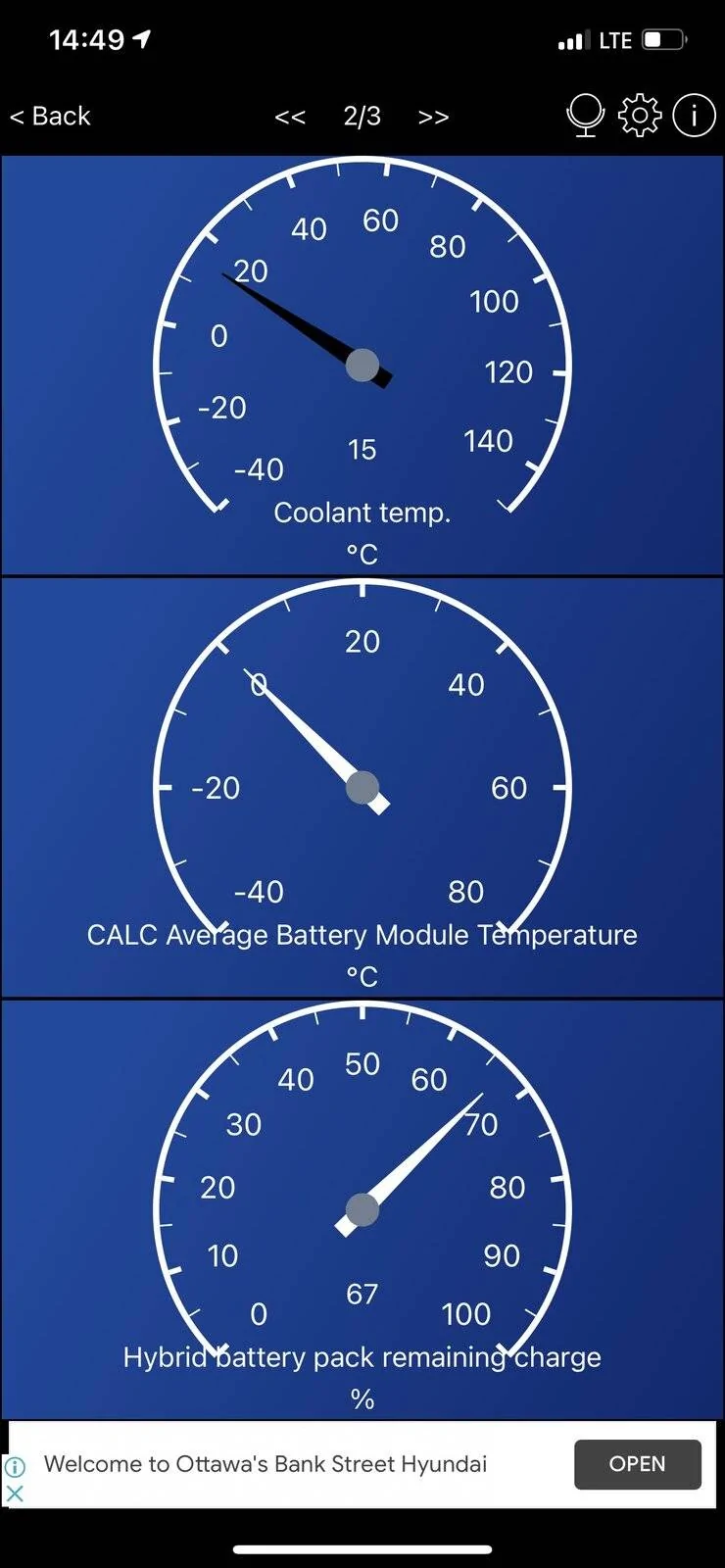

I tried with Car scanner on iOS but I didn’t find battery temp yet. There are many datas available but you must test them one by one. Here´s a screenshot

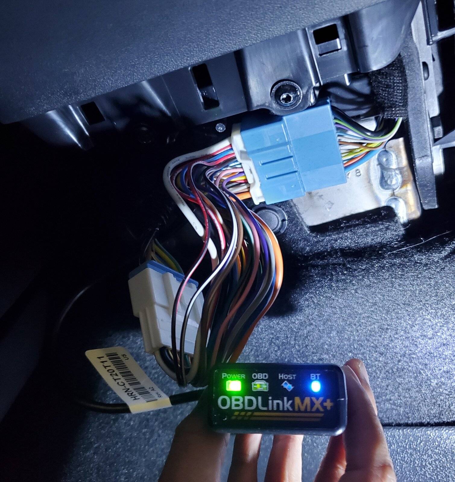

I also have an OBDLink MX and tried it on my Mach-E.
Yeah Forscan gave up with WTF car is this message.
Torque Lite was useless.
I tried another free Ford app and it really messed with the car (started throwing all the error messages and nothing worked until I shut it off and unplugged the MX).

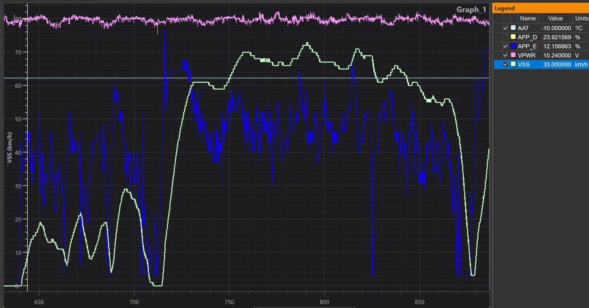

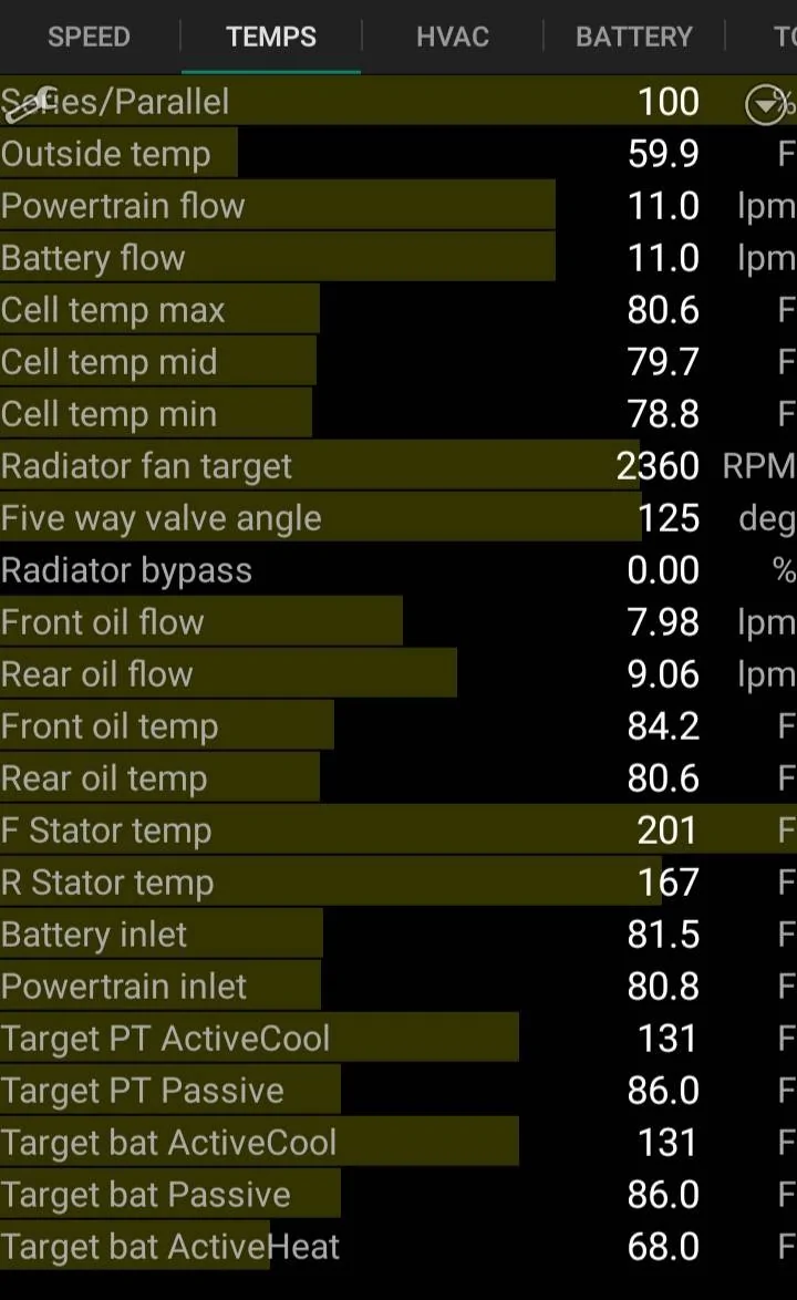

There is some basic data on OBD thru other tools, pedal position, vehicle speed, battery (LVB), and a bunch of temperatures but it’s hard to tell if they’re real or garbage
I made a small Python script to scan 22 ECUs that are happy to respond on CAN1 to see what data they’ll supply, so far looks like quite a bit. Few ECUs that gave their names so far were BCCM battery charge controller, BECM battery energy controller, ECM, HPCM and TCRD
Main thing I’m interested in is power to/from the motors if anyone has hints
