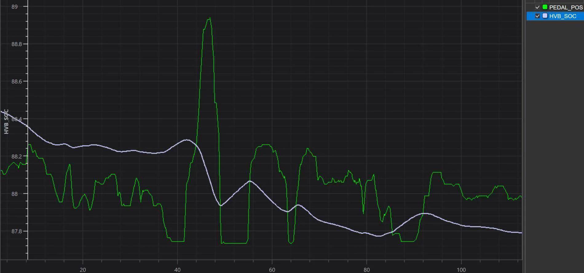

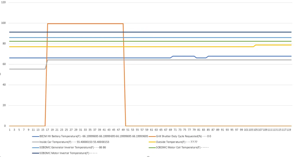

Attached is all the IDs which gave positive responses for anyone interested. These were from the nodes that responded to a broadcast while it was in accessory mode & charging which seemed like a good starting point. Then I found out I could download the AsBuilt file for the car from https://www.motorcraftservice.com/AsBuilt and it looks like I missed about half of the nodes 😖
Lots of the IDs just seem to be part numbers and other static info but some seem the same as Fusion/CMax. Battery SOC from BECM looked good so I got to see the regen at work on a short drive. Scaling seems off a bit still, I have it scaled so it matches that we left with 90% and returned with 87% on the dash
