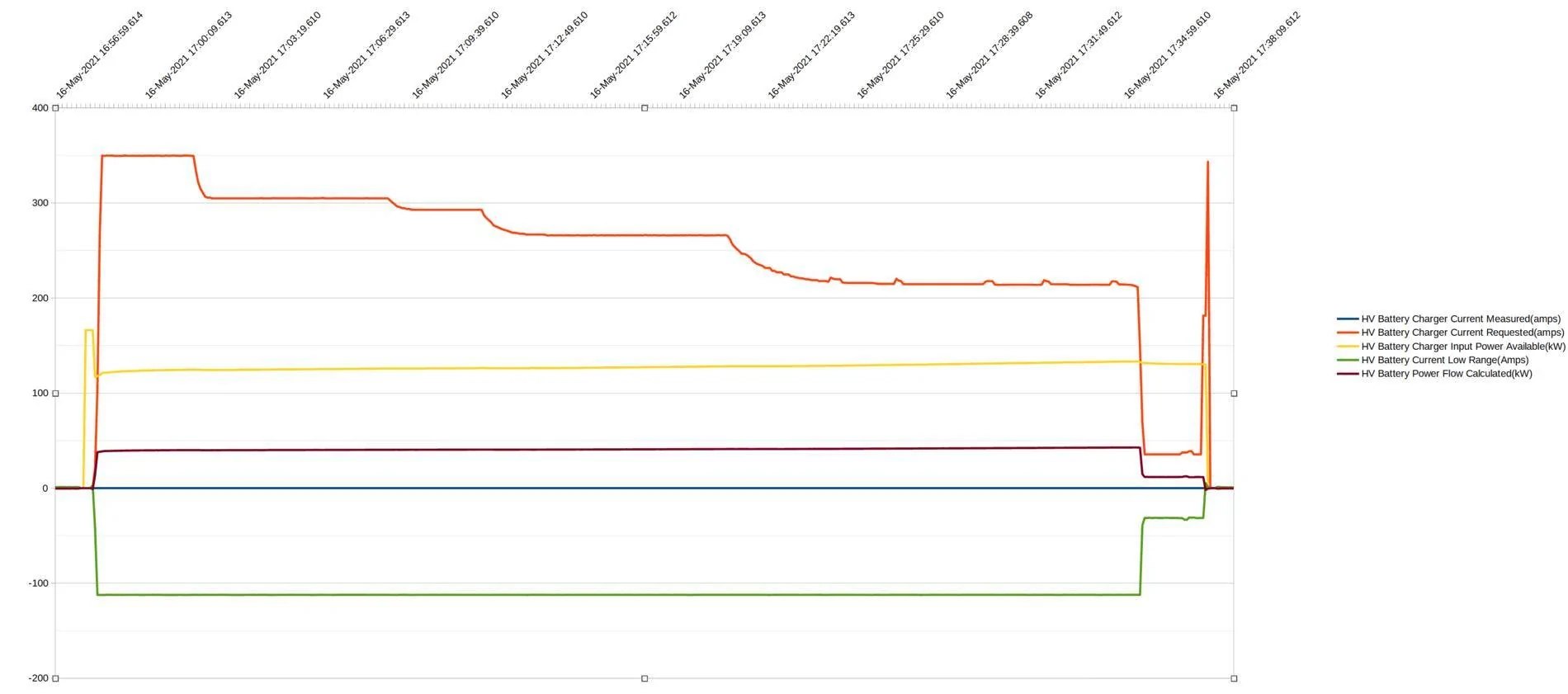

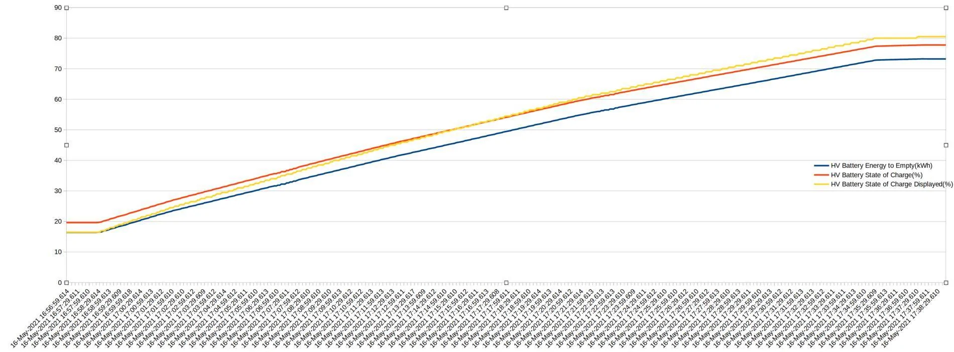

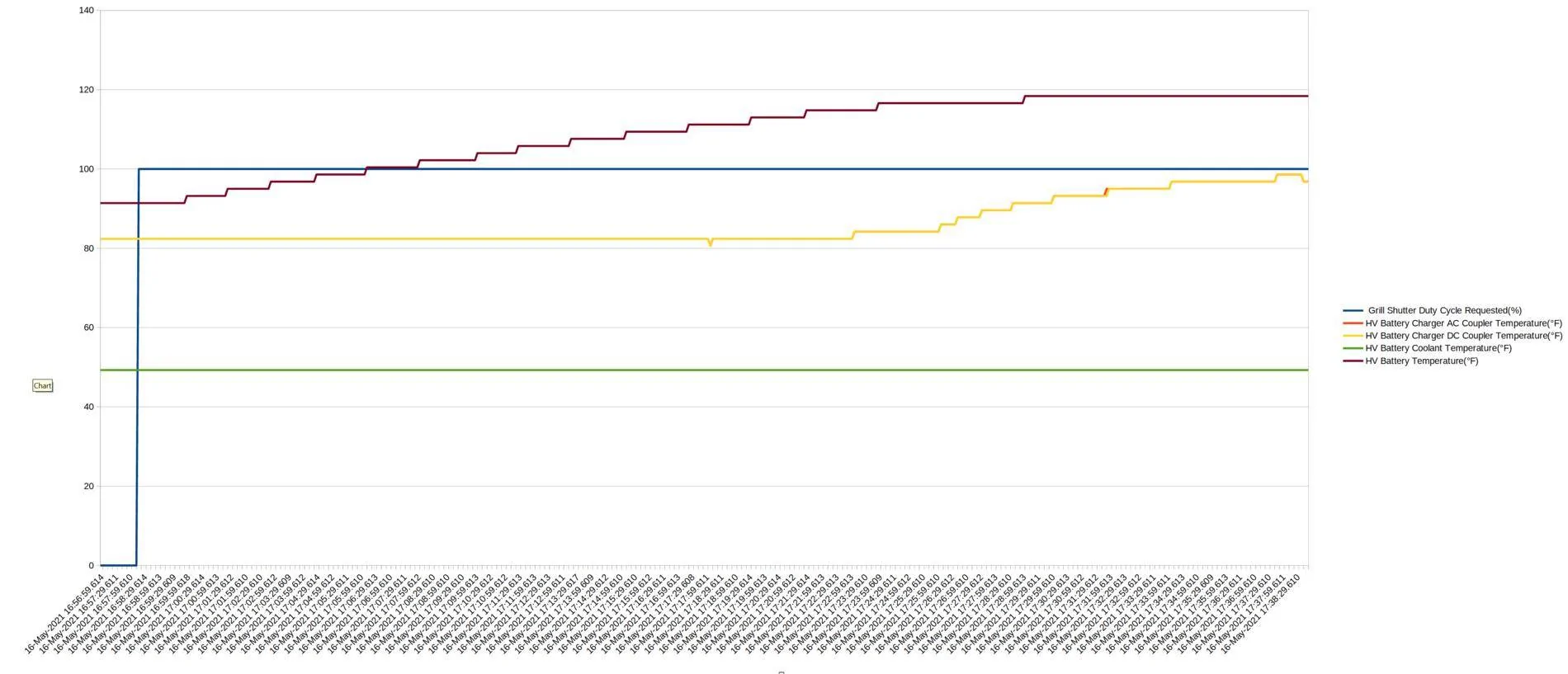

I am making progress. The WSM is helpful as I found Ford reused the Generator PIDs in the Hybrid for the secondary (front) motor in the AWD. They mention it in the troubleshooting guides. There also seems to be several new PIDs for the charger. I tested out my latest torque pro file on a DC Fast Charger and got some interesting results. It seems like the car was requesting more current then the charger could deliver. I was at a 150kW Electify America charger. Some numbers could be off.

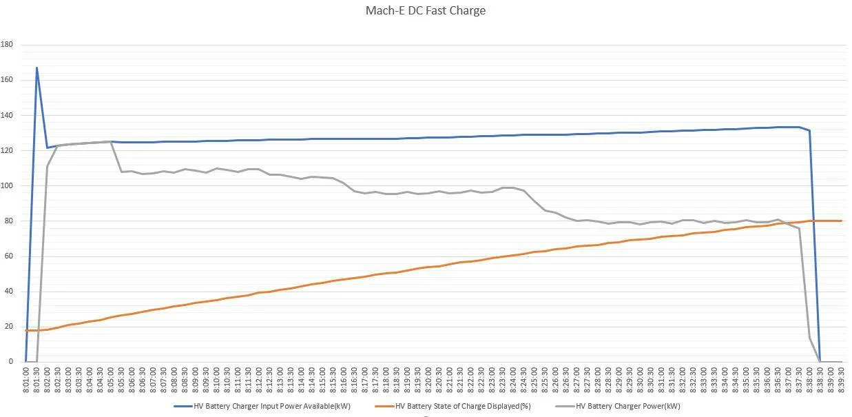

Still some more work to do on charging pids, but I got enough information to do a charging curve. I had to calculate the Battery Charger Power by multiplying the charger output voltage by the charger output current. So I can log via Torque Pro instead of writing the numbers down off the charger.
My car is a RWD ER and it seems like the 37 minute charge time from 18% to 80% beats Ford specs. The initial peak power is limited by the charger. This was on a 150kW EA charger. I want to try a 350kW one to see what happens when there is a higher initial peak. The charge drops to 11kW when the SOC reaches 80%.

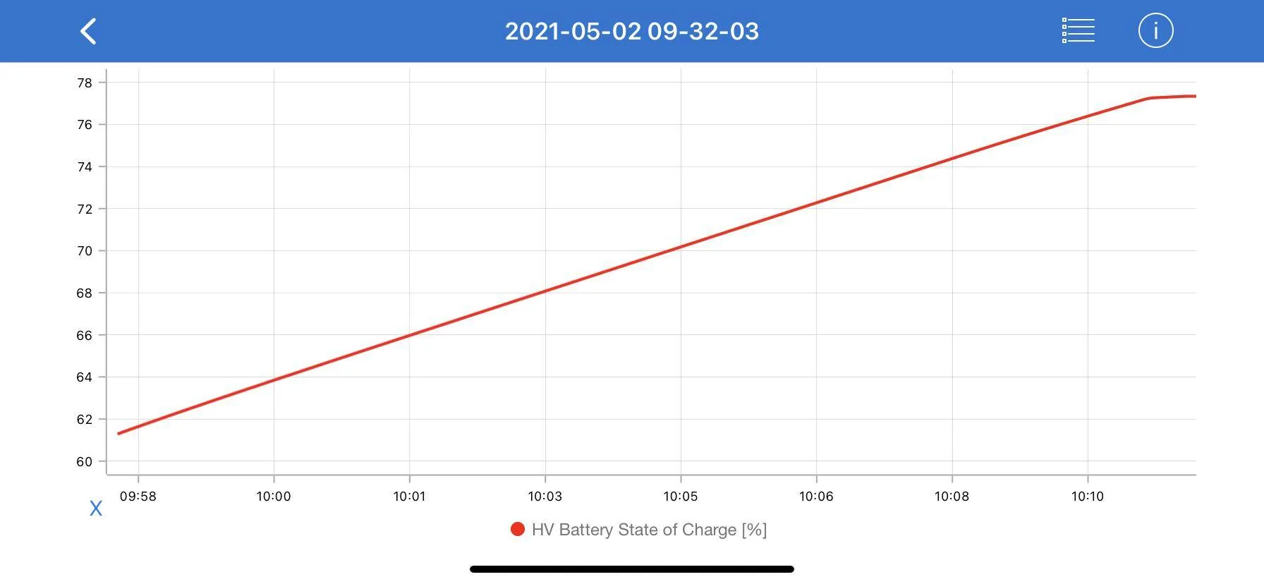

I did some testing when cartoony from 60% to 80% on an EA. I had to use the same technique to multiply the current and battery voltage to get the power charging curve. The curve is very odd. But one thing I’ve noticed is that the state of charge increases at a constant speed. So I guess the Ford engineers adjusted the power charge to make the SOC goes up in a steady speed.

Can you export your torquePro sensor list/PIDs? Particularly interested in requested power, batt soc, shutter position hv battery temp. None of the carscanner pro Ford profiles I tried have this info.
