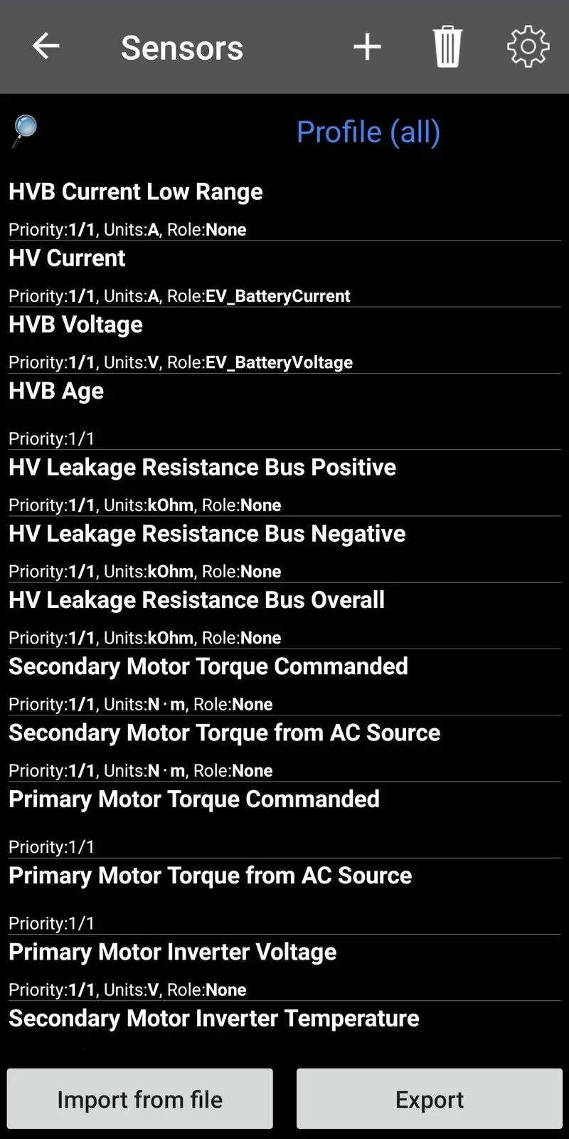

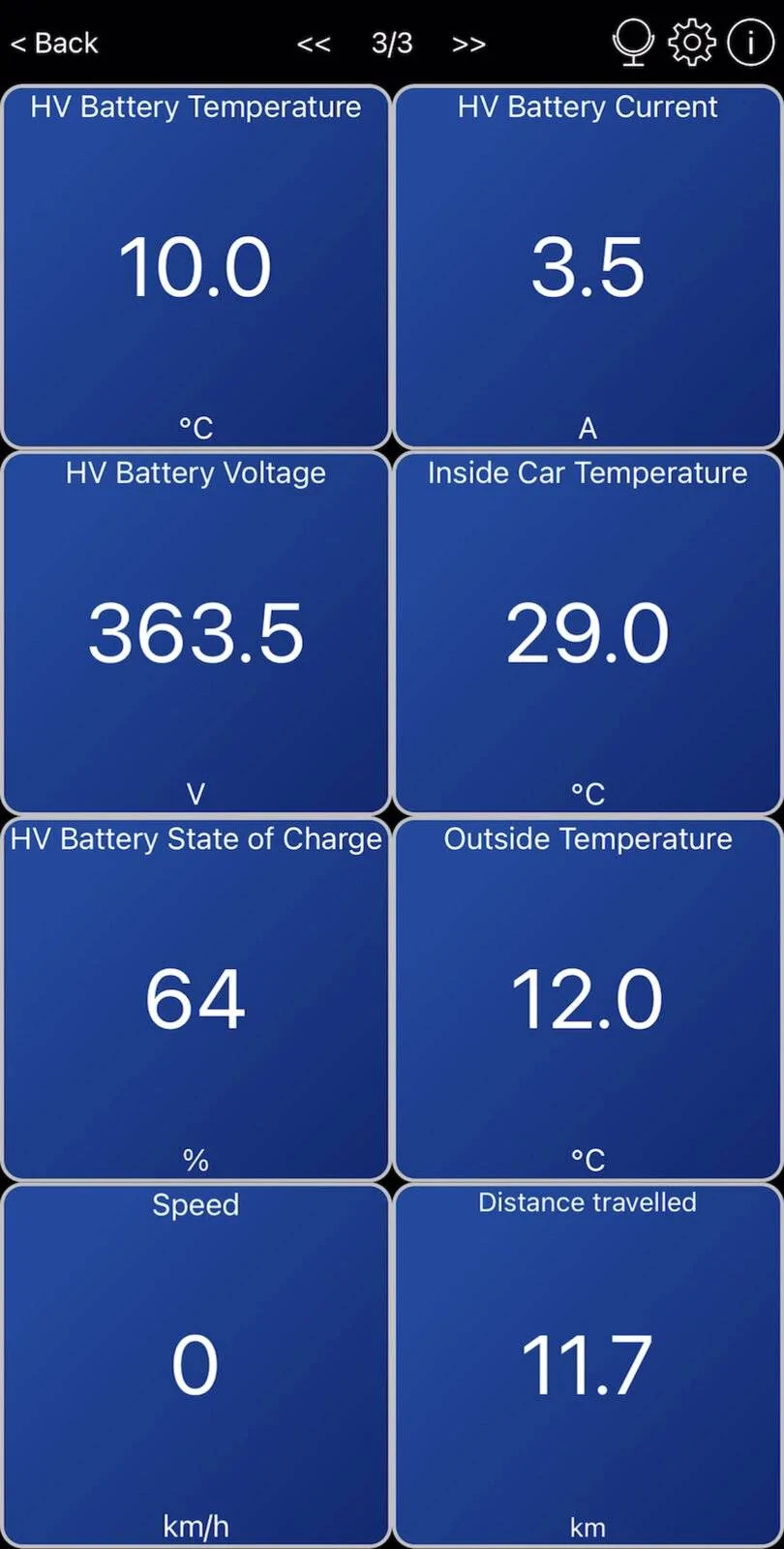

For now I'm ok with Car Scanner with the CMax profile. I would like to see the current in kW instead of Amps.

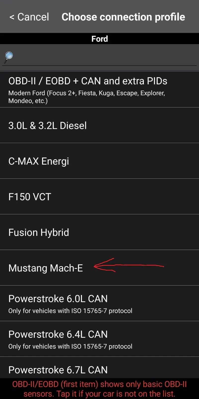

So here is a simple trick to get HV Battery power in kW in Car Scanner Elm Obd2 app (and many other sensors in Mach-E):
Settings - Vehicle profile: select Ford C-Max Energi
[EDIT]: select new Mustang Mach-E profile
Settings - Sensors (Profile)
HV battery voltage / Role override: assign new role: EV_BatteryVoltage
HV Battery Current / Role override: assign new role: EV_BatteryCurrent
connect to the car, All Sensors will show Hybrid/EV Battery Power in kW, which can be selected in the dashboard.

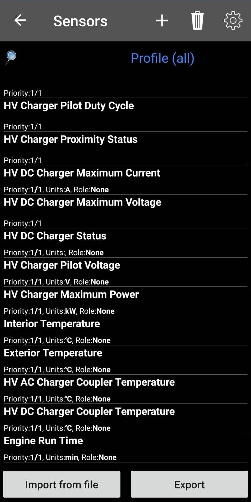

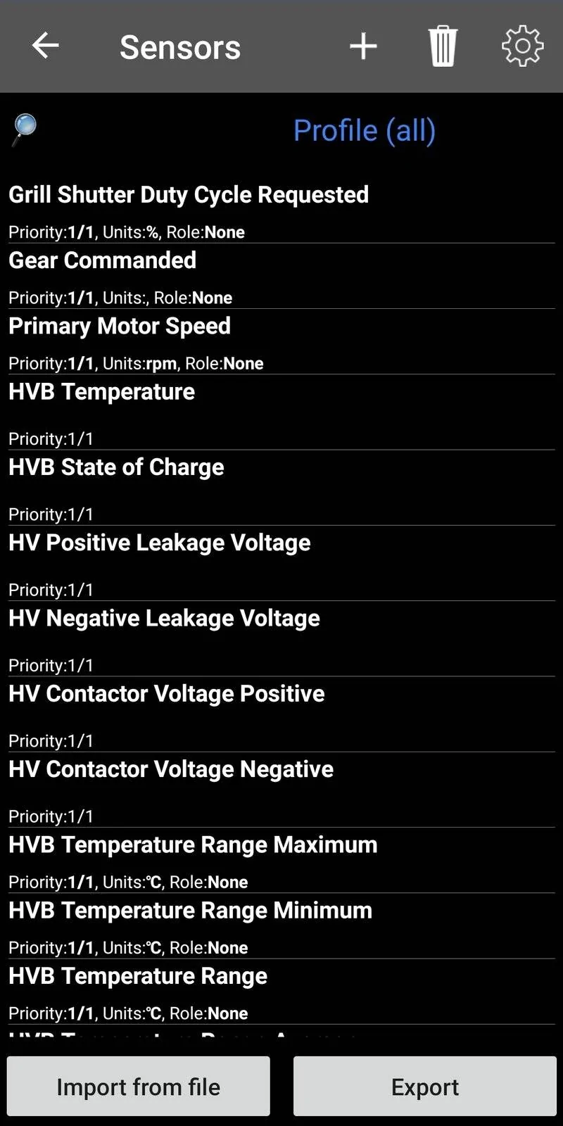

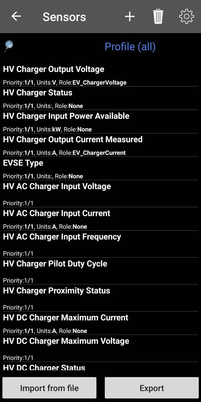

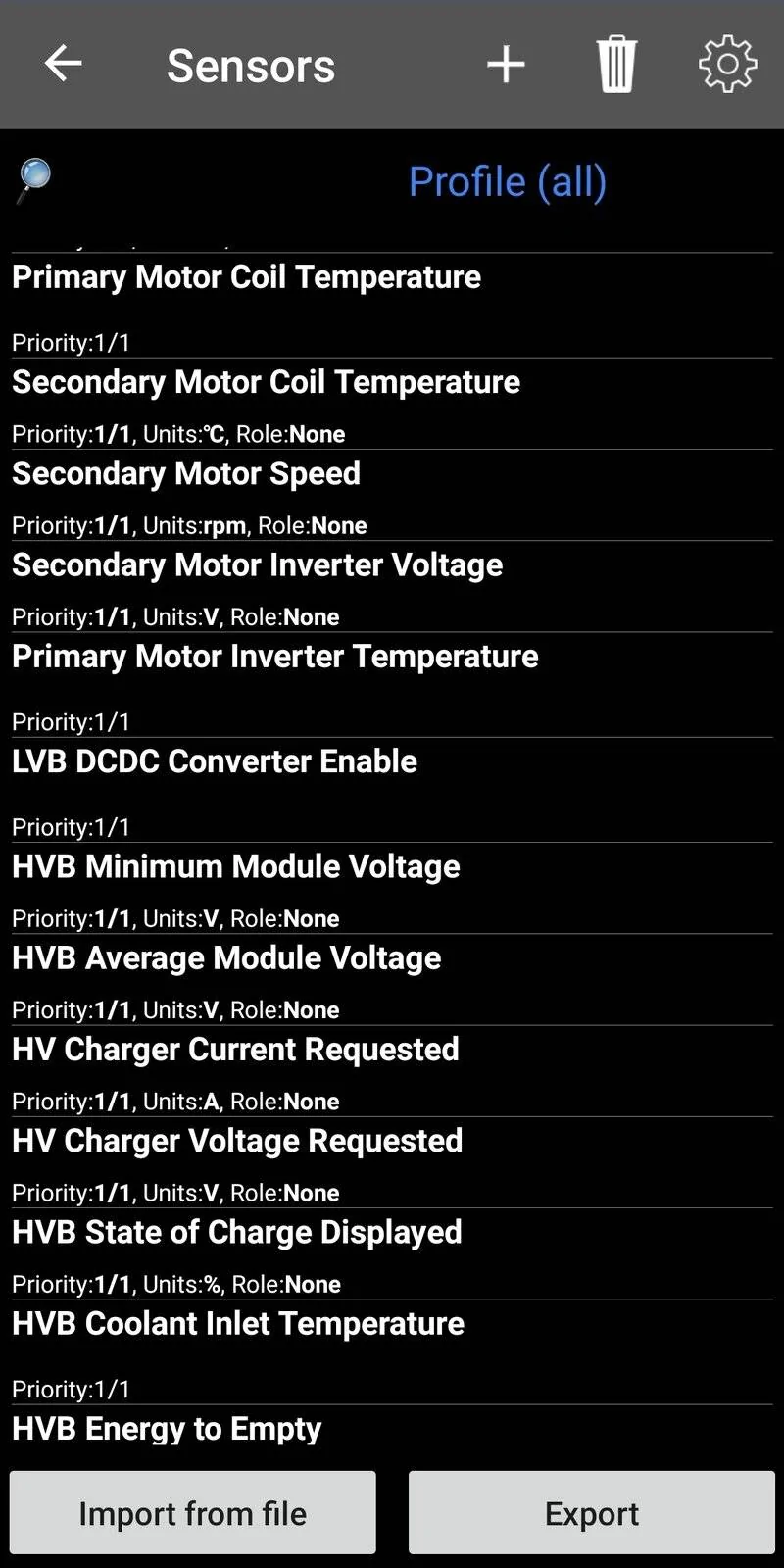

Car Scanner ELM OBD2 got an extensive Mach-E profile, which seems a mix of sensors from C-Max Energii profile and pids developed by Eric C Boston, mentioned elsewhere on this forum.
This app works on iOS and Android, I use it with iCar Vgate PRO bluetooth adapter.
Sensor list:

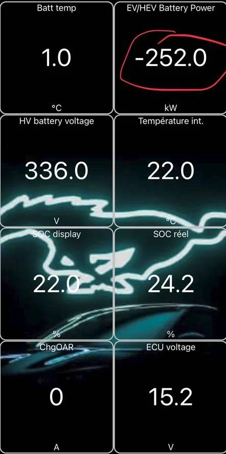

Since update 21P22 update, I've lost my instant power in kw. At idle it displays around minus 250 kW instead of 0-3 kW. Anyway to get this back?
