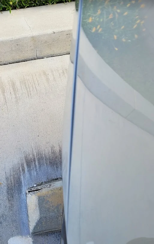

After a year of using my mach e I started noticing some imperfections on the car body. For example the rear bumper ends on the passenger side there is a little gap
Ford Mustang Mach-E Are those defects or I'm just too picky? 1681916665522
Here is the driver side taken at the same angle for comparison. It looks almost perfect

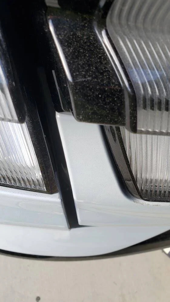

There is also slight surface gap between the body and the hatch door

The corners of the external panels don't match perfectly either

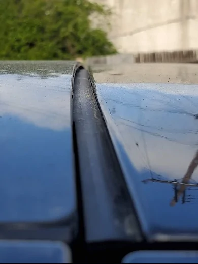

The hatch is slightly lower then the roof
Normal, it's for wind noise.

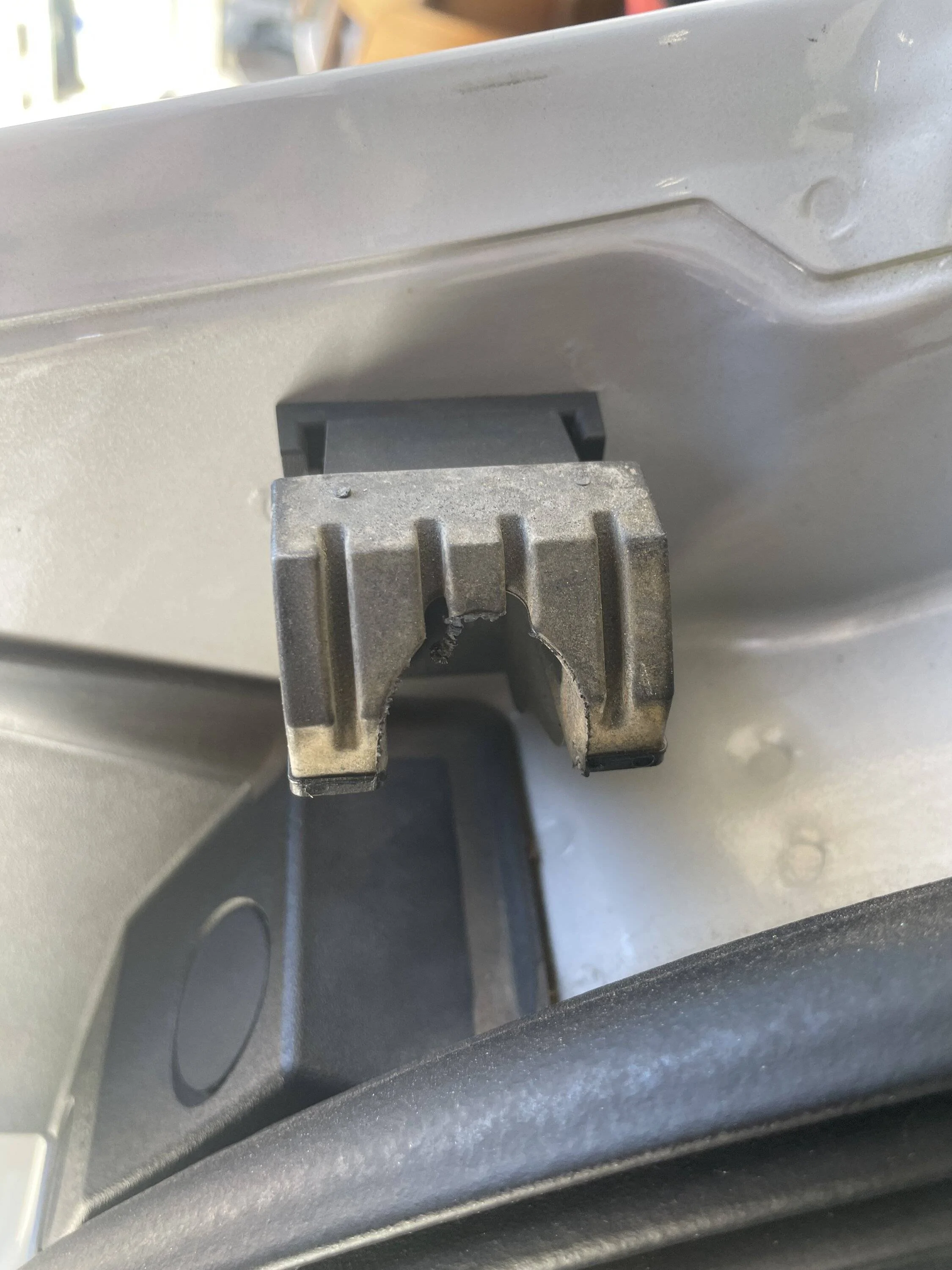

Adjustable via the (probably gray now) wedge bumpers.
Slight bit up will push the hatch towards the other side of the car. My two bumpers barley touch my hatch. See the left 'column' is the only one clean, that's the only one touching on my car. I might try to nudge them just a hair and see if it does anything for road noise.

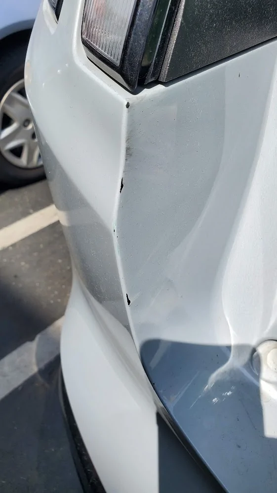

Also why the paint goes off the bumber so fast
The deck lid isn't touching in any pictures. I would bet money someone bumped you in a parking lot.
