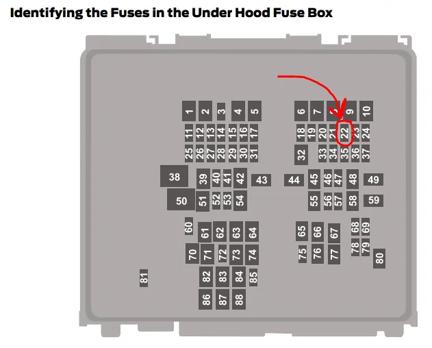

Maybe check fuse #22 for the amplifier. It's in the owner's manual:
I thought of that, but when I read the manual I didn't find anything indicating the sound fuse. But now that you mentioned #22, which is the amplifier that makes sense. Good catch.
It is very hard to reach this fuse box. Man they made it difficult.
