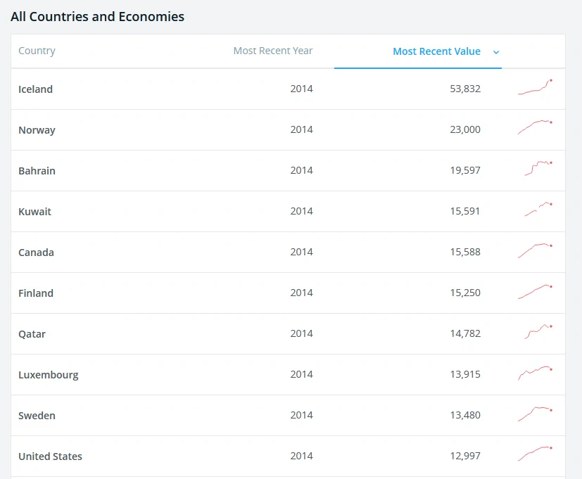

I couldn't get all the way through the article before I got kicked out for not being a subscriber. But it seemed that proliferation of charging stations was not named as the culprit in the part I could read. It cited "Electrifying everything..." as the reason for record electric power use.
Here was the oft that got cut off:
“ The country’s love of electric cars won worldwide fame through a Super Bowl ad starring Will Ferrel, but electricity is also the dominant source for heating in Norway. Power is used to warm as much as 85% of all indoor spaces which compares to Sweden where district-heating is the major source.
This has contributed to Norway having the second-highest power consumption per capita in the world, according to the World Bank, only beaten by Iceland. The country expects to keep consuming more with the thirst for power set to grow 30% by 2040.”
Maquis
634
832
2021 Mach E Premium; 2017 F150 XLT; 2013 Explorer XLT; 1965 Mustang Convertible; 1953 Chevy 3100
Thanks!
Makes sense. Made me curious about the actual per capita numbers:
