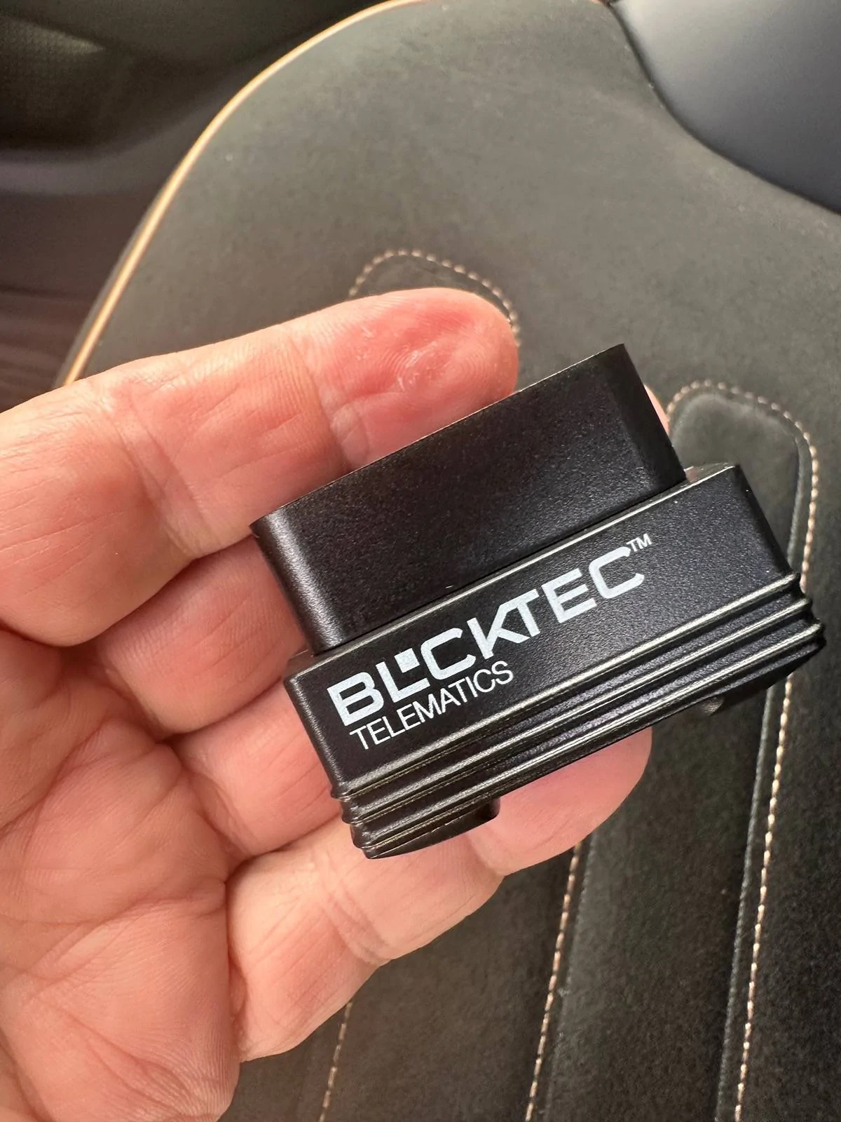

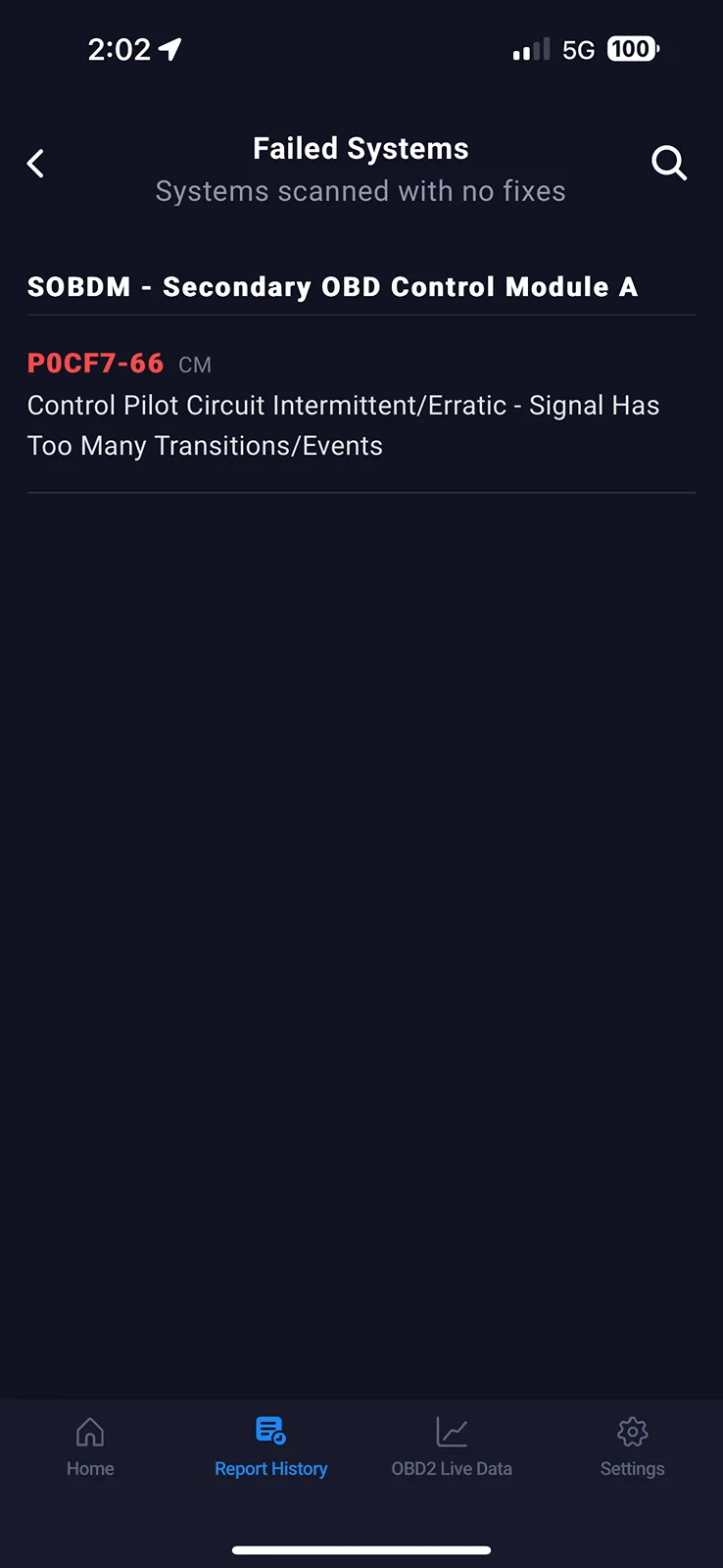

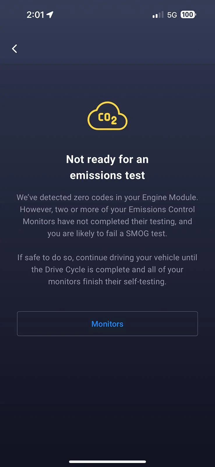

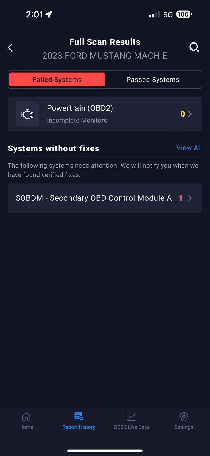

I decided to get one of these black tec readers I saw online, it came in today so I did a quick scan and I just wanted to put some pictures of one of the things that it found, and of course I know there’s no oxygen sensors on this EV, at least I don’t think there would be? Any of you that’s had the Mach e for a while respond to any of the pictures I took screenshots?

Where did see a message about an O2 sensor? I don’t see it in the pictures.

I think I miss took that for the Message about the smog I’m sorry
I was researching that POCF7 code, Just trying to figure out that code. By looking it up it looks like something to do with charging. I’m guess there’s nothing wrong. I don’t know.
11,353
24,980
Yes, it means you have a bad EVSE, or a bad connection to the EVSE causing the control signal from it to drop out. That can interrupt your charging.

I’m gonna do a little searching on the web. Is there a fix for this?
