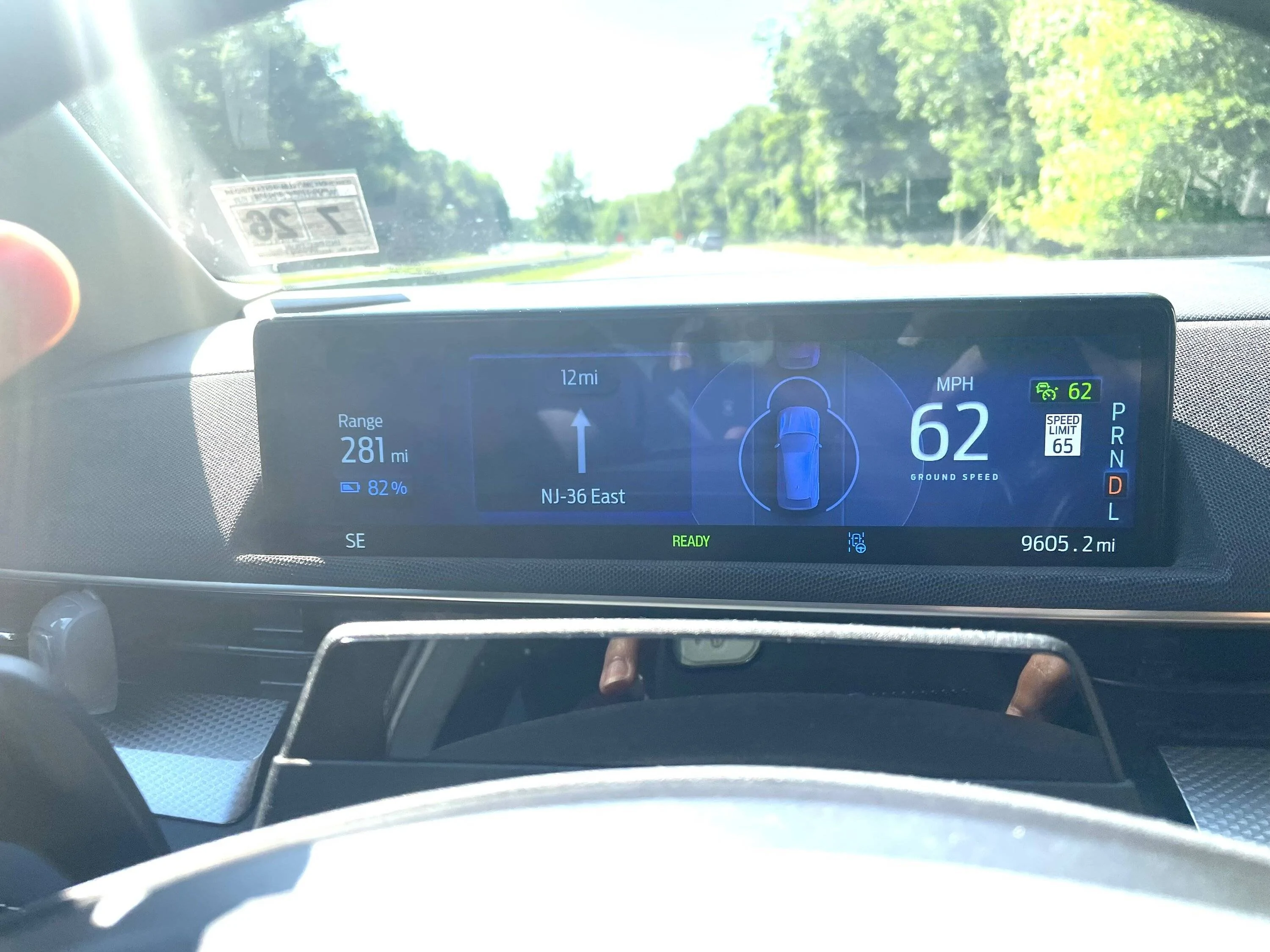

Yeah, Ford shot themselves in the foot by expanding the definition of "BlueCruise". It can refer to EITHER the hands-on or hands-off automatic lane centering.
When the hands-off is working then yes the instrument panel is blue. I've had hit-or-miss behavior with it on the AC expressway and garden state parkway: on exactly the same stretch of road the handsfree engages about 50% of the time.
Anyway here is what the handsfree screen looks like when it is yelling at you for holding your cell phone in front of your face so it can't see where you're looking (the "watch the road" message):

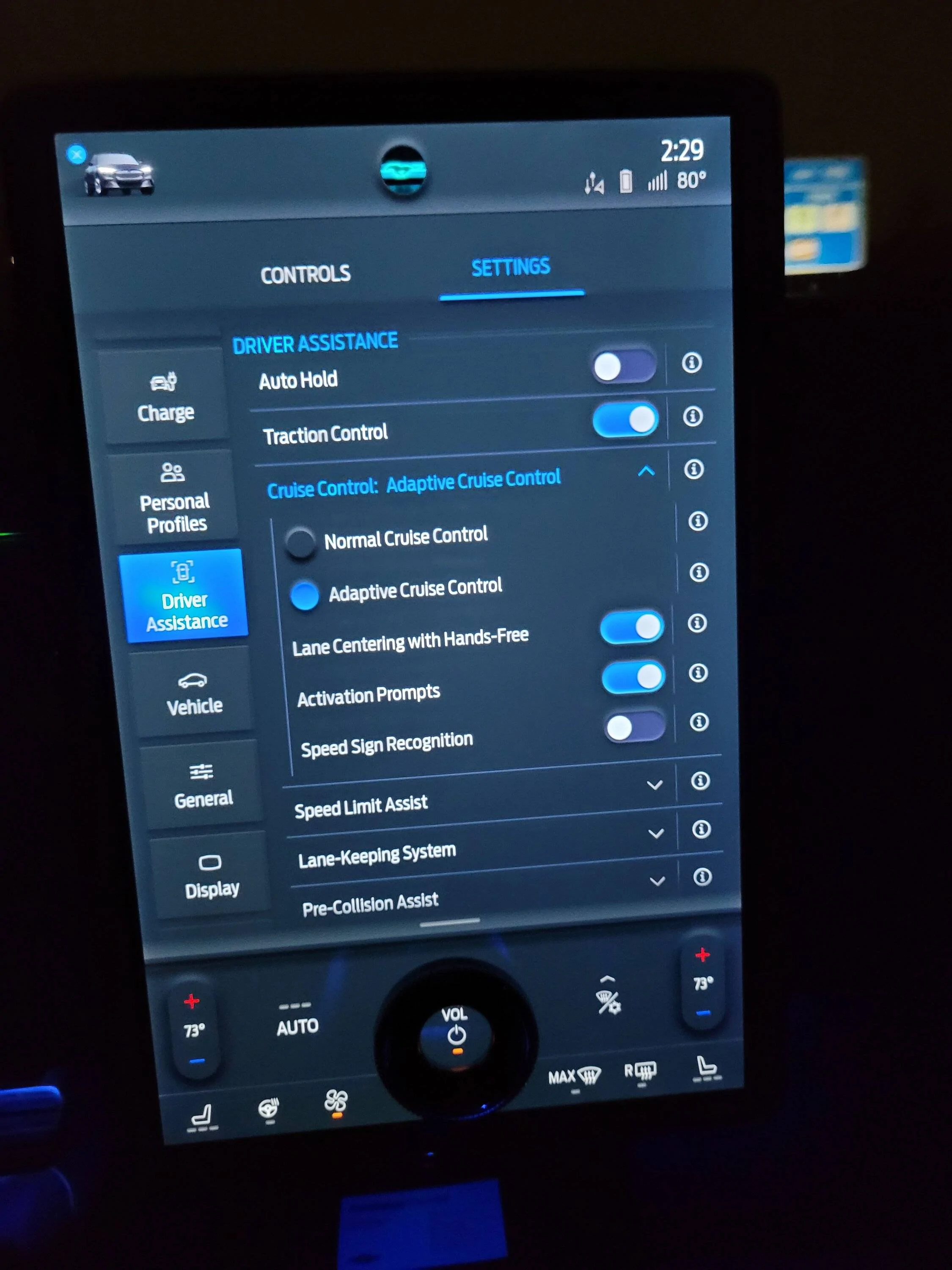

@billy_at, from your post, it does sound like you're doing the right things so I'm not sure how to help, but if you are able to post a photo of the instrument cluster that might help us see some important detail. The big ones are to activate both adaptive cruise and lane centering using your steering wheel controls. Since you are seeing the "BlueCruise is active" message, I think it means you've done that.
Some things to double check:
Check your Adaptive Cruise Control settings to verify that they match the ones @SnBGC is showing above.
Also, bring up your navigation display and verify that while you're on the highway, the car agrees. Some of us have been having an intermittent issue where the car is tracking the wrong location. If that happens, hands free driving mode won't activate.

Thanks - these are very helpful. Iā€™ll check the Lane Centering with Hands-Free setting tomorrow morning. Itā€™s surprising to learn that there are separate hands-on and hands-free BlueCruise modes but the Ford video confirms it.
