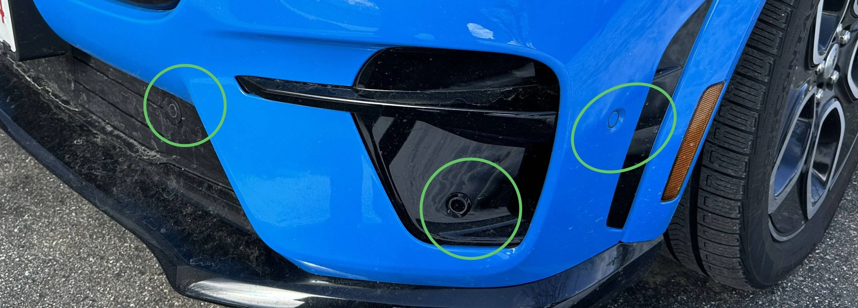

The only thing missing is the module that control the self parking feature. The sensors are active and can be used by other systems without issue. It's the parking computer that is missing. (The module that would calculate the movement and shows the UI in sync, then relays that data to the other modules to perform it.) Hence why blind spot detection still works just fine ect.

No this is a limitation of the 22s that don’t have park assist. My 2021 had sensors active all around. Front, Back, and sides. The 22 only has them active on the front and back.

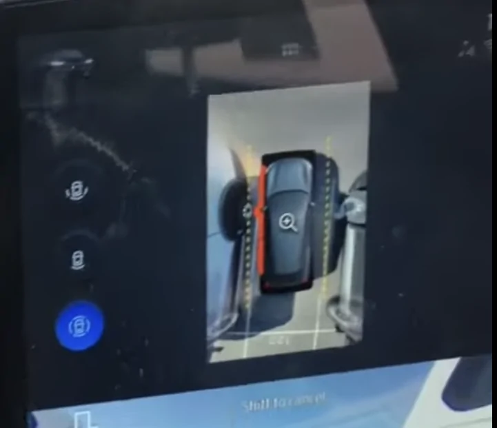

I do have the 360 camera. The side sensors are there, they are just not active. If you look at this YouTube video you see those orange lines that show up on the side of the car? I don’t get those. I just get them on the front and back.

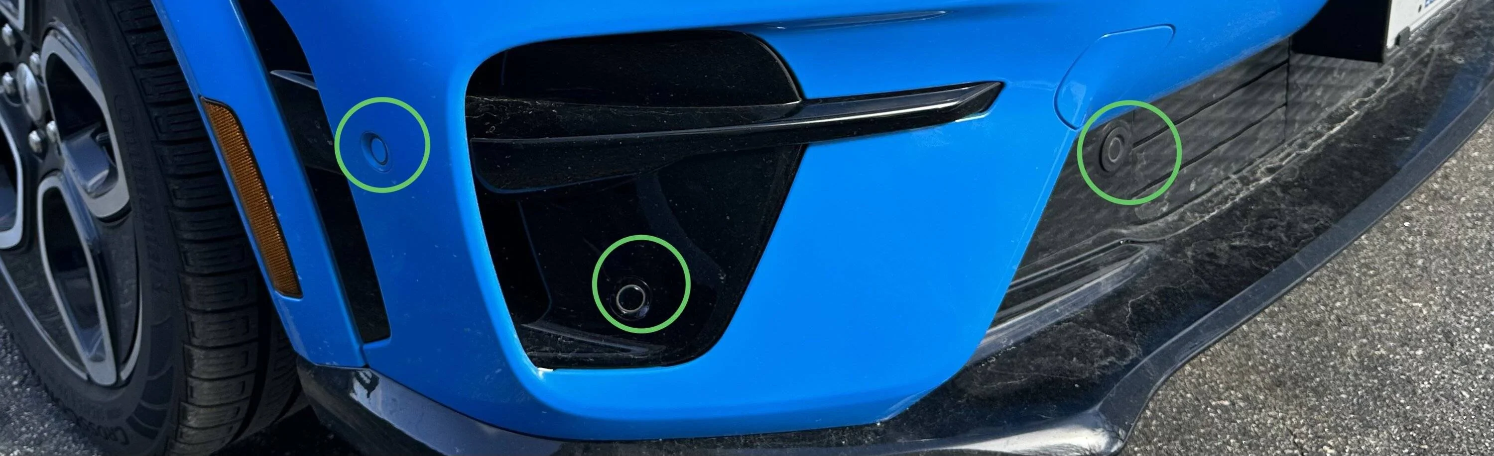

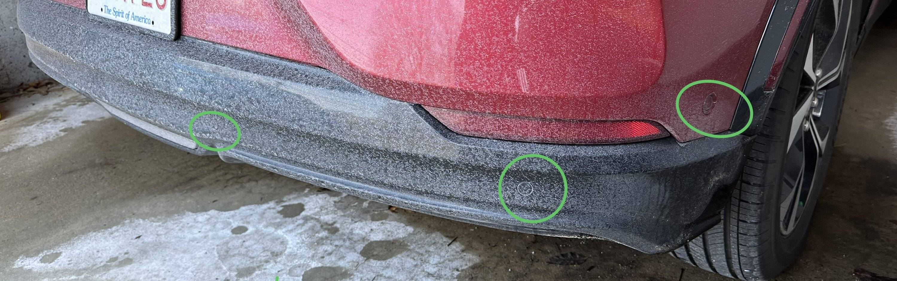

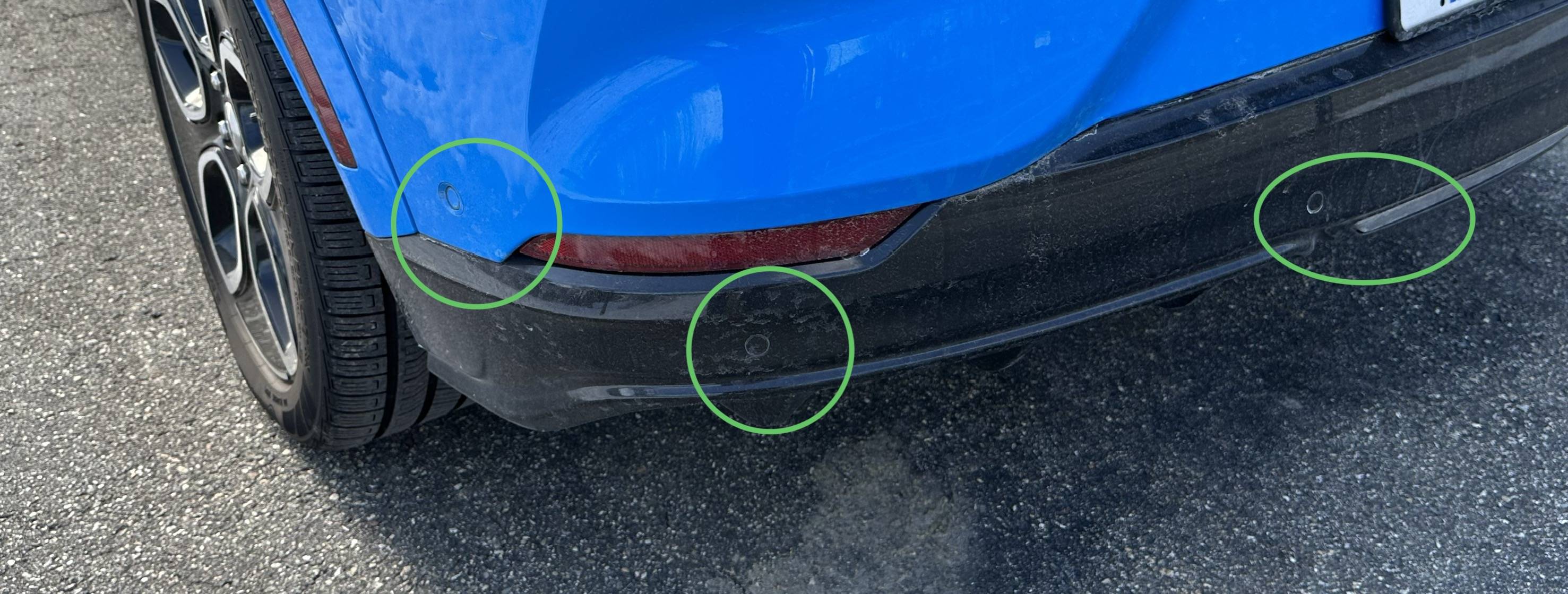

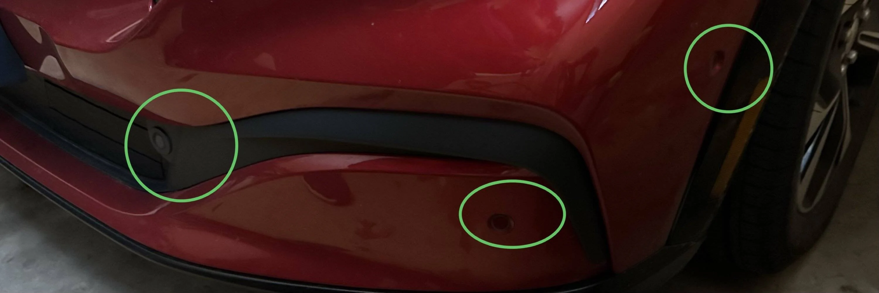

My husband has a 2021 with everything active, I have a 2022 with the limited sensors. He gets the orange lines on the sides, I dont. Unless there's something else I'm missing the lack of park assist hardware is the reason for that. The actual sensors on the bumpers are the same.

Yes, like others have said, this is a park assist thing and not a lack of sensors. They are there and fully functional. Its park assists software that show those lines. Park assist is using the 360 camera for line detection and shows that in the user interface and not any type of sensor.

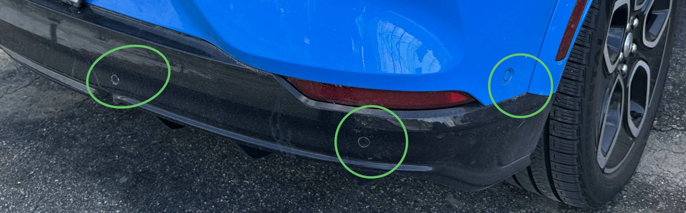

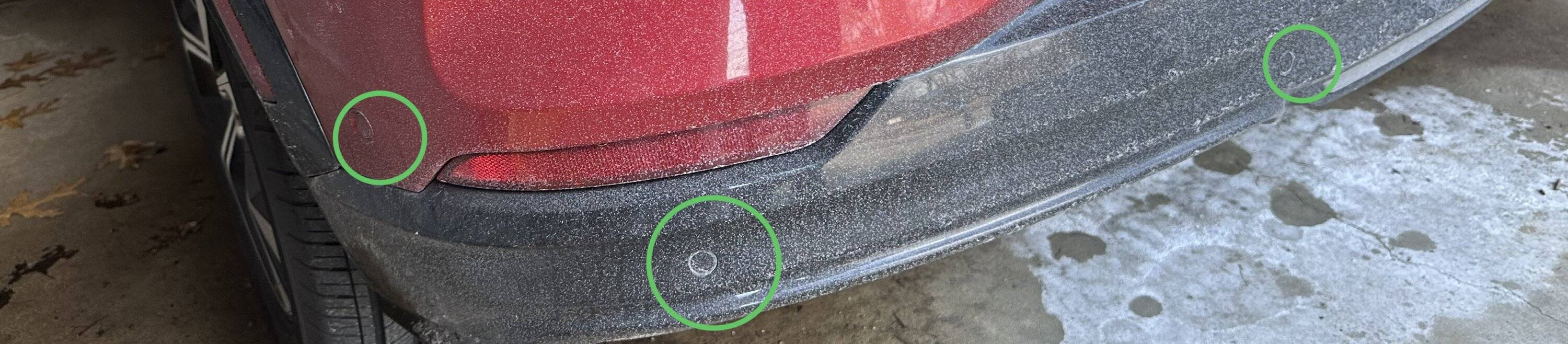

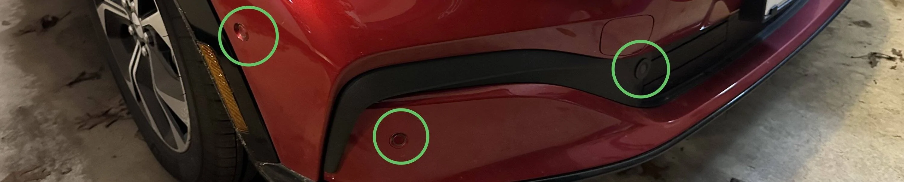

@AlanJ @Ghost Ryder @Neil4Real @Just Lurking Here is my husbands red 2021 Premium J2 vs my 2022 GT J2. Same number of physical sensors. My husbands car shows orange and red lines on the sides of the car, like in the pic below. If you look at the attached video my car does not display or audibly alert for those side sensors. We can debate whether those sensors are powered on or not, but in the end they are not functioning as parking sensors.
Wow, that's a total bummer! I've never seen anyone report this as everyone has said you just lose the feature where the car parks itself, I didn't know you actually lose some items, that's a bummer. I use it all the time when parking in my garage, especially now with the rain and I might not be able to see cleanly out of my side mirror, the car let's me know if I'm too close.
Hopefully @Mach-E VLOG can check their demo car to confirm this isn't just a bug with your car? Since @Ghost Ryder appears to be getting the orange lines that show it is working, it would be interesting to get confirmation from others on how their cars are functioning.
Correct, the side sensors are present but not functional. Therefore you won't see the orange lines on the sides without Park Assist. Essentially the side sensors aren't hooked up to the ultrasonic board because they couldn't get the version that supports side sensors due to shortages.
Thank you. That is what I’ve been trying to explain to everyone. Whatever part was removed during the part shortage impacts those side sensors, which makes sense why park assist wouldn’t work.
