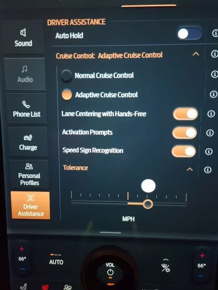

alexgorod
Alex
Jul 27, 2021
1,052
1,116
DBA
If on intelligent cruise it will adjust to the speed limit, even if it goes up. If on normal adaptive cruise it will not adjust any time.
It didn't in my test.
This setting means it's "intelligent", right?
