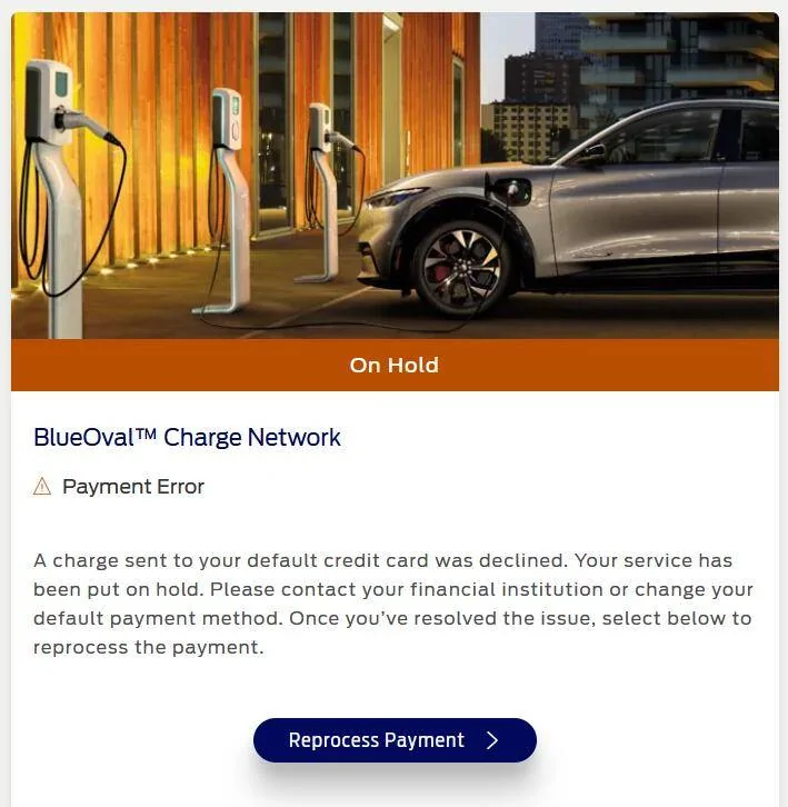

So as of August 21st something weird is going on with the blue oval charge network when ever I try and charge my car out in public. I stopped in at a electrify america I've used countless times. Plug in my car, and start charging, and then got hit with an error in the app and the tower saying "payment declined" So I call my credit card company in a panic thinking someone stole my chard, and they said there are no problems with the card, and have no declined charges on their end, so it's got to be on the other end of the transaction. Every time I tried to unplug and replug the car in to start the whole process over again, I get the same error.
In the fordpass app, if I got to connected services it says "on hold, payment error, and then reprocess payment" under blueoval network. If i click that link, it says an error has occurred, and to call the ford customer service line. I've called it 3 times, and they have no clue what I'm even talking about, and are zero help. I've tried using 3 other credit cards, seeing if it was just a card issue, and still no joy. I've tripple checked that my address is the same on all of my accounts in the ford app and ford website.
At this point I don't even know what to do, and literally can't use any charging network that's part of the blueoval network, as it automatically syncs with the car and the network, and goes through the same whole error again, and declines it.

You'll find the exact same problem if you try to update / reprocess the payment on the https://www.ford.com website.
I have the exact same issue and disabled Plug-n-Charge via the FordPass app, as a result.

Here's what I see on the website:
Ford Mustang Mach-E Blueoval charge network error with electrify america 1662683915266

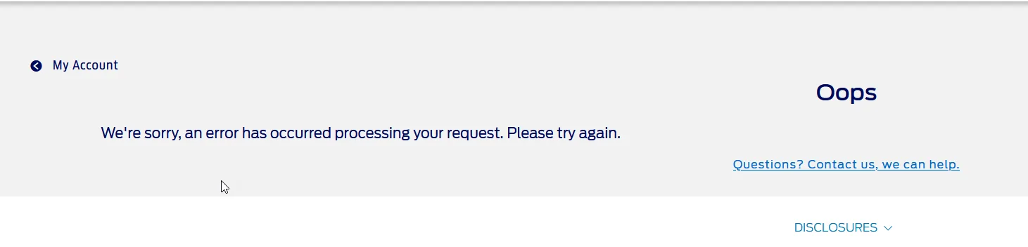

What you'll get if you click on "Reproccess Payment >"
Ford Mustang Mach-E Blueoval charge network error with electrify america 1662683951477

MessyJessie and ChuckA - You should call 800-334-4375 and open a ticket to get your issue addressed. They acknowledged that we are not alone. It will apparently "take some time" but they will open an "IT Ticket" to have the backend services teams take a look to see what has gone wrong.
I've got a ticket open and will wait to see how this goes.

@MessyJessie and @ChuckA - Quick follow-up: The ticket that I had opened did have some sort of effect. I was able to get onto the Ford.com site, verified that my default credit card on my Ford.com profile was set to the card that I wanted to use. I then went to my car and then "Connected Services", I found that the BlueOval Charging Network was still "on hold".
This time, however, I clicked on 'Manage' and the website worked! I was able to tell the site to reprocess the failed transaction (this occurred when my free charging credits ran out, apparently). The transaction completed successfully and now the BlueOval Charge Network shows as "Active" for my car again.
I hope that you both find success in your efforts to fix the issue.
