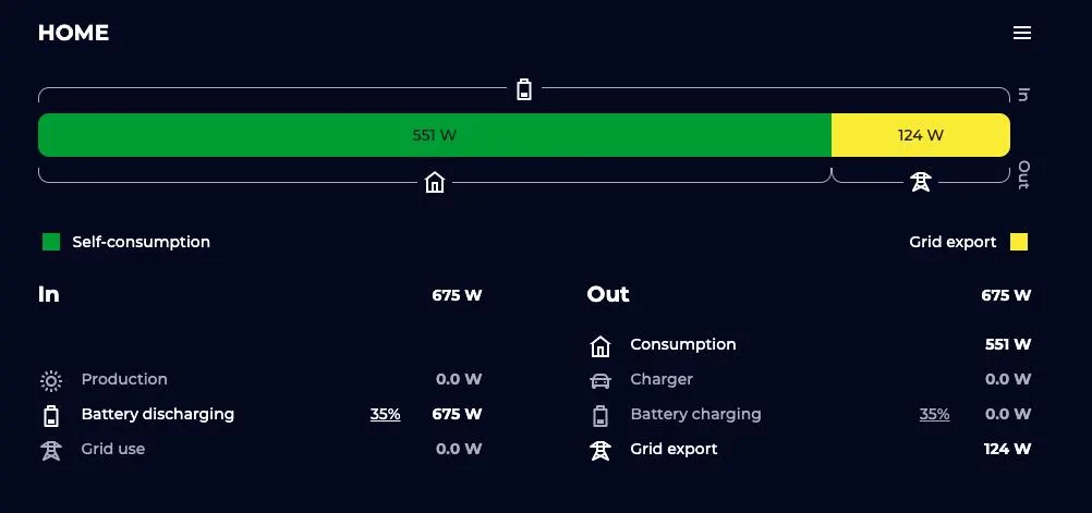

Meanwhile, I am able to get evcc to read Powerwall 3 status through Tesla's own API. Looks like a nifty tool.
