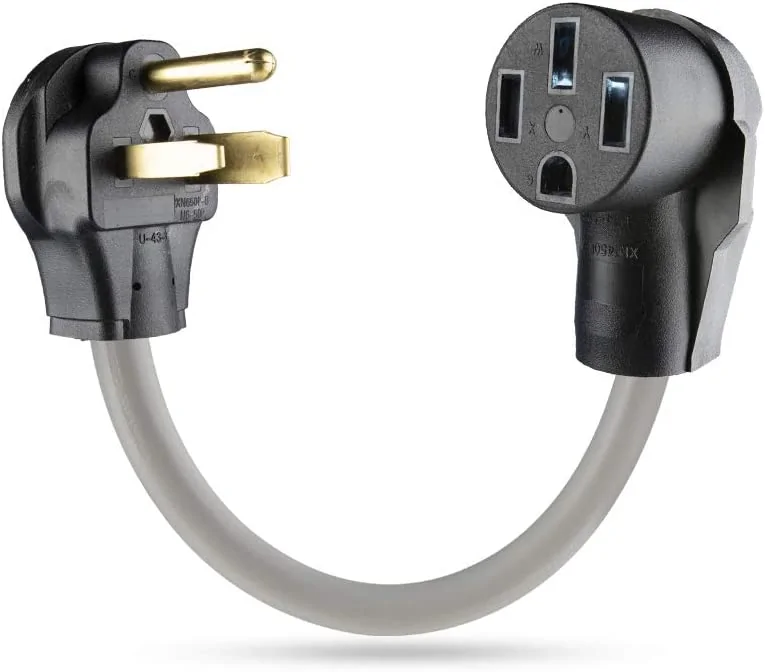

I have a 6-50 plug in the garage and a charger for it. As has been stated, ChargePoint, Grizzl-E and Clipper Creek and others can be ordered with that plug. If you want to use the mobile charger that comes with the MME, you'll need an adapter. Something similar to this:
Yeah that's what I'm going to do. I've got the 6-50 plug. I'm sure there will be some loss of amperage across the multiple plugs, but it's still going to be more than sufficient.
I'd instead recommend something like the Grizzl-E. I also just ordered mine. It's only $399 (granted it's still a lot), but if you order prior to the end of 2020, you can claim a 30% tax credit. Hard to beat for $279. That way you don't have to worry about plugging / unplugging the Ford Mobile Charger when you want to take it with you...
and I wouldn't be certain that the Ford Mobile Charger will work with that adapter. The NEMA 14-50 plug that it comes with provides BOTH 240 V and 120 V compared to the NEMA 6-50 only providing 240 V as the missing prong is the neutral line used to get 120 V.
Last point is that the Ford Mobile Charger recommends a GFCI breaker which you might not have, but the Grizzl-E (and other EVSE chargers) don't need as they have an internal one.
Most EVSEs don't use the neutral pin in a 14-50 receptacle. Therefore, such an adapter is OK.
However, be aware that such an adapter could easily damage the appliance and/or lead to a dangerous situation because the neutral pin in the 14-50 receptacle provided by the adapter will be floating.
I recommend getting an EVSE with available 6-50 plug.

If you don’t have anything that requires the continued use of the 6-50 outlet, I would just swap it for a 14-50 outlet. Very easy to do.
You would have to run an extra wire for the neutral.
If I have to choose between 6-50P/14-50R adapter and a 14-50 receptacle with floating neutral. I'd pick the adapter without hesitation. With an adapter, it's obvious to you and to future owner/resident/electrician of your home what's going on.
If I have to choose between 6-50P/14-50R adapter and a 14-50 receptacle with floating neutral. I'd pick the adapter right away. With an adapter, it's obvious to you and to future owner/resident/electrician of your home what's going on.
A NEMA 14-50 outlet with a 'floating neutral' would be a code violation. The neutral is there to allow for 120 V loads. So a load with that plug might expect to use 120 V which would result in improper operation.
