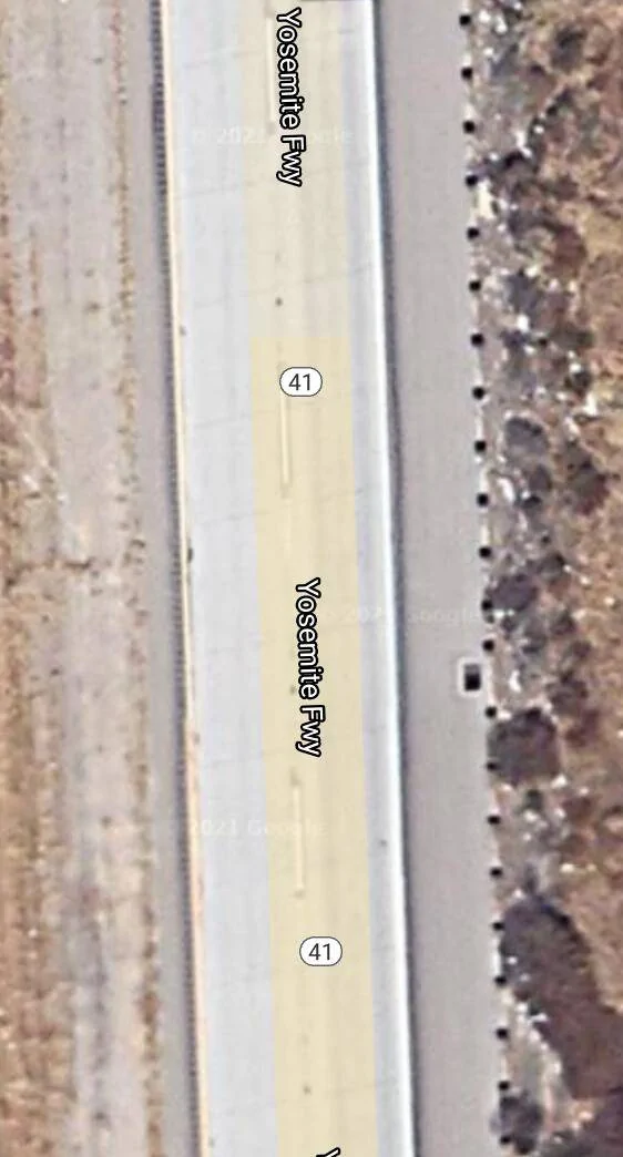

I have isolated the bounciness/galloping to more-or-less a known 3 mile stretch of highway. The concrete slabs in this stretch are not that far apart, this consistent difference between the slabs causes a consistent frequent bump which causes the suspension to hit a harmonic bounce/gallop. I am open to downloading any recommended apps and running tests to confirm / gather more data. Can even buy certain things to help figure out how to fix this. Should I buy GT springs? Let me know what I should try and if it's of a reasonable price, I'll do it.
Here is a satellite screenshot of the highway (location pin). You can make out the concerete slab sections. If needed, I can measure out their distance. I'm sure that Ford would be able to replicate this on a track.
My office is about a mile from that pin. Luckily for me I don't have to take the 41 to get there.
