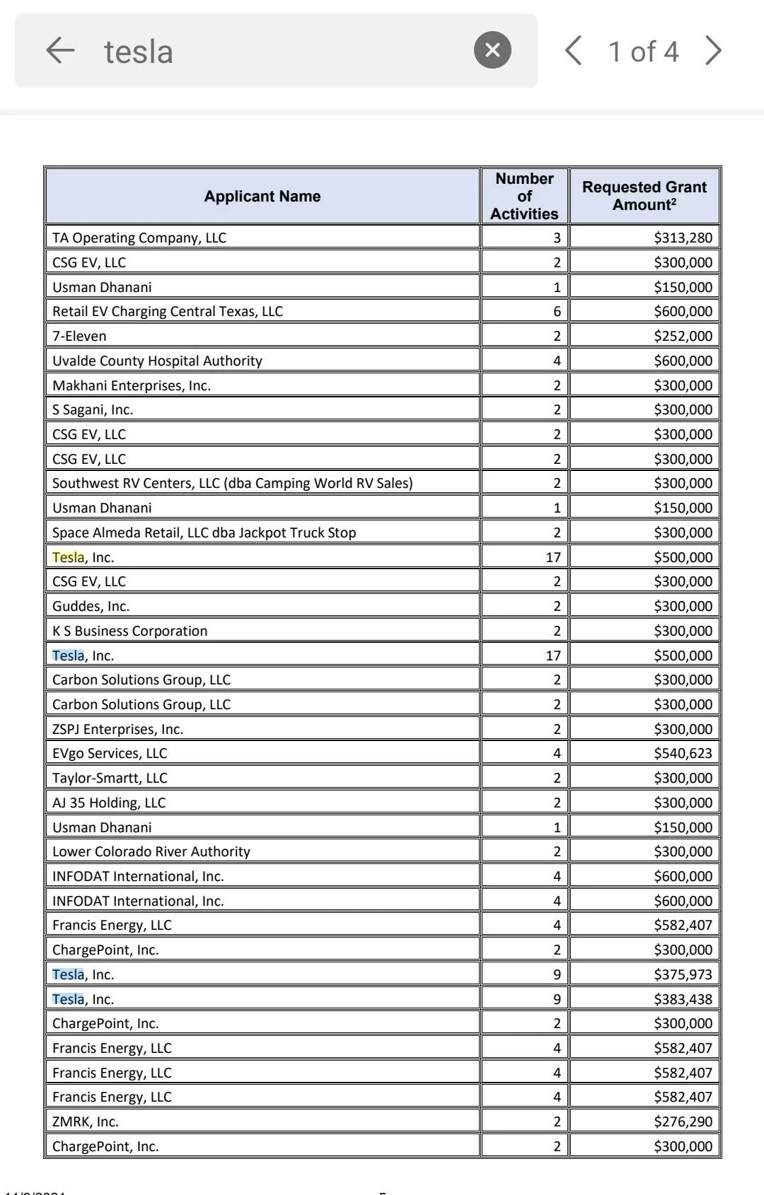

Yep I have read both articles when they came out. The only source is a table on a Texas Gov't website that was probably populated by some intern. Nowhere does it say that is the cost of a Tesla charger, it's just how much they are requesting per charger. Hell, it might only cover the cost of adding a CCS dongle to an existing charger. Forbes, InsideEvs, and you are reading way too much into it.
