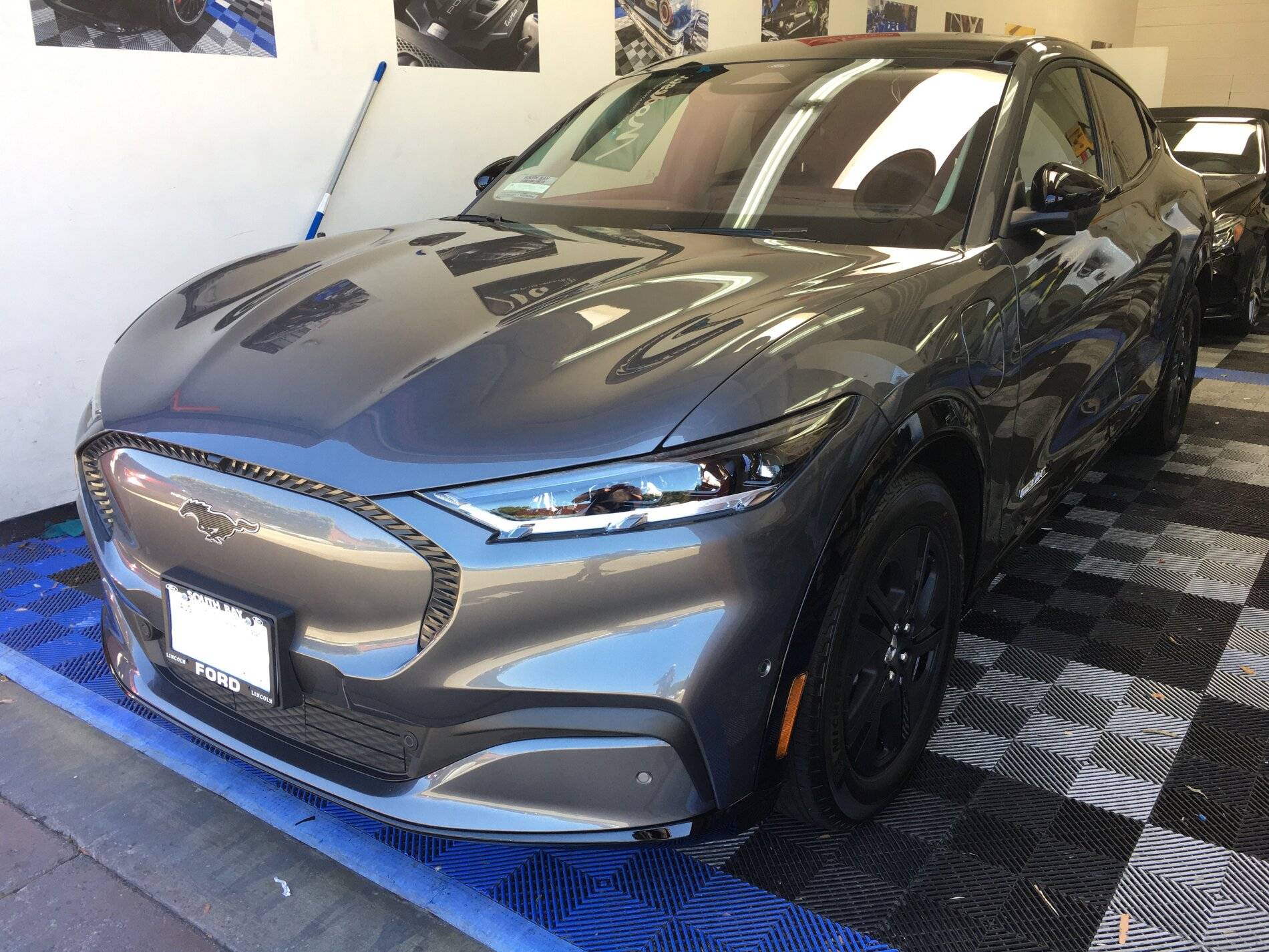

I got mine professionally ceramic coated with GTECHNIQ Crystal Serum Ultra on day 3. They did all the prep steps: wash, clay, clean, etc. before applying the ceramic coat. It cost about $1500 but comes with a 9-year warranty and includes annual "check ups" where they essentially do a full detail wash and vacuum. That's worth at least $125 a pop around here, so I didn't think the price was too bad.
I briefly thought about doing it myself, but I watched the guys work on if for a while and I'm glad I didn't try it. When I mentioned doing it myself to the owner of the shop he said "You could pull your own tooth, too."
The final result was very ... shiny.
