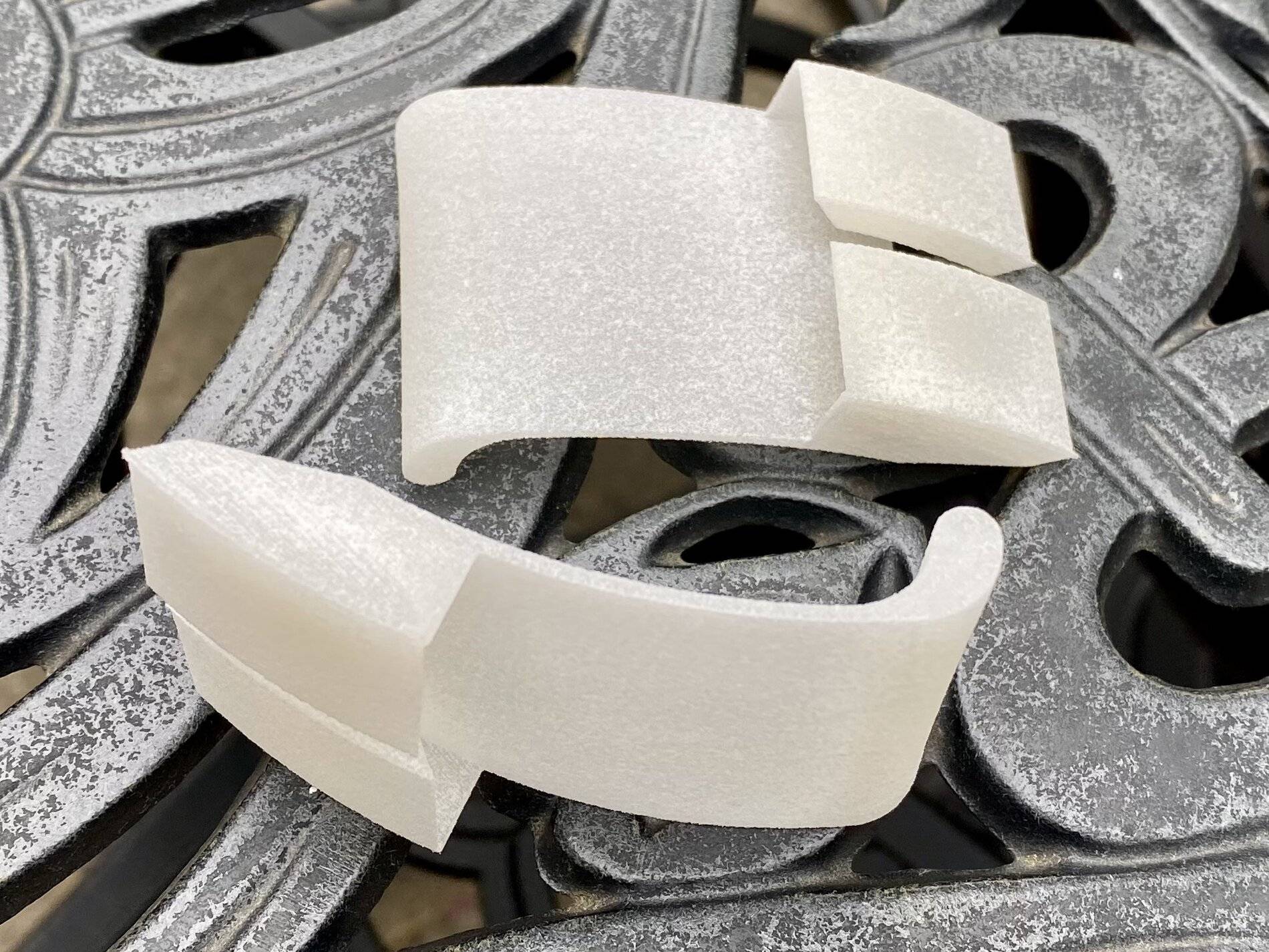

Quality looks good. IIRC, your friend has the same printer as mine. If he is printing the TPU directly on glass he may from time to time experience some bed adhesion problems at the skinny end that is the actual wedge. I uploaded a version with an in-built partial brim, which solves the problem without making it hard to clean up (vs. a normal slicer generated brim, that can sometimes need to be razor-knifed off).

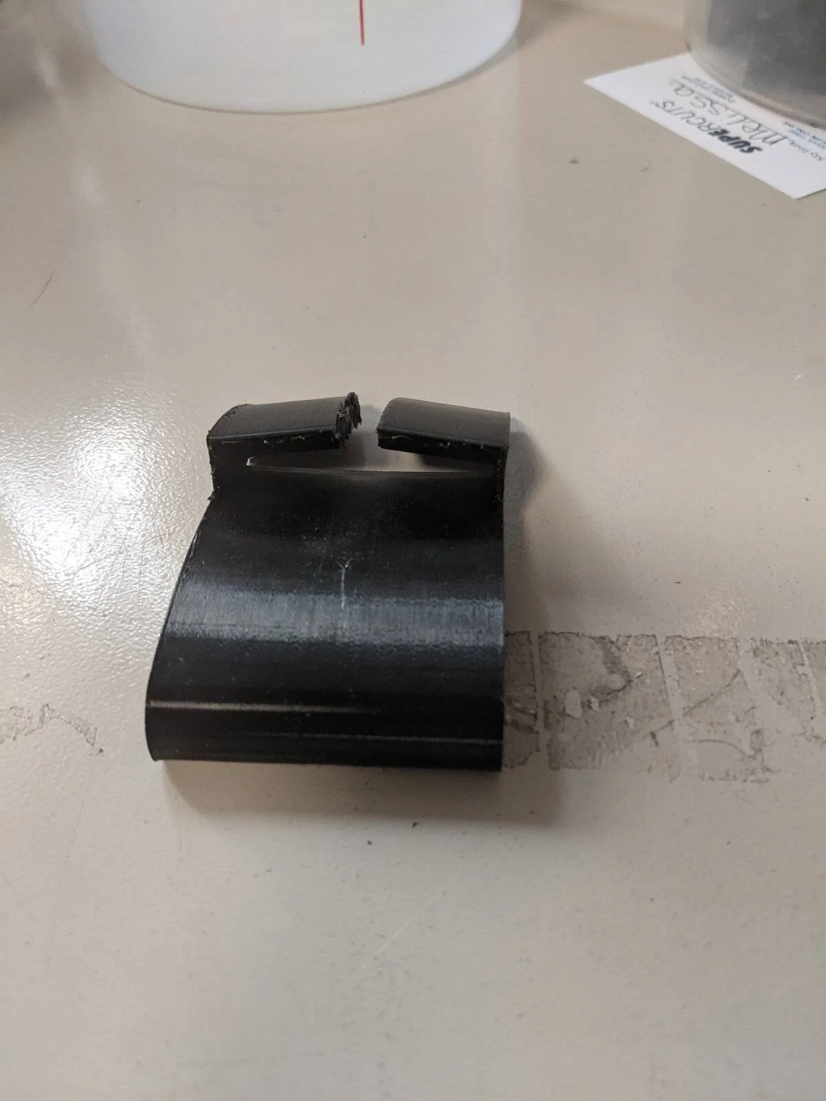

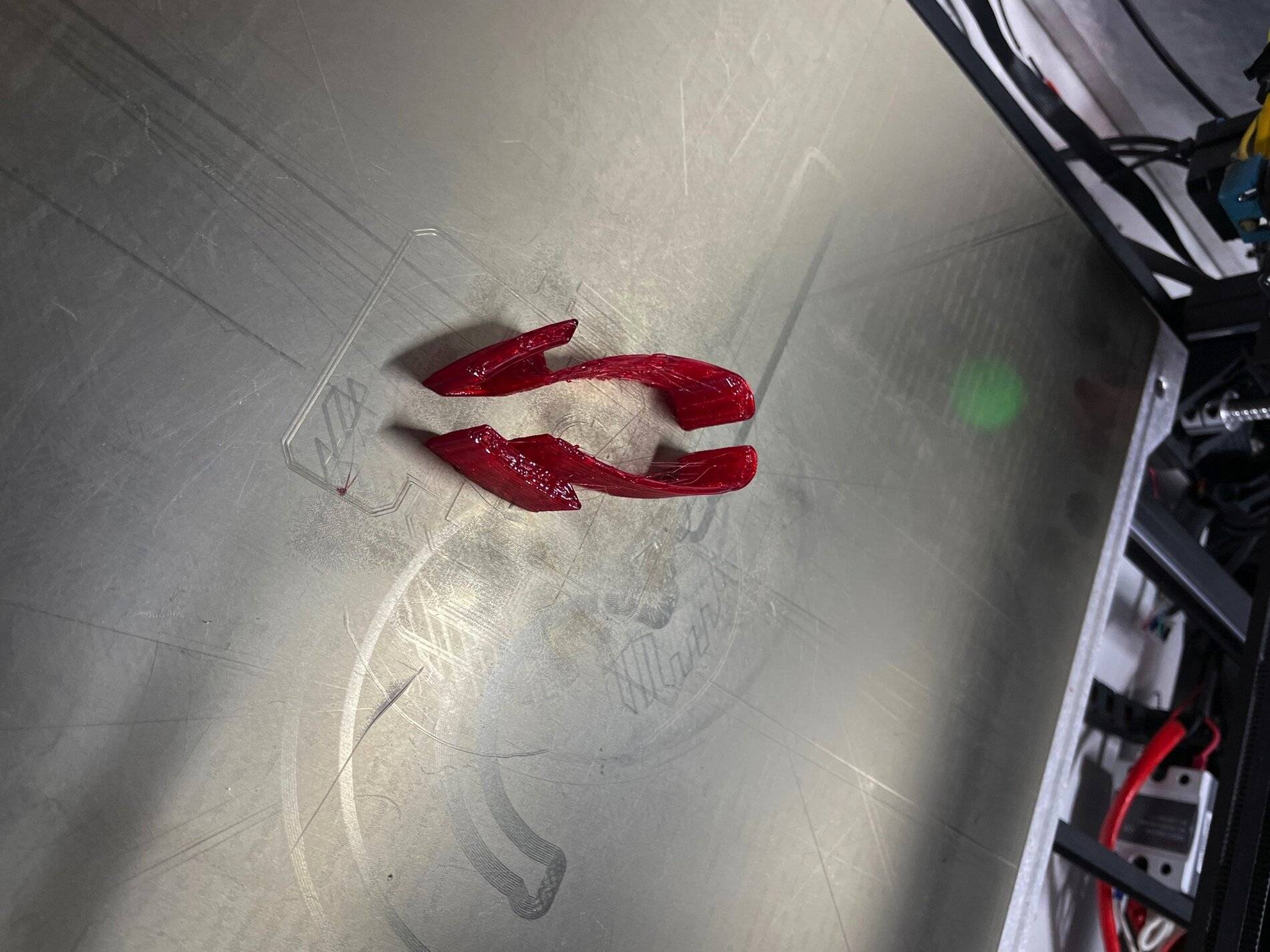

I tried 4 or five variants today, this part is a little trickier to print with a 0.8mm nozzle due to the thin walls. Also the thin walls made it impossible to use PETG or PLA as a support since it kept just melting together since the TPU is so runny. I finally found something I'm pretty happy with, just need to iron out the retraction setting to get it a little smoother. I split the model in half and printed it with no supports, then I used a 3D printer pen to weld the two halves together. It prints much faster with no supports and welding it together is quicker and easier than cleaning up the supports. Once welded I couldn't yank it apart and it's working perfectly in the wife's car right now.
I put on a half dozen red ones to printer over night and will start on black ones next.

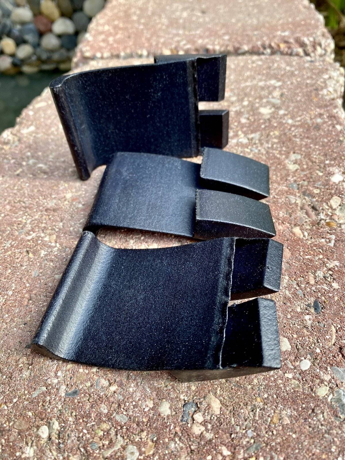

Ford Mustang Mach-E Charge Port Cover Dent Prevention – 3D Printed DIY Solution Split
Ford Mustang Mach-E Charge Port Cover Dent Prevention – 3D Printed DIY Solution Welded

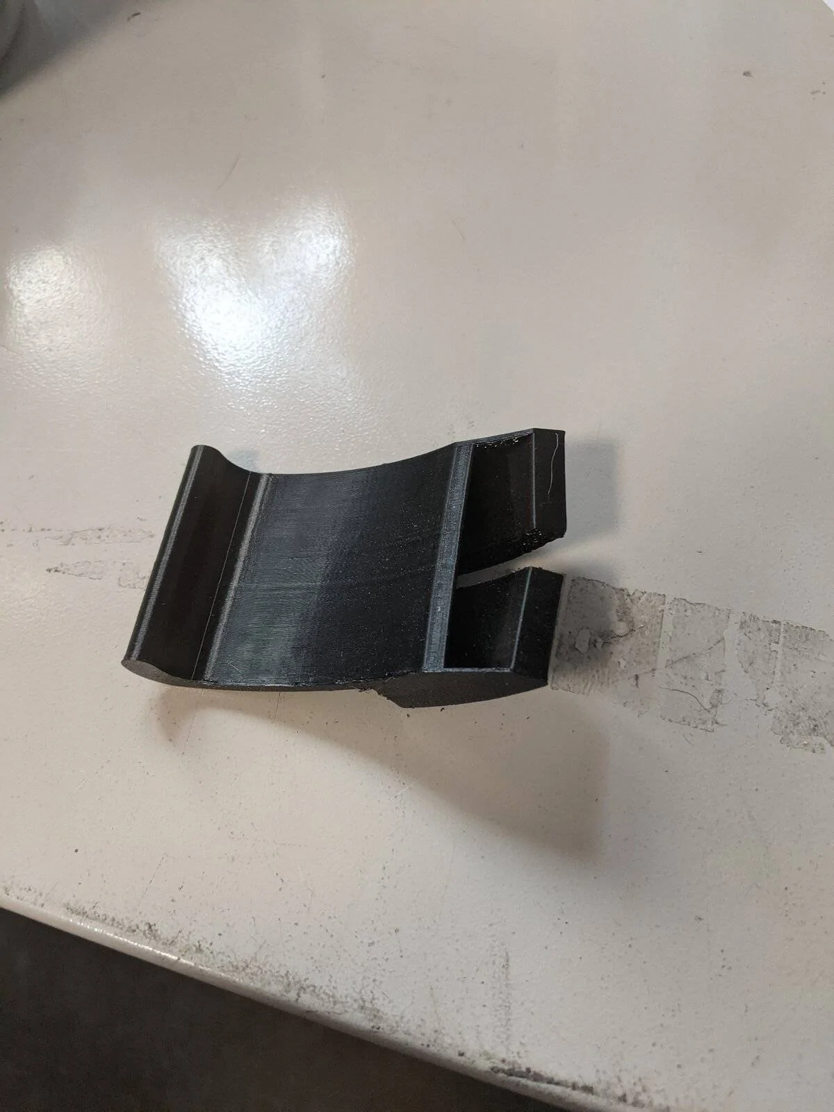

Back home and printed a test black one using the dissolvable supports, it worked very well. I'm printing a batch of 8 now so the black ones that were requested will start shipping tomorrow. Red ones went out Saturday.

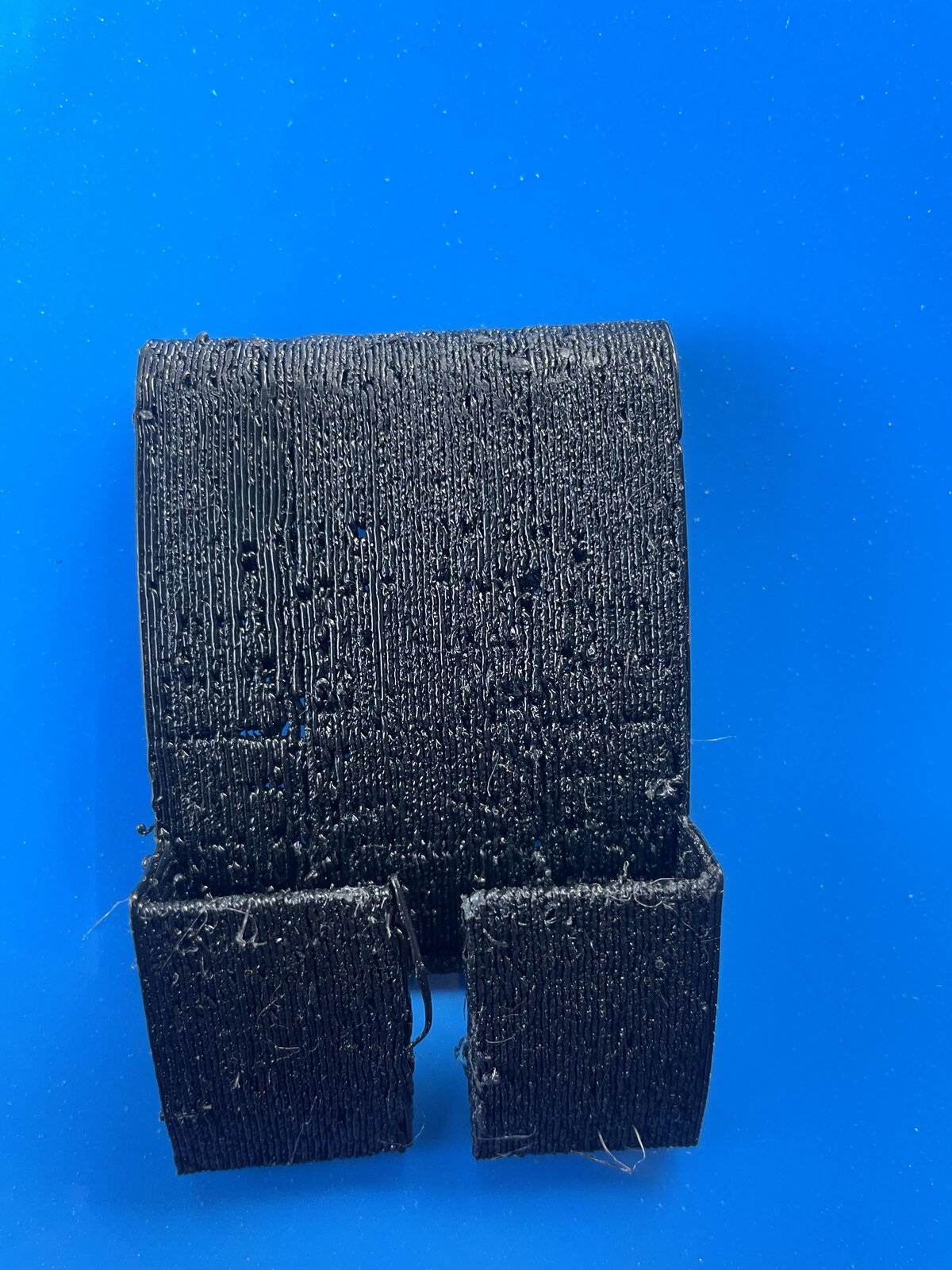

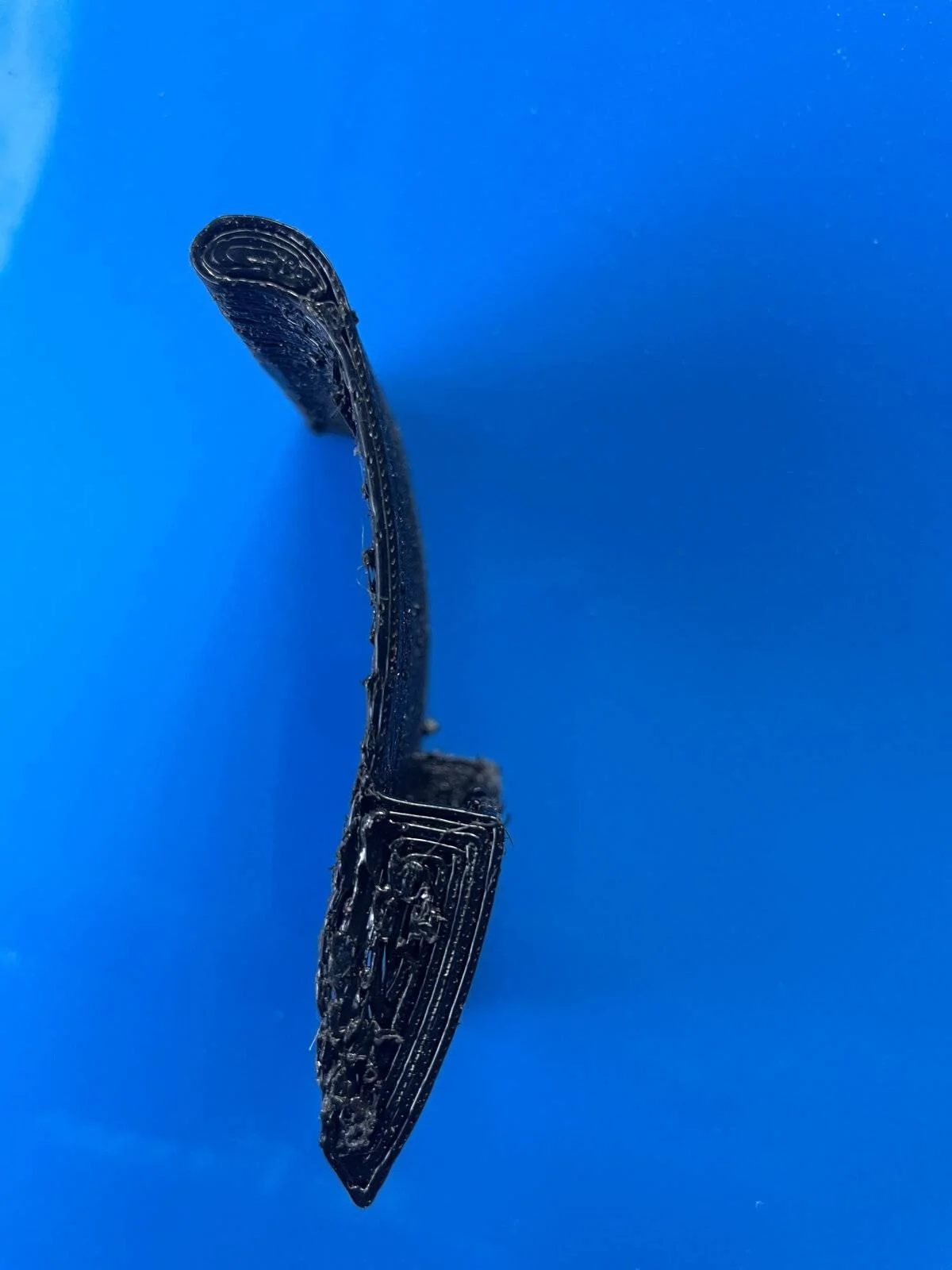

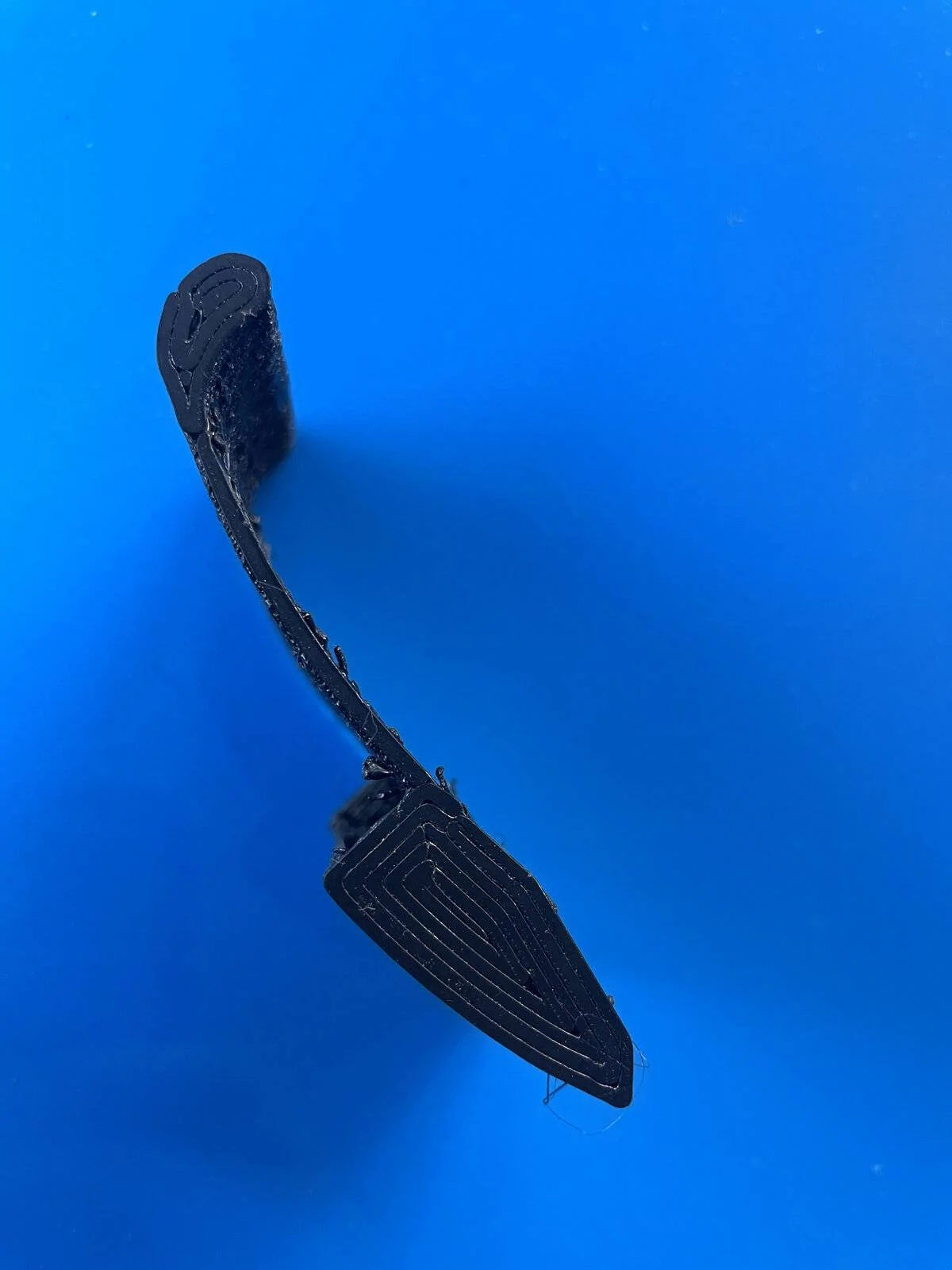

Thanks for sending one of these along. Here are some photos I took of it.
Ford Mustang Mach-E Charge Port Cover Dent Prevention – 3D Printed DIY Solution IMG_9557
Ford Mustang Mach-E Charge Port Cover Dent Prevention – 3D Printed DIY Solution IMG_9558
Ford Mustang Mach-E Charge Port Cover Dent Prevention – 3D Printed DIY Solution IMG_9559
Ford Mustang Mach-E Charge Port Cover Dent Prevention – 3D Printed DIY Solution IMG_9560

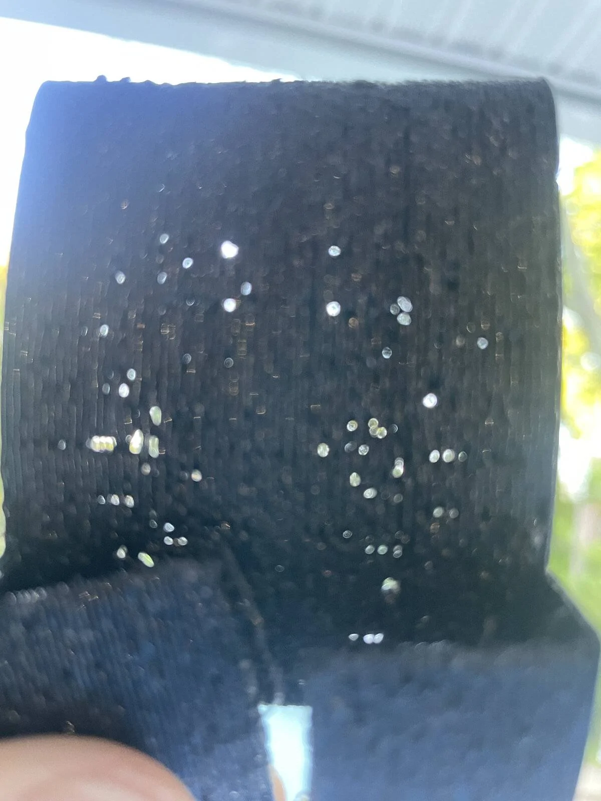

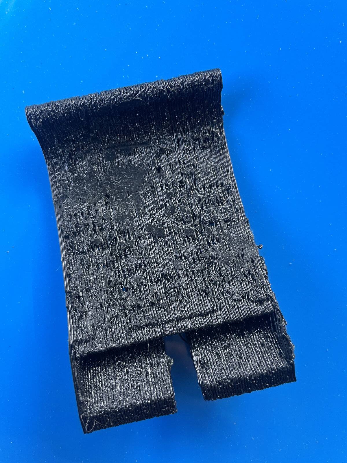

This last one is a bit fuzzy but just points out is is pretty solid but with some porosity.
Ford Mustang Mach-E Charge Port Cover Dent Prevention – 3D Printed DIY Solution IMG_9561
I found one edge to be pretty smooth but others have a bit of a "rough" texture. Of course, it is a very soft rubbery material.
I installed and tried it.
Good news: It does seem to prevent the charge port door from impacting the car body.
Bad news: It seems to bind a little as I closed the door, increasing resistance and making it harder to close the door. I'm wondering if the "rough" texture is causing it to catch as the hinge arm slides into the car body.

I suspect that the tough to close has more to do with my print running on an 0.8mm nozzle instead of a 0.4mm nozzle, which results in a slightly thicker part, that with the texture. I did notice it was a little harder to close, but not enough that my wife complained. If your's is unusable as is, let me know and I can have my buddy print them on a 0.4mm nozzle just so I can test the difference for myself.
