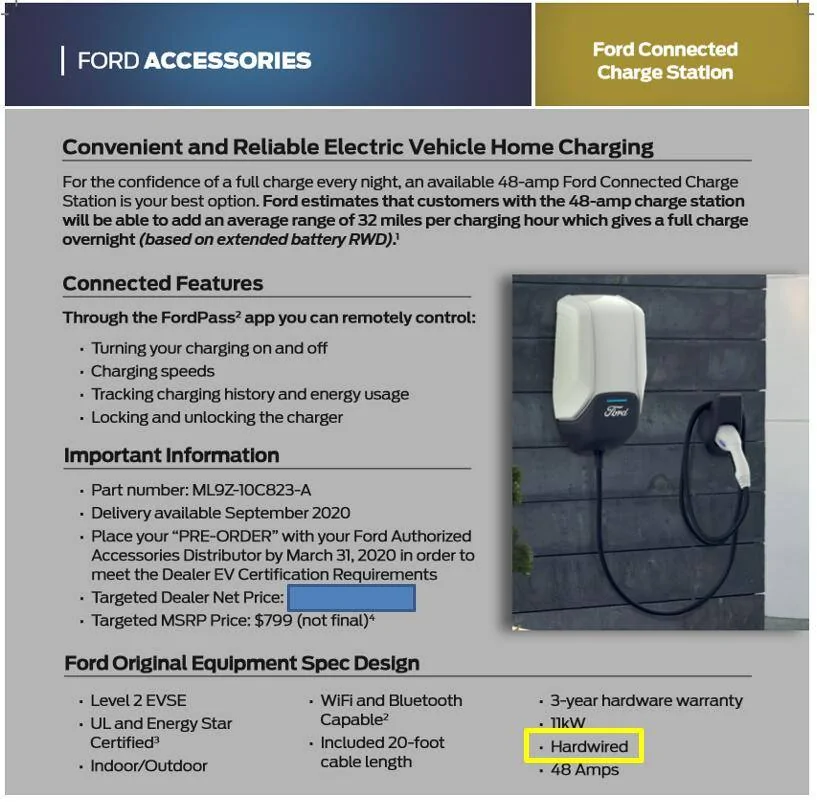

Ford Connected Charging Station is hardwire only. This is an older pre-COVID form so the dates are off, but the specs are the same.
Thanks. That makes sense because a 48Amp EVSE needs a 60Amp breaker and those historically are hardwired, not connected to a 14-50 outlet. I'm looking more at the ChargePoint EVSV on Amazon not just because it is $100 cheaper but being able to unplug and haul around is appealing although I won't do that often.
I am using a 14-50 outlet to start. However, the wire and breaker are at 60 amp - this way I can hard wire the Connected Charger (or some third party) later (just remove 14-50 outlet and hard wire into the correctly sized wire) if the 21 mile per hour charge I get through the mobile charger is not sufficient.

You are conflating 2 different things. There is a plugin level 2 AC charger that comes with the car for home charging. There is a hardwired level 2 AC home charger for $800 that chargers at home faster than the free one.

To use the Ford connected charging station 48amps, what is the minimum circuit it will run safely on? I'm guessing 60 and not 50?
50 amps is just fine. I have installed two of them in my garage.
24,610
That's definitely not to code to run a 48A charger on a 50A circuit unless you are using 100% rated breakers. Most breakers are 80%.
Made to code and inspected by the county inspector specifically for EV charging.
