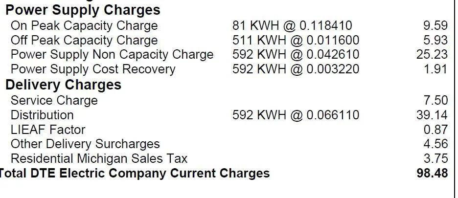

We're talking about two different things. @RedStormREHS was saying how many kWh he sent from the wall to the car. I was pointing out that his car received 12% less kWh than was sent to it (not unusual to have a 7 - 15% loss. Same is true when you DC fast charge. You paid for 50kW, and your car gets 46.5.
As to the cost of that electricity at home, yes, people need to look at every variable cost they get charged on the bill. Many have just one fixed cost - a monthly customer charge or meter charge. Then there can be 1/2 dozen variable costs, including generation, delivery, paying for investments like a nuclear plant, etc. Some have a higher unit cost when they exceed a certain amount of usage, and that marginal cost should be used. And then there is sales tax.
Here's my bill for a given month. All my vehicle charging is done off-peak.
So my low $0.0116 per kWh cost has to have added to it $0.0426 plus $0.00322 plus $0.066110, plus a portion of LIEAF Factor and Other Delivery Charges, plus sales tax. That takes my 1.16 cents to over 12 cents.
I agree, I see lots of really low electricity costs and wonder if they are including delivery cost. I think my current cost is closer to $.23 KWH. My mistake, I took my recent bill divided by KW used and I am paying $.17/KWH out the door.
