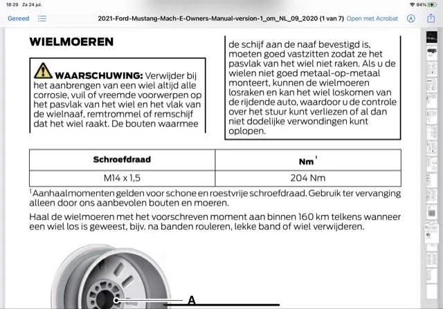

I forgot to check the lug nut torque after I had put 100 miles on the Mach-E.
I remembered it after 300 miles.
The recommended lug nut torque specification is 150 lb-ft.
All of mine were loose between 1/3 and 1/2 turn.
That is the highest torque I have seen on a car.
My 2013 Fusion Energi was 100 lb-ft.
My 2016 Tesla is 129 lb-ft.
