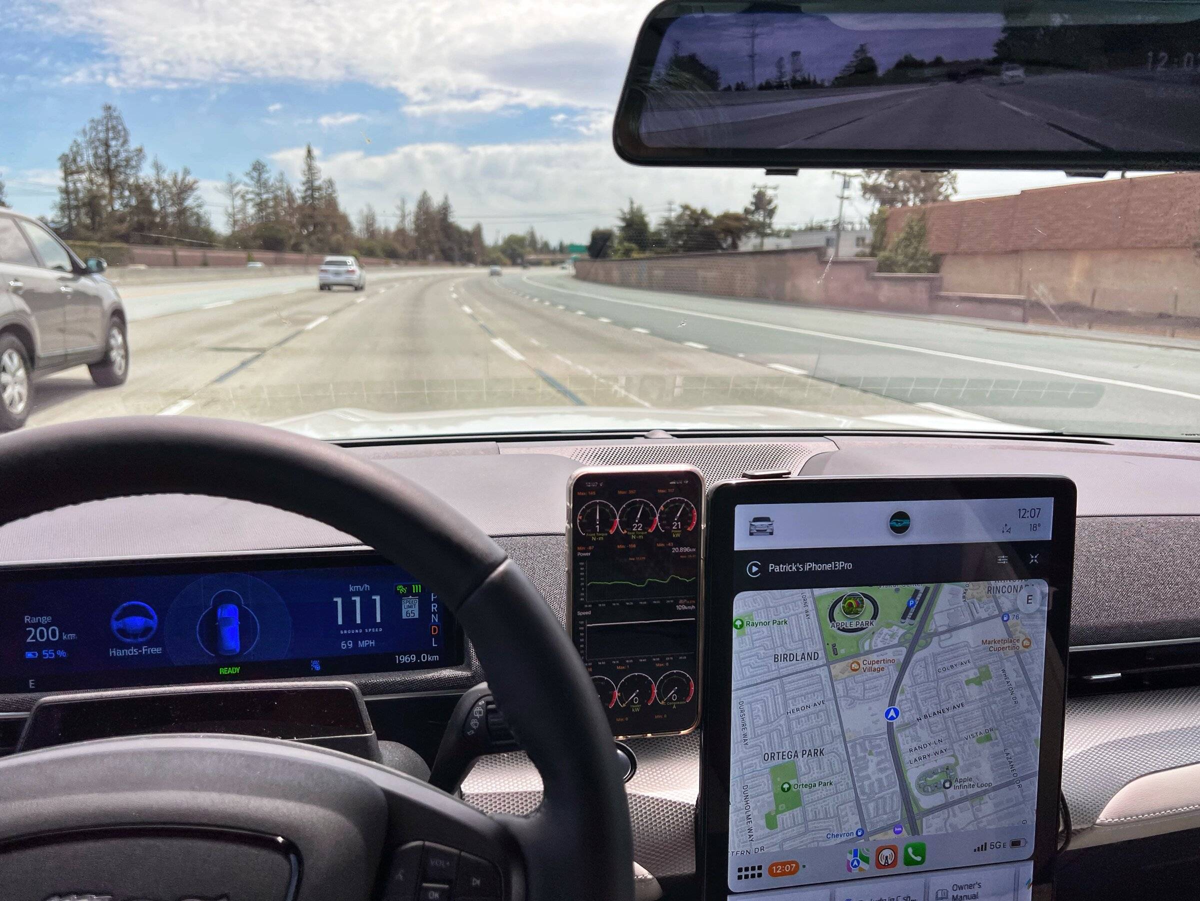

- Hands-free BlueCruise driving is disappointing. Basically, BlueCruise is just hands-off lane-centering on highways. On hwy280 and hwy560 here in Silicon Valley, I was rarely more than 2 minutes in hands-free mode before being downgraded to hands-on lane-centering. Then 30 seconds later it is back on... Perhaps it does better on empty highways without curves and hills, but over here the experience is poor.
