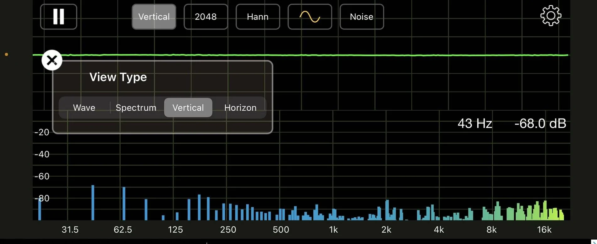

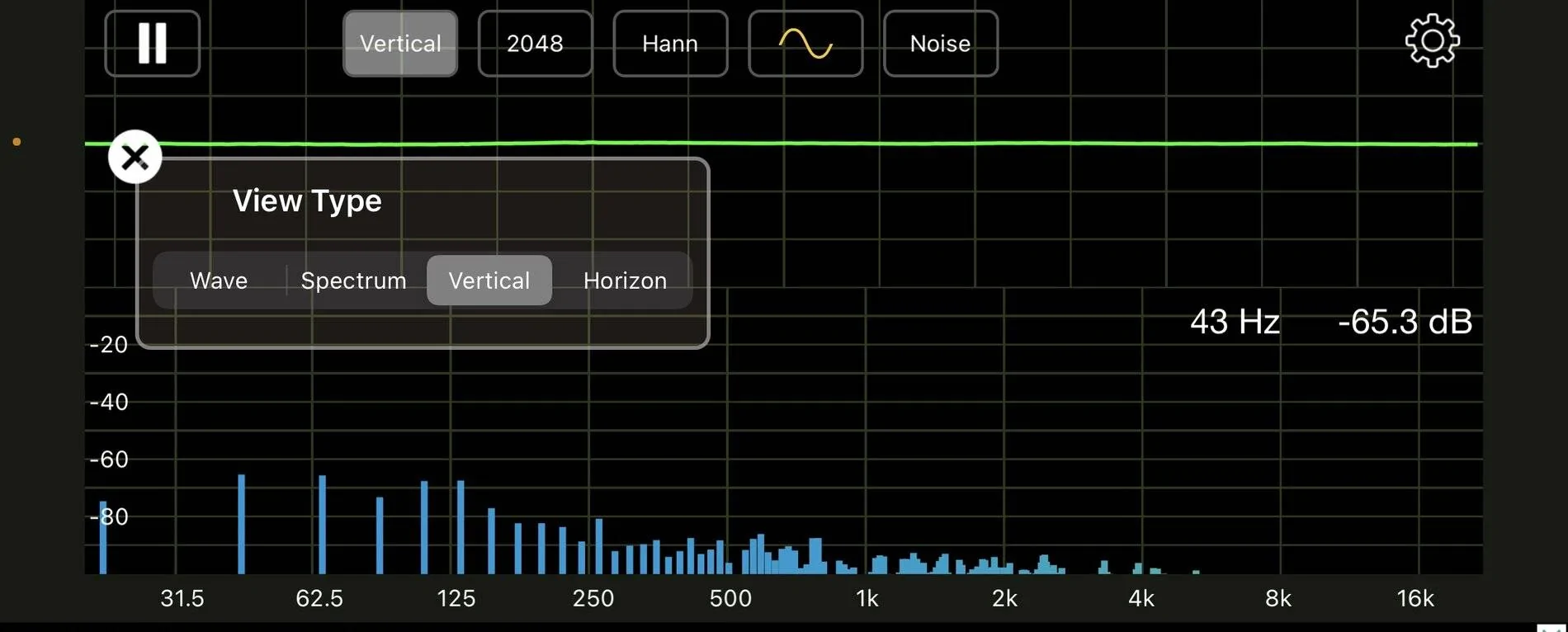

Its just another sound. Just posting this again, here us the spectral analysis of the sound, its most probably PWM noise.
Spectral analysis makes a pretty picture, but if you can post that, you should be able to post a couple of simple audio files. I can't hear a picture, but maybe it is just me.
If I could actually get at a MME with that problem, I'm sure I could record it.
Sure, let me try to record it.
