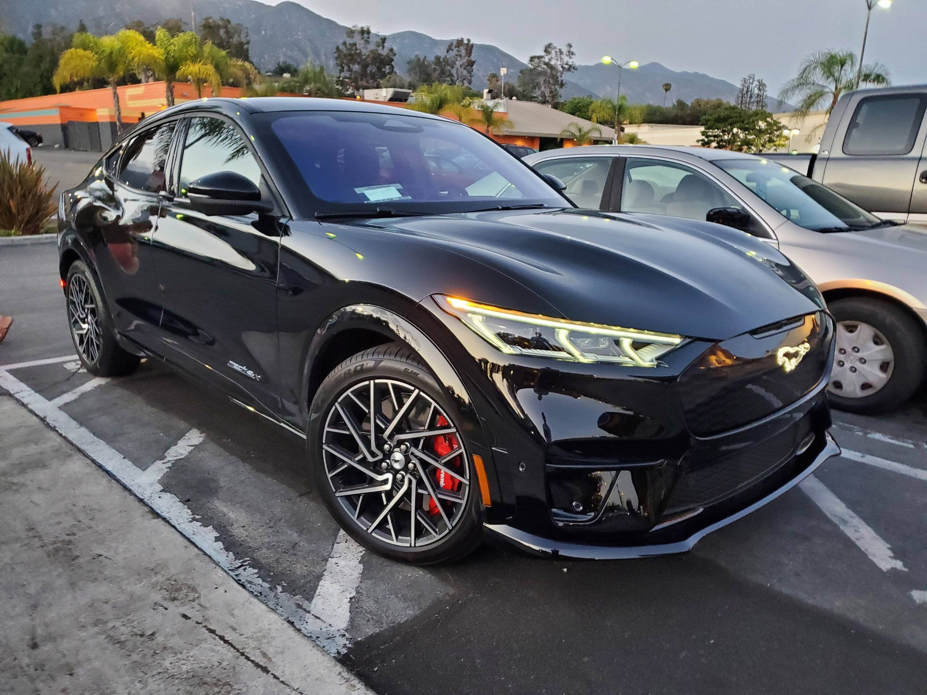

Fitment | Model name | Photos/Proof | Price | Link |

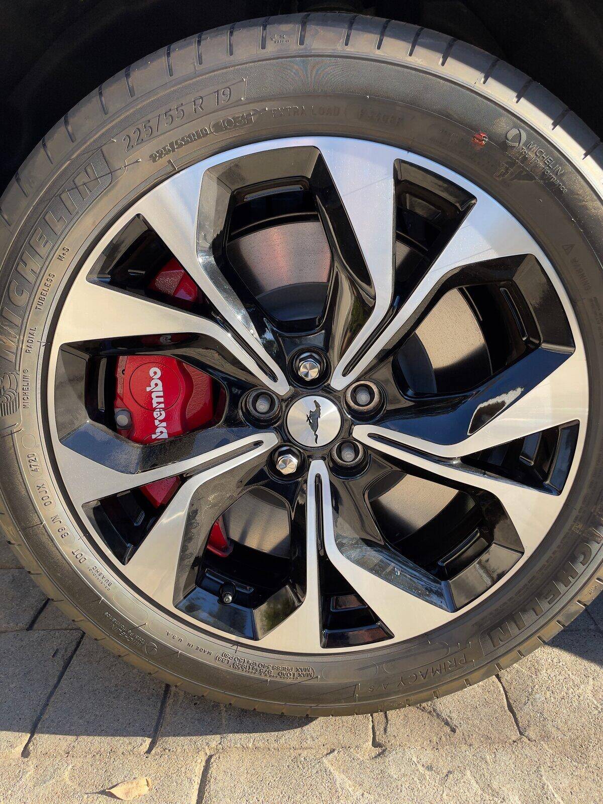

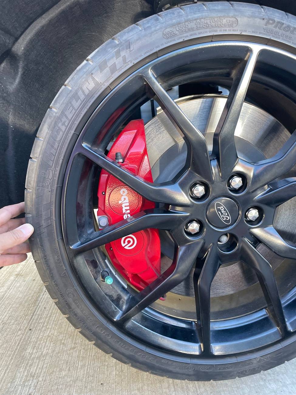

Confirmed fit | Mach-E Premium stock 19" | From thread: https://www.macheforum.com/site/threads/mach-e-gt-performance-edition-wheel-question.9451/ | $500-$1000 each - as of posting, listed for $858.12 on Ford Parts. | https://parts.ford.com/shop/en/us/wheels-and-tires/wheel-parts/wheel-13292553-1?pdp=y |

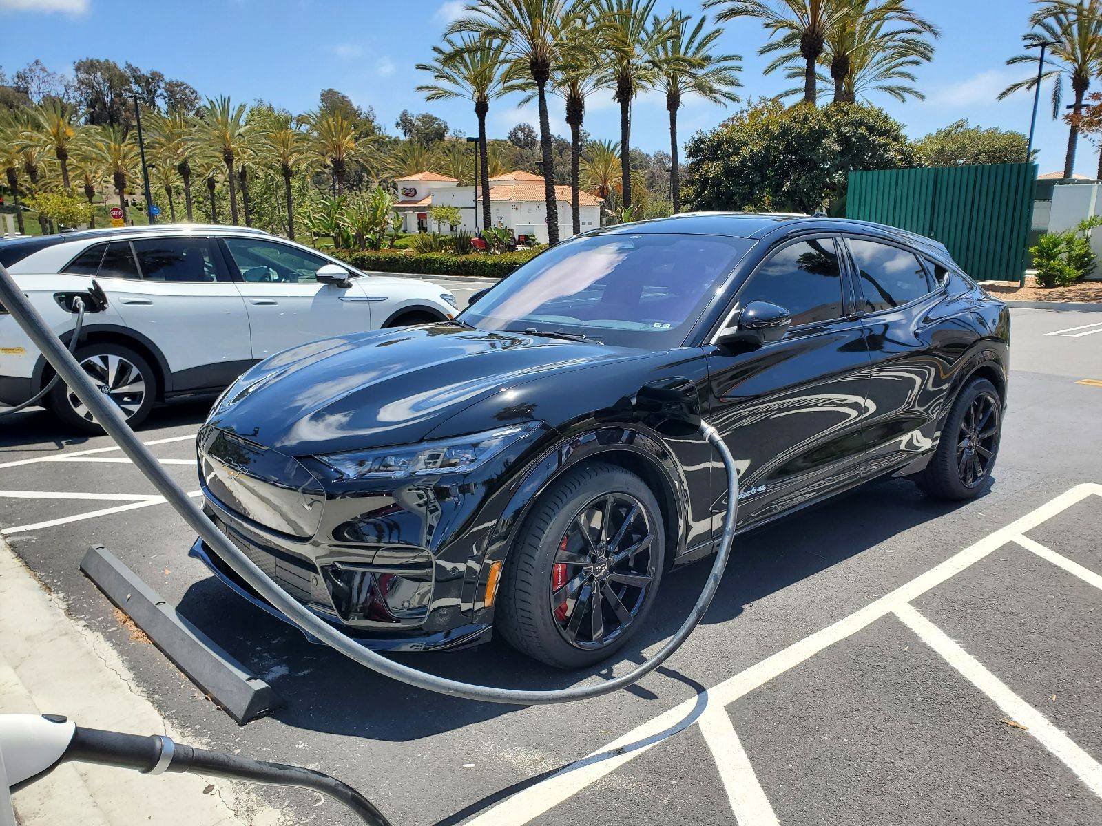

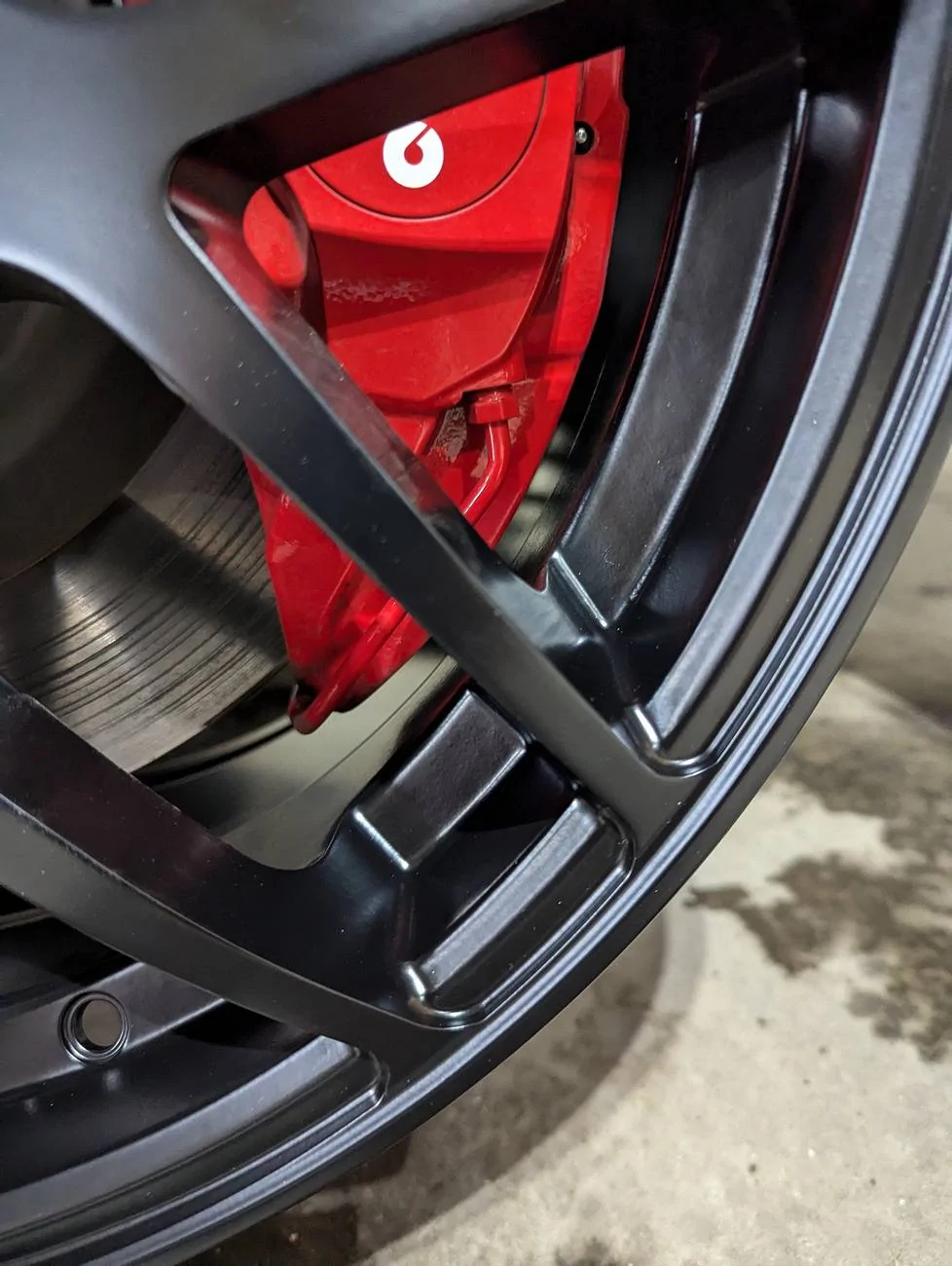

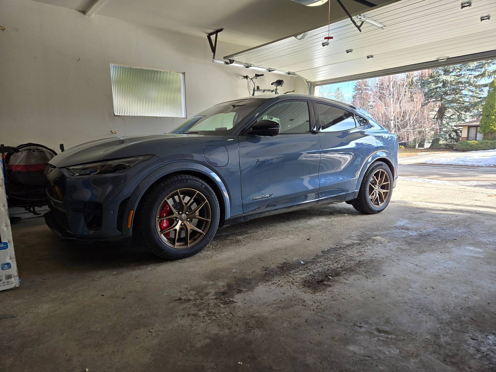

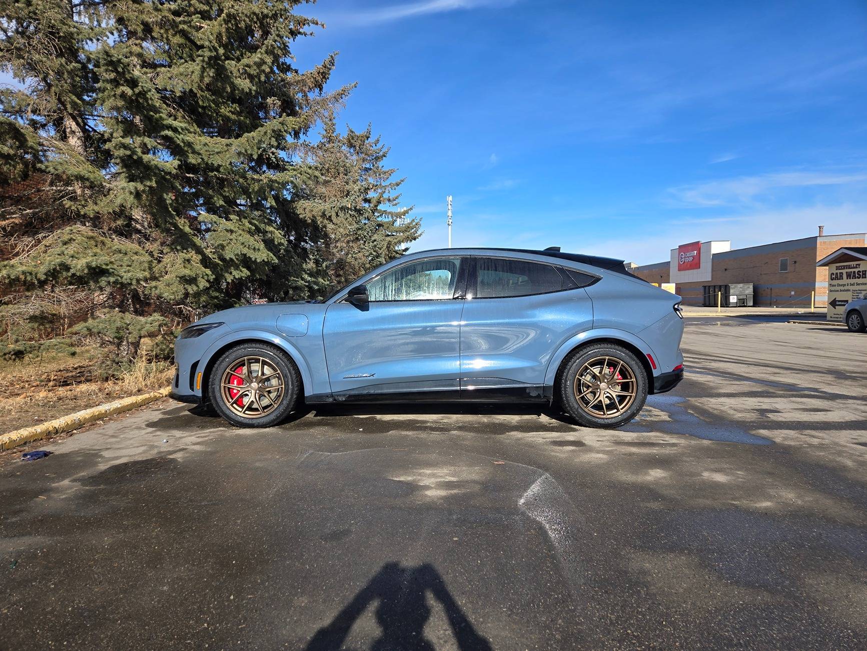

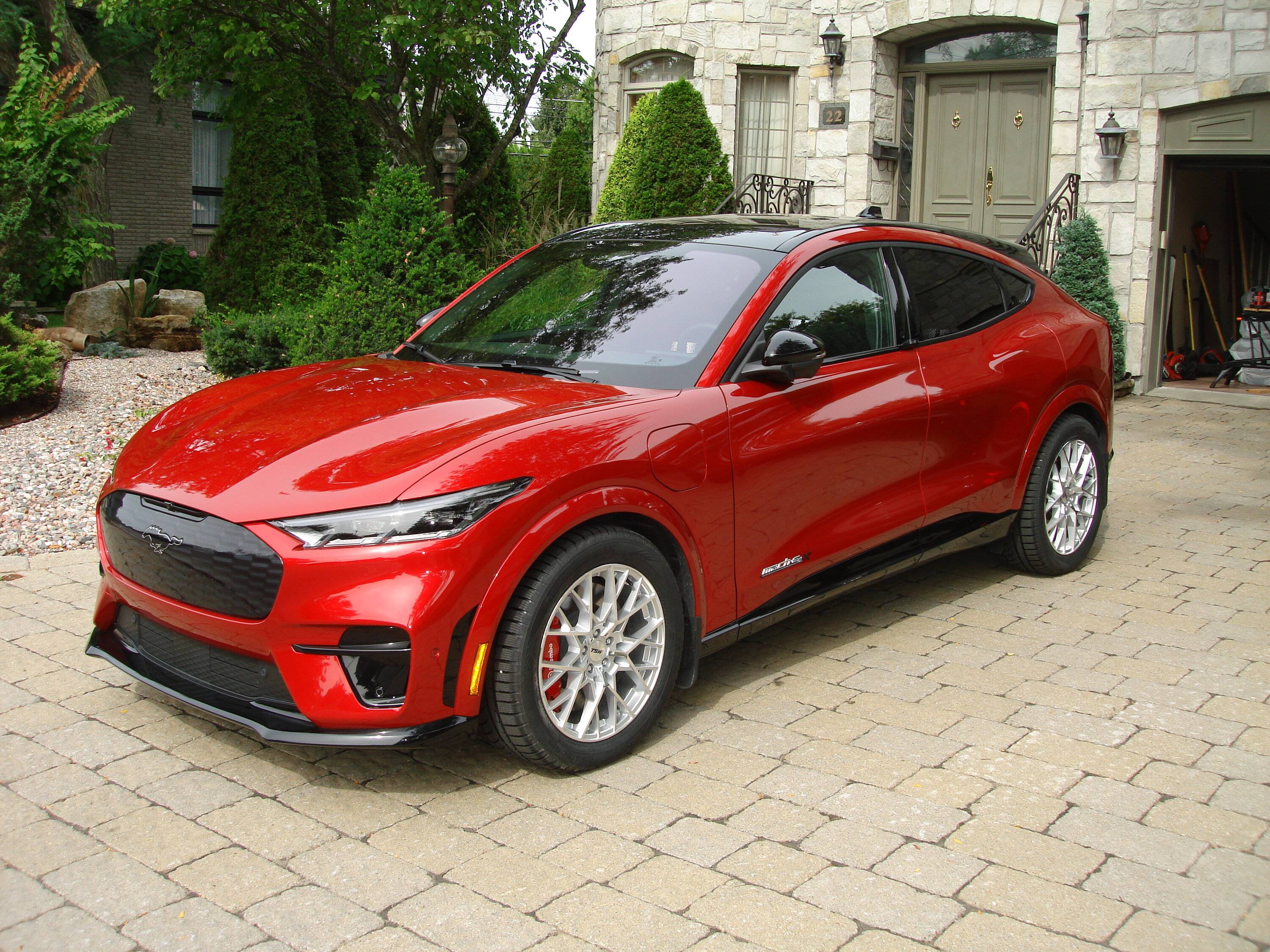

Confirmed fit | Fast Wheels EV01(+) Titanium - 19x8.5 or 19x7.5 |
| $309.00 each | https://wheelhaven.com/en-us/products/fast-wheels-ev01-titanium-19x8-5-40-5x108mm-63-4mm |

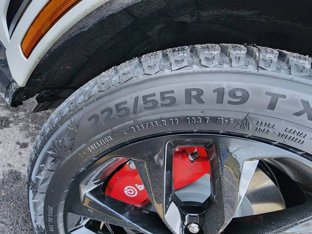

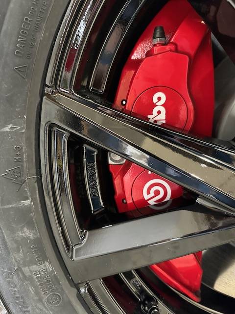

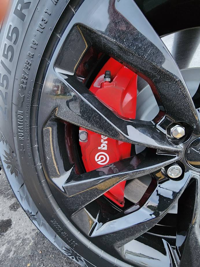

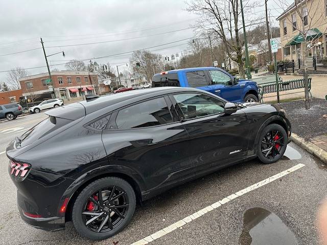

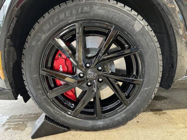

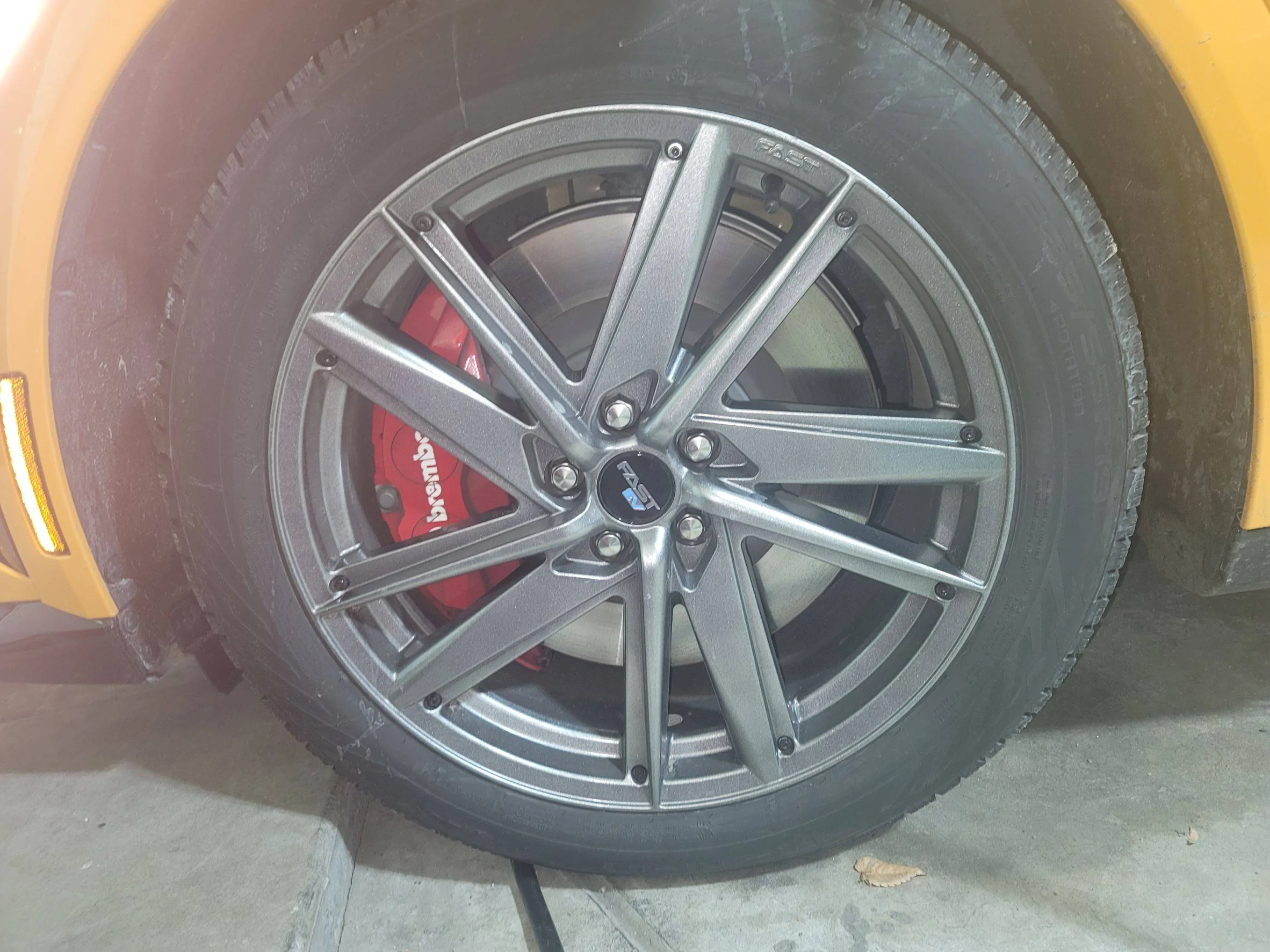

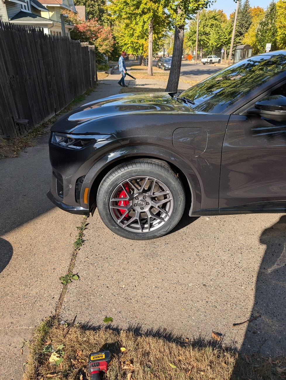

Confirmed fit | MSW Type 80 5-Lug 19x7.5 | Installed 2023/01/13 Pictured with 225/55R19 Michelin X-Ice Snow SUV tires ($236 each at TR as of 1/13/23) | $241.30 each - as of posting 2023/01/13 on TireRack.com | Product Page on TireRack.com |

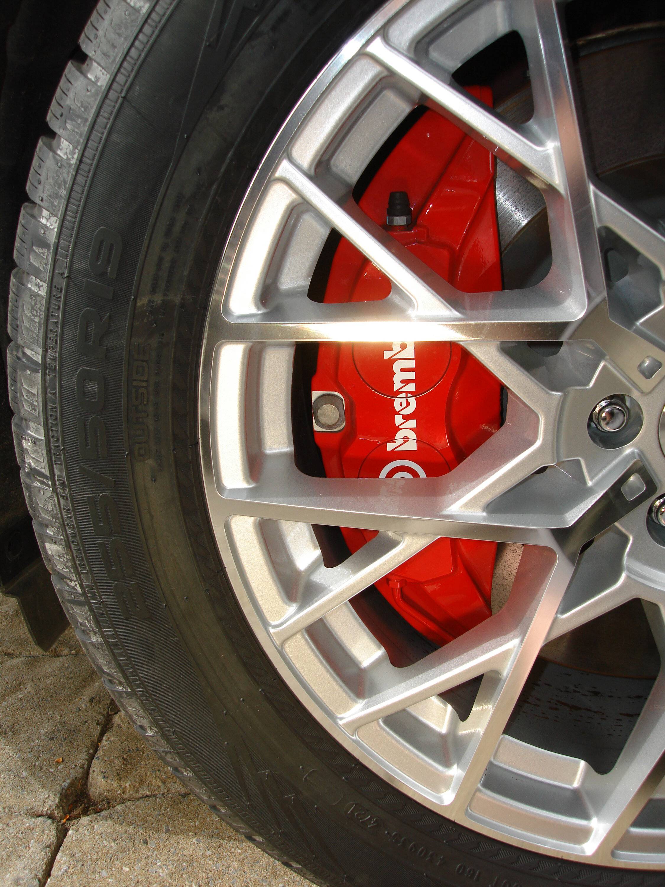

Confirmed fit | MSW Type 74 5-Lug 19x8 | From thread: https://www.macheforum.com/site/threads/ordered-19x8-winter-set-for-my-gtpe.21819/ Pictured with 225/55R19 Michelin X-Ice Snow SUV tires ($236 each at TR as of 1/13/23) | $225.00 each - as of posting 2023/01/13 on TireRack.com | Product Page on TireRack.com |

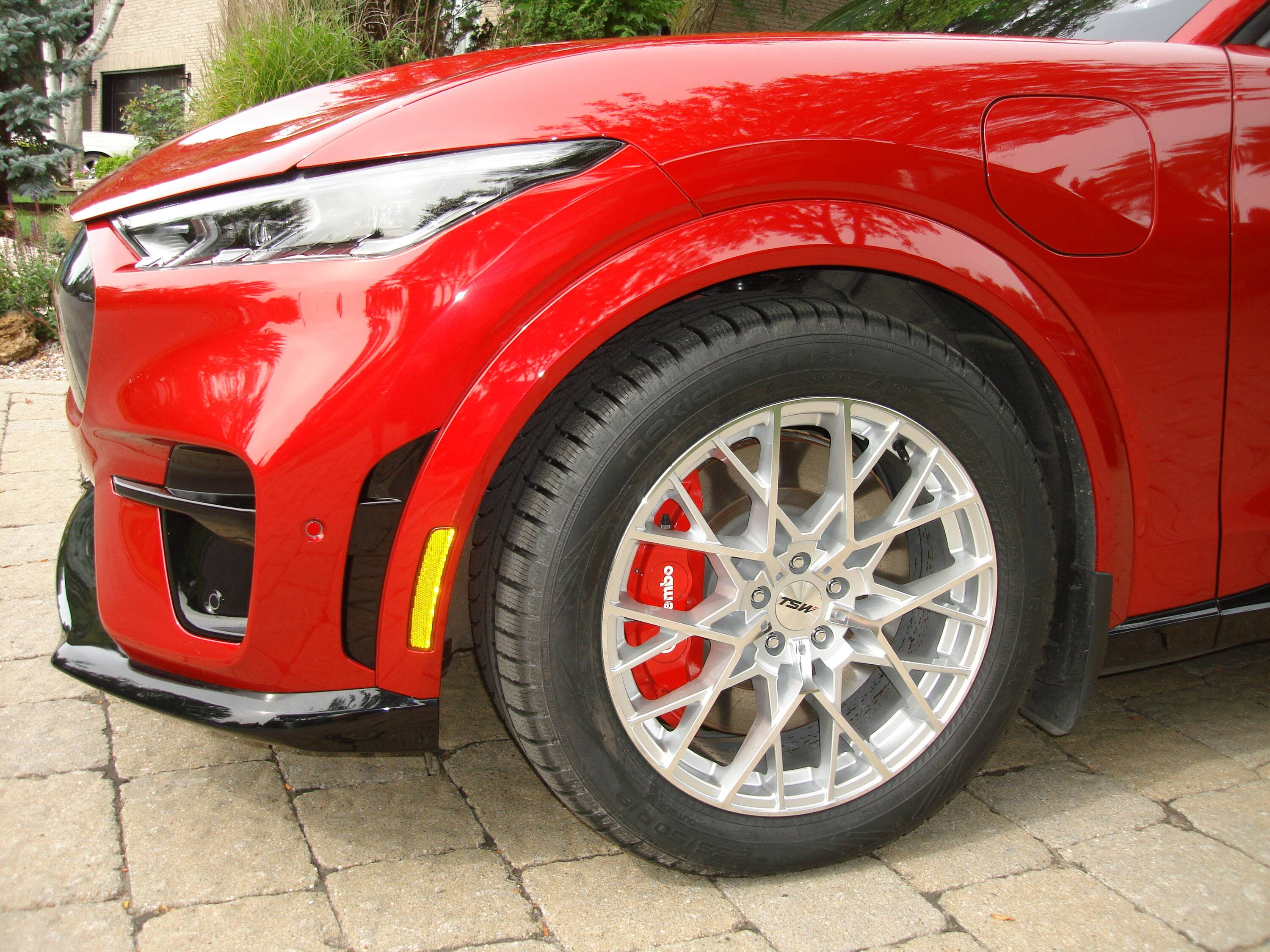

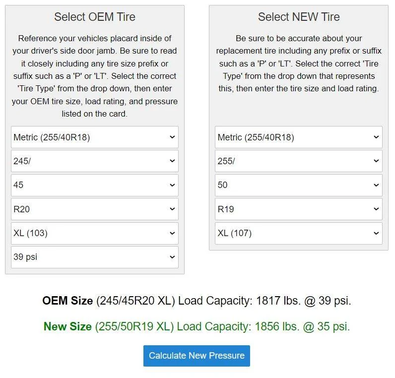

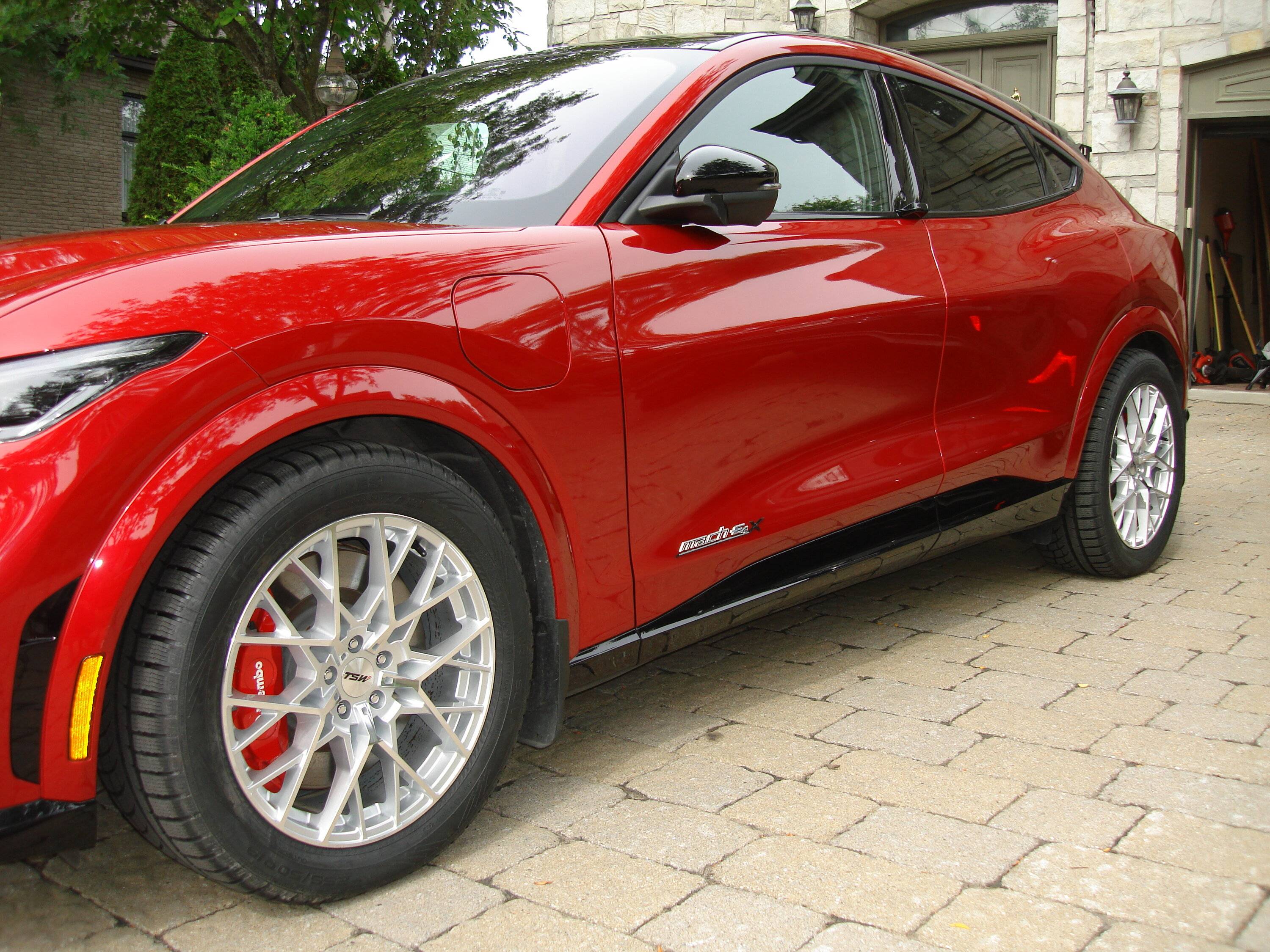

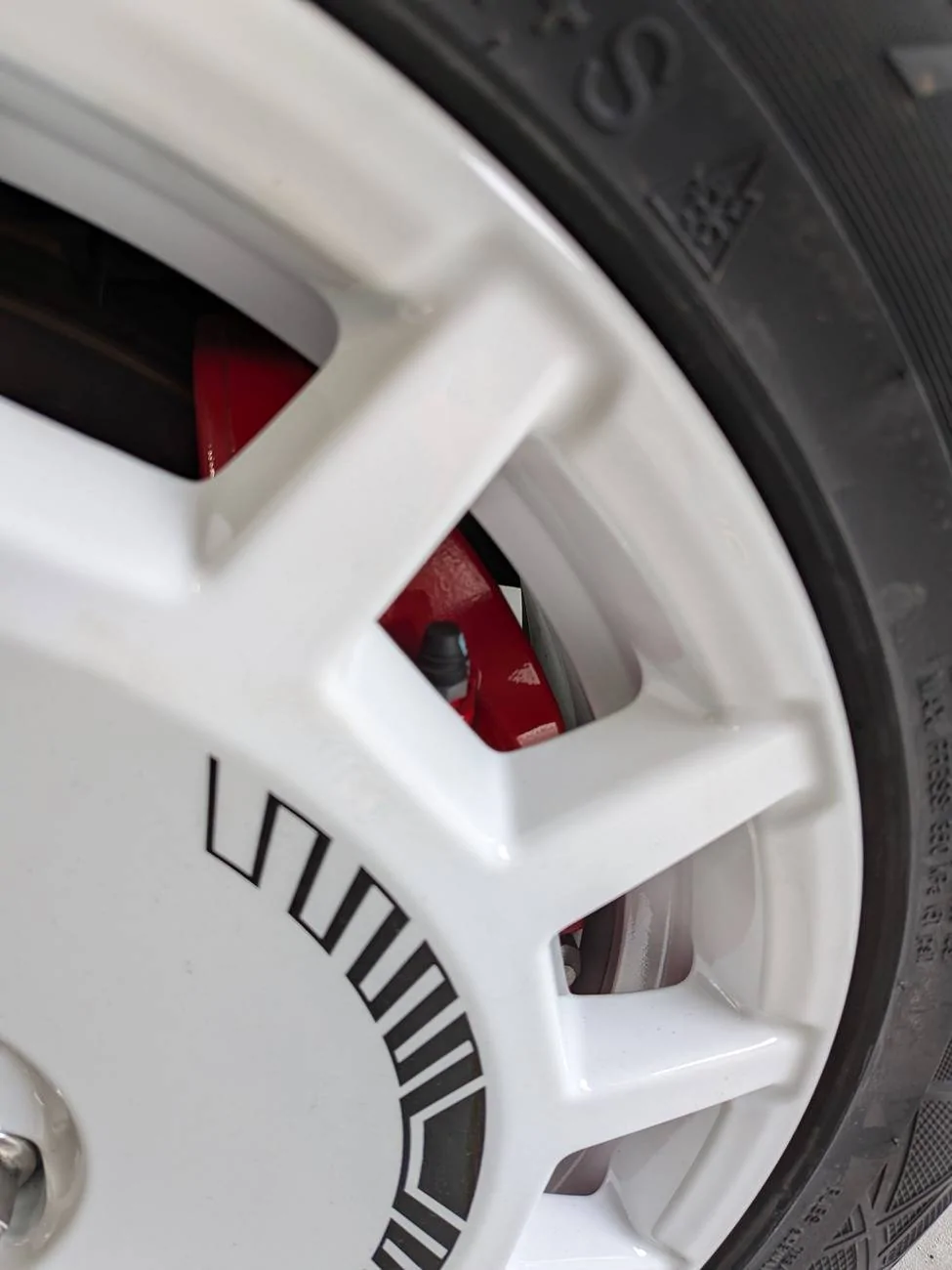

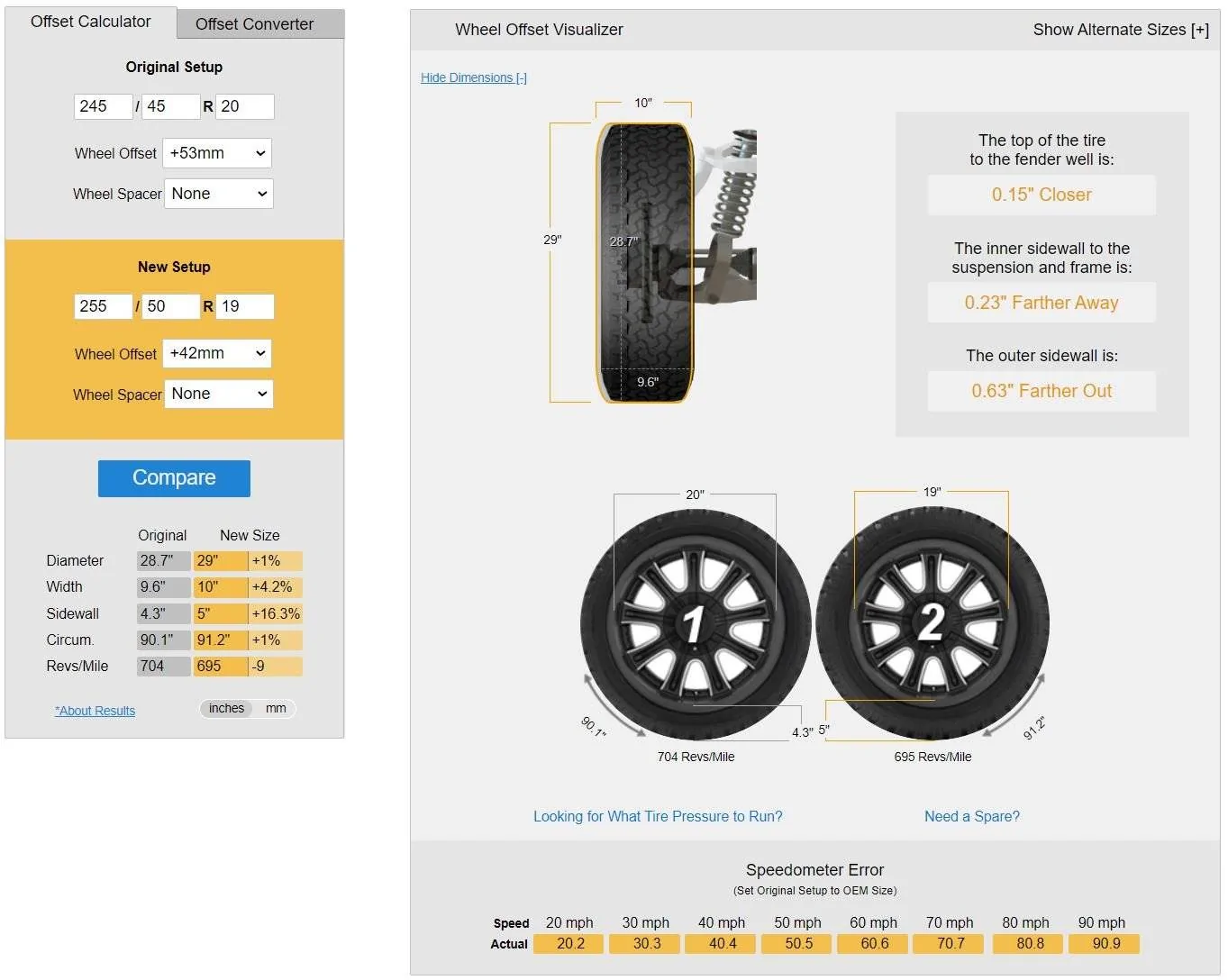

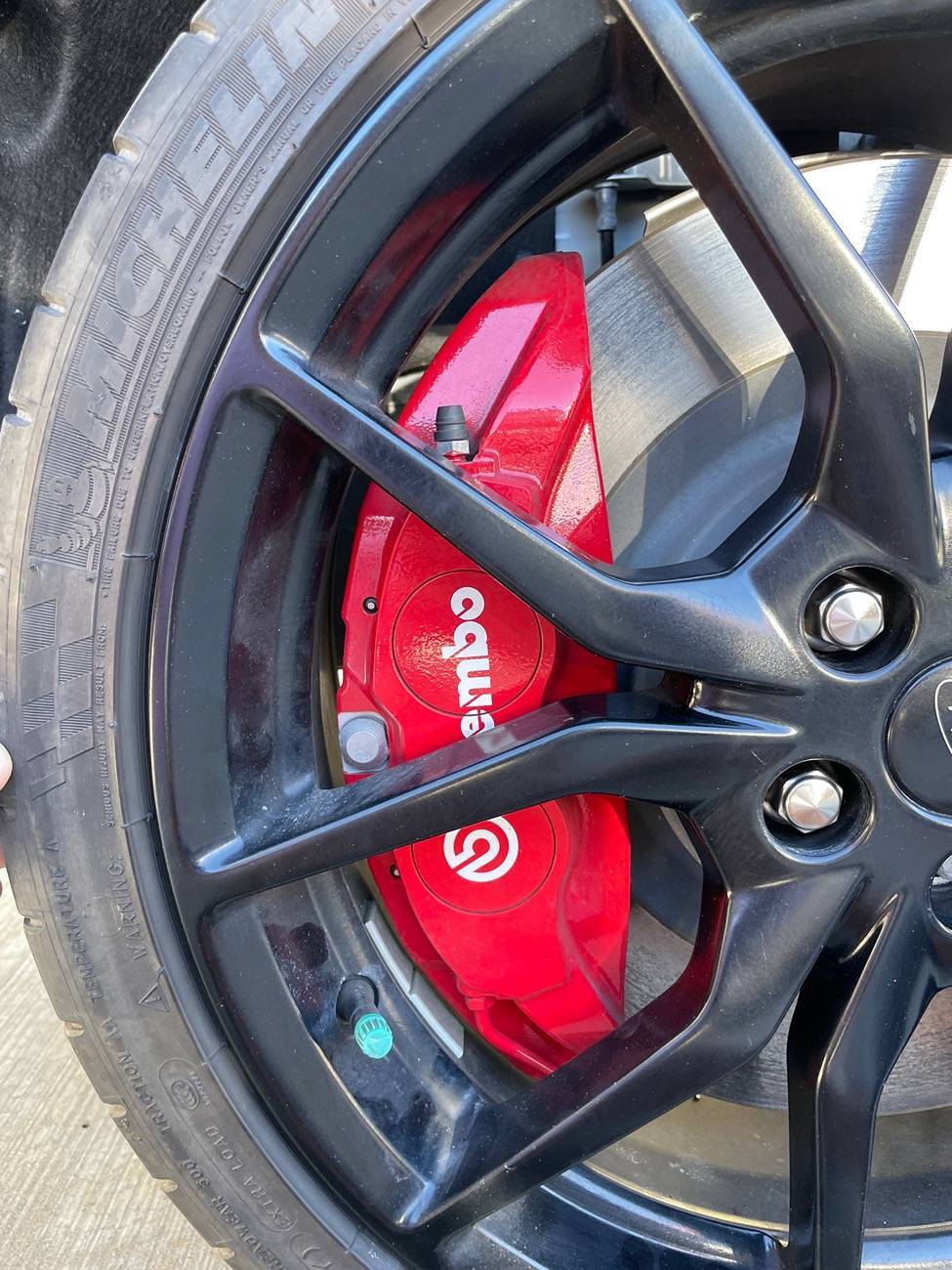

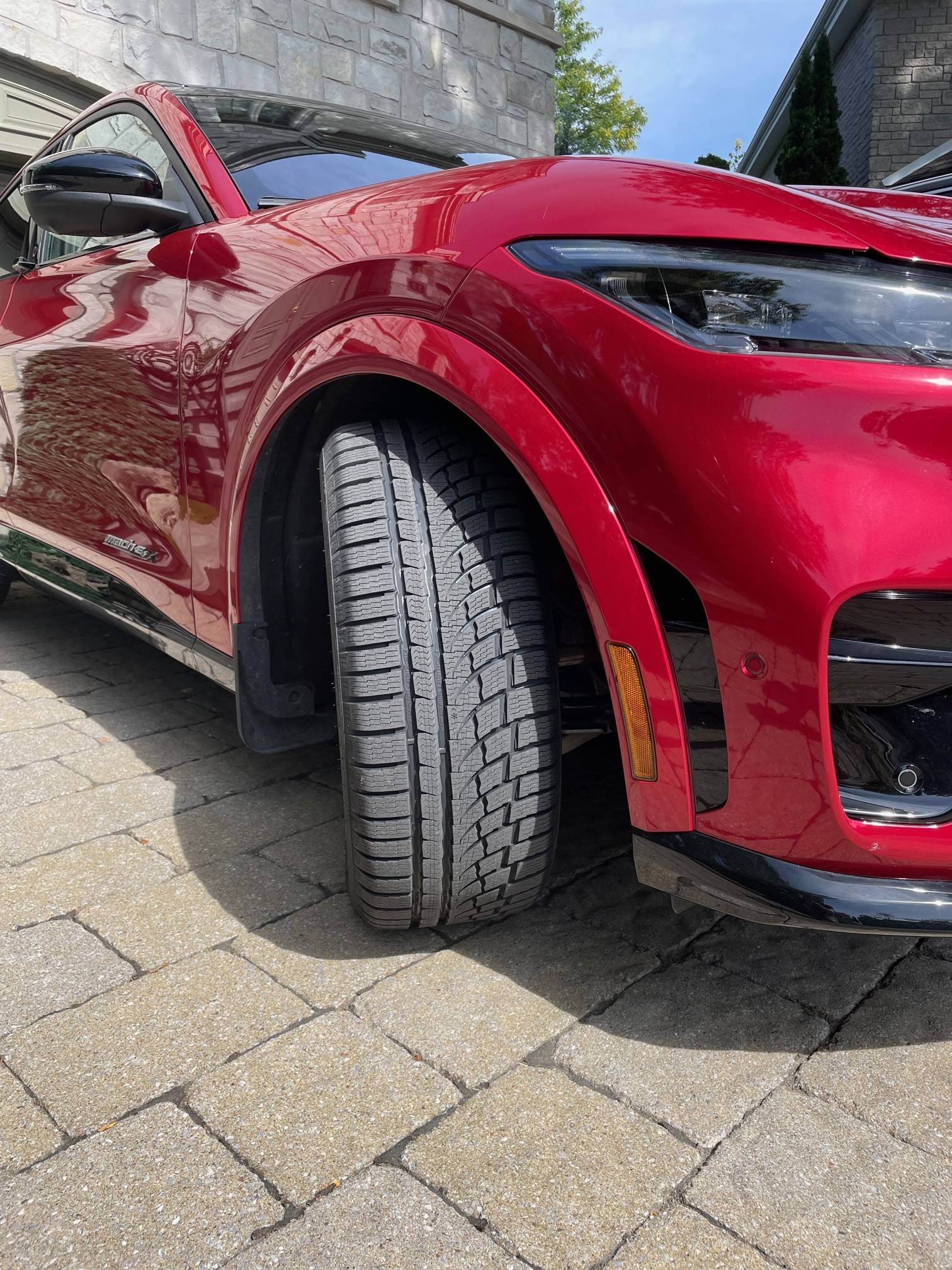

Confirmed Fit | TSW SEBRING
Pictured with NOKIAN WR G4 SUV 255/50 R19 107V XL tires ($219 each as of 9/19/2023) | $320 each (as of 9/19/2023) | Amazon product page |

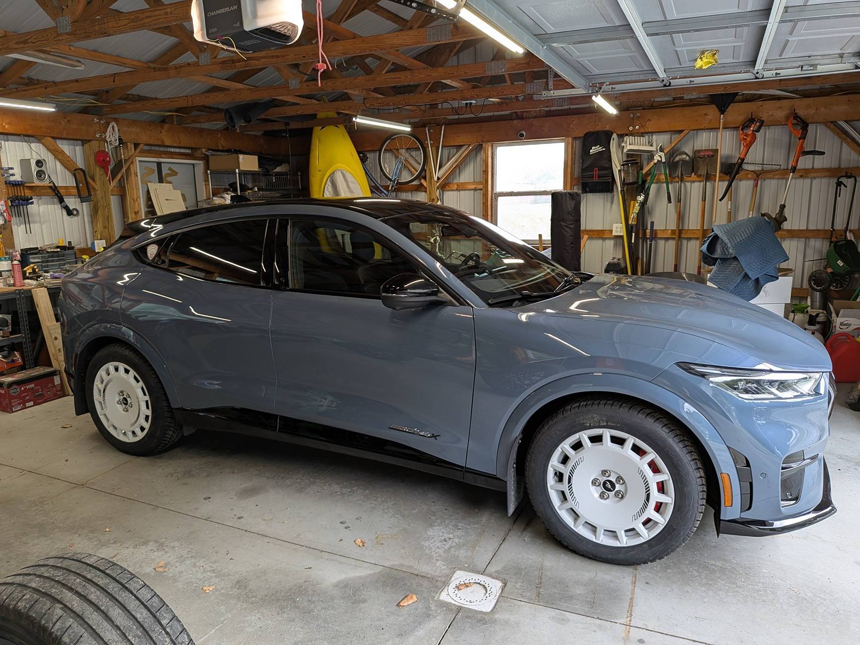

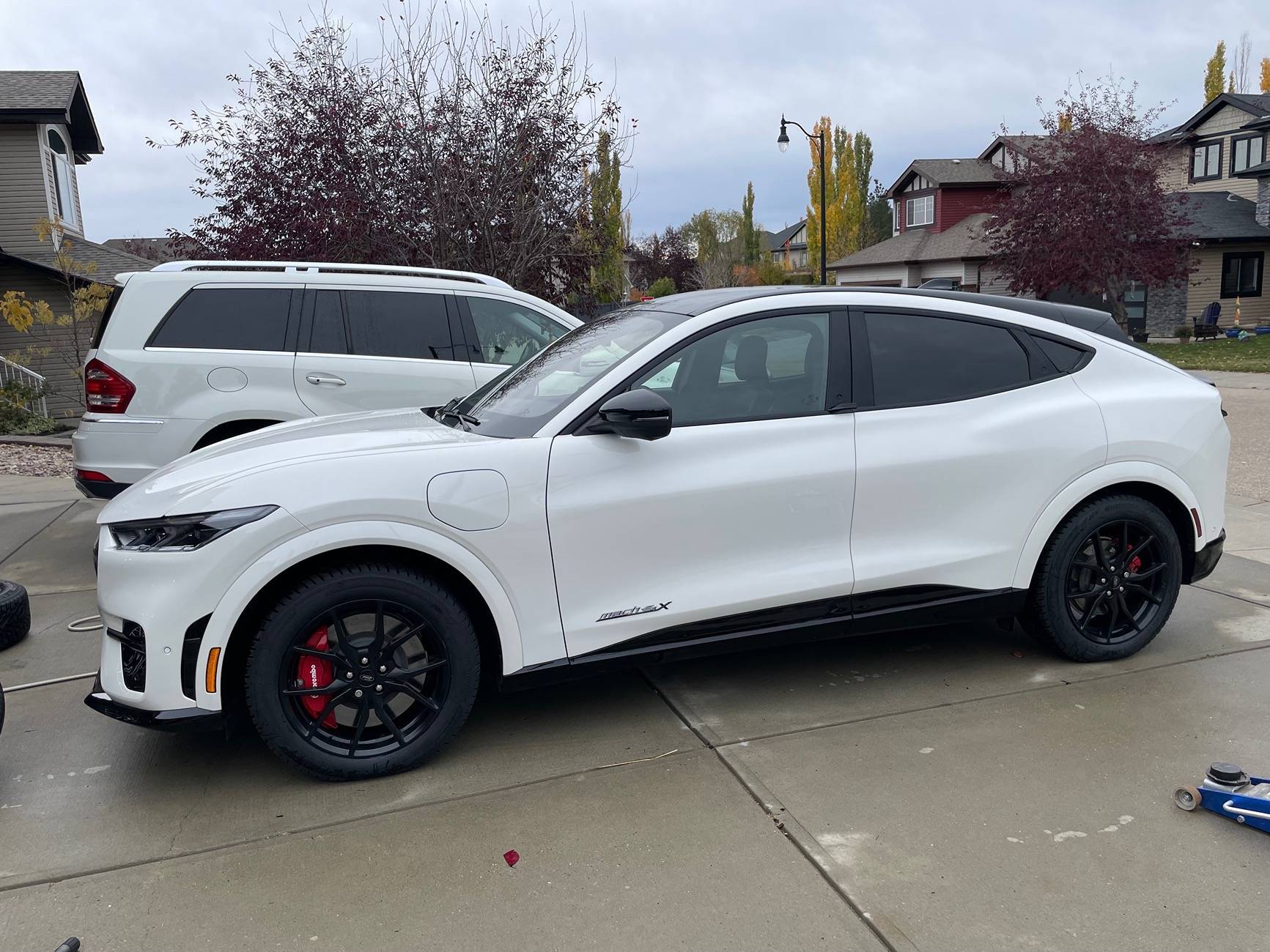

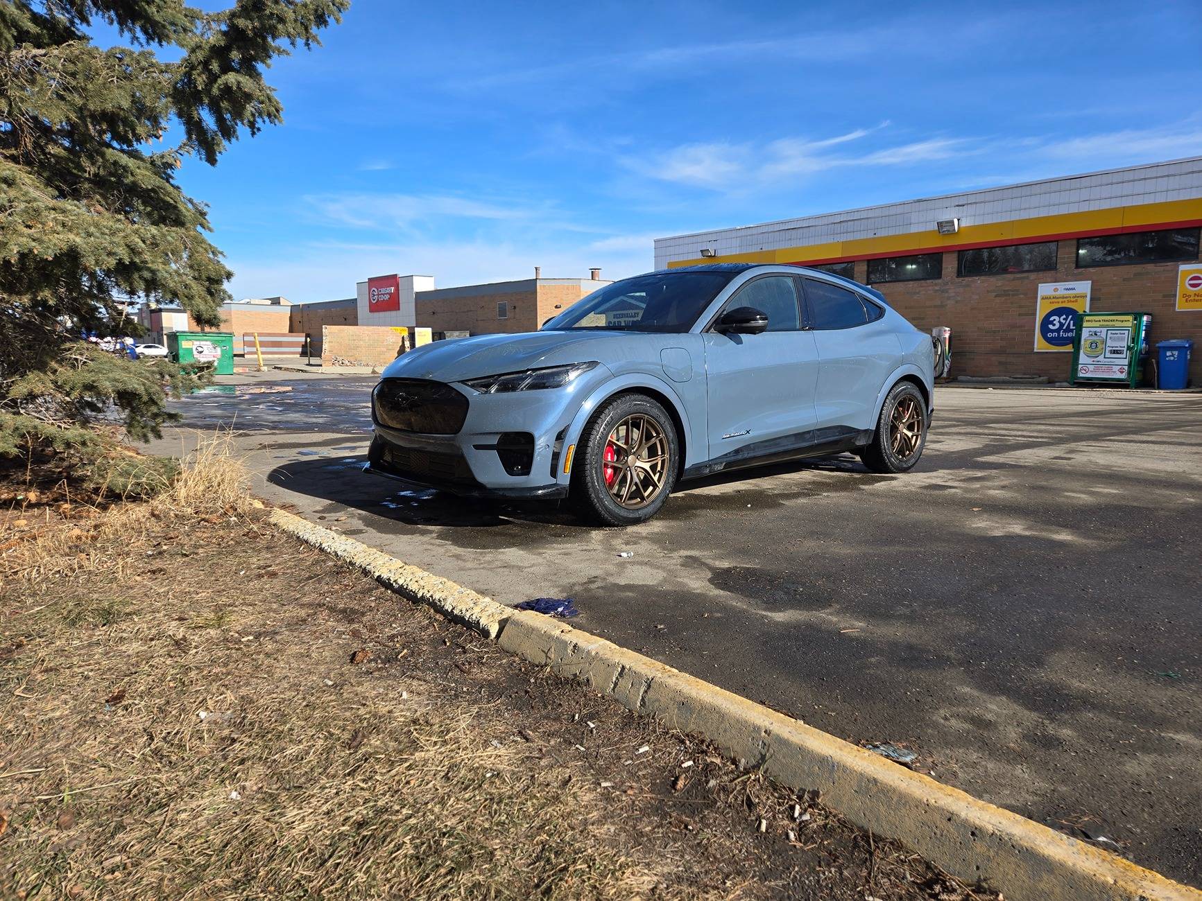

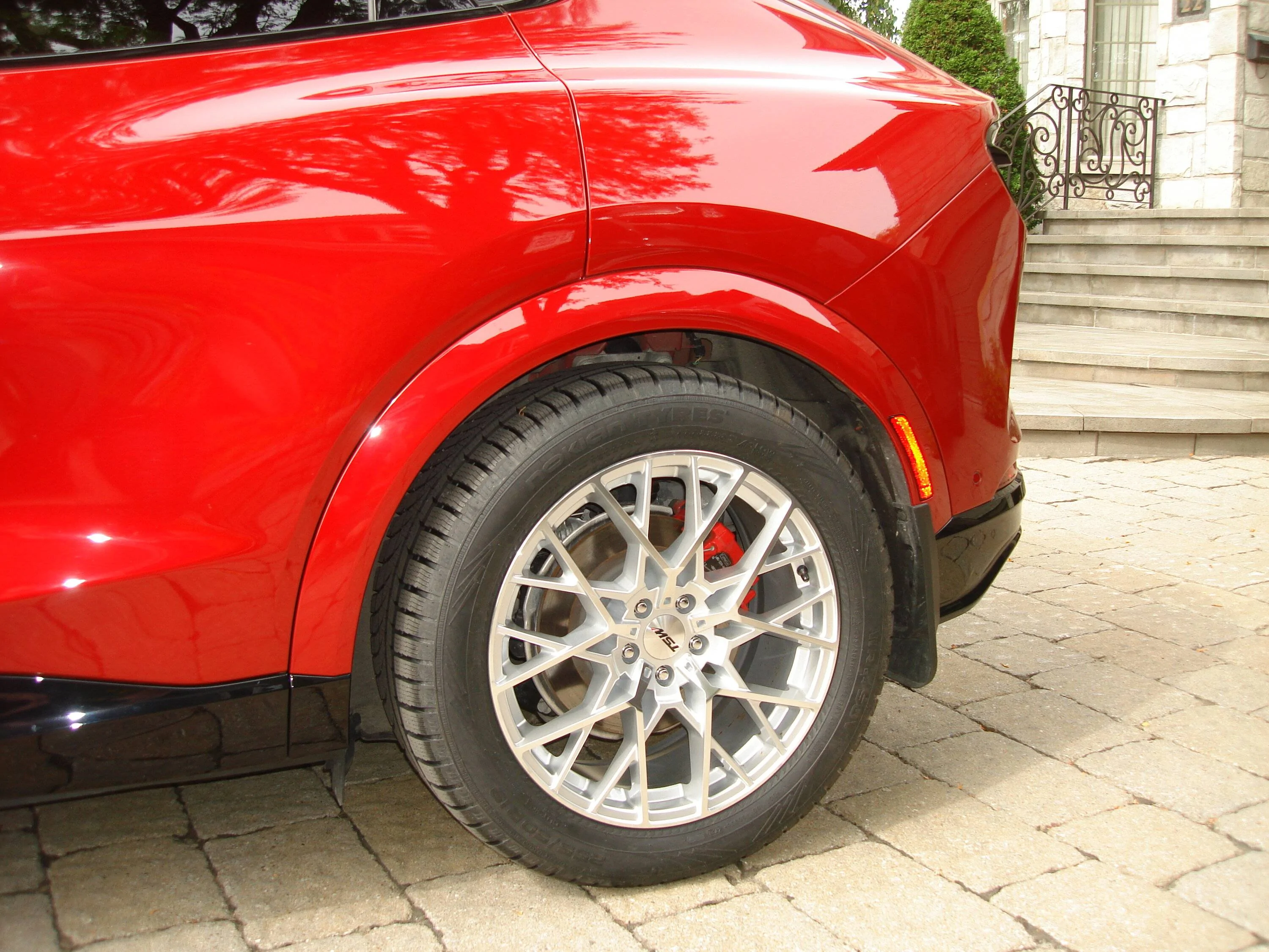

Confirmed Fit | Art Replica One:
| $243.20 CA each (as of 10/11/2023) | ART replica One at Canada Wheels |

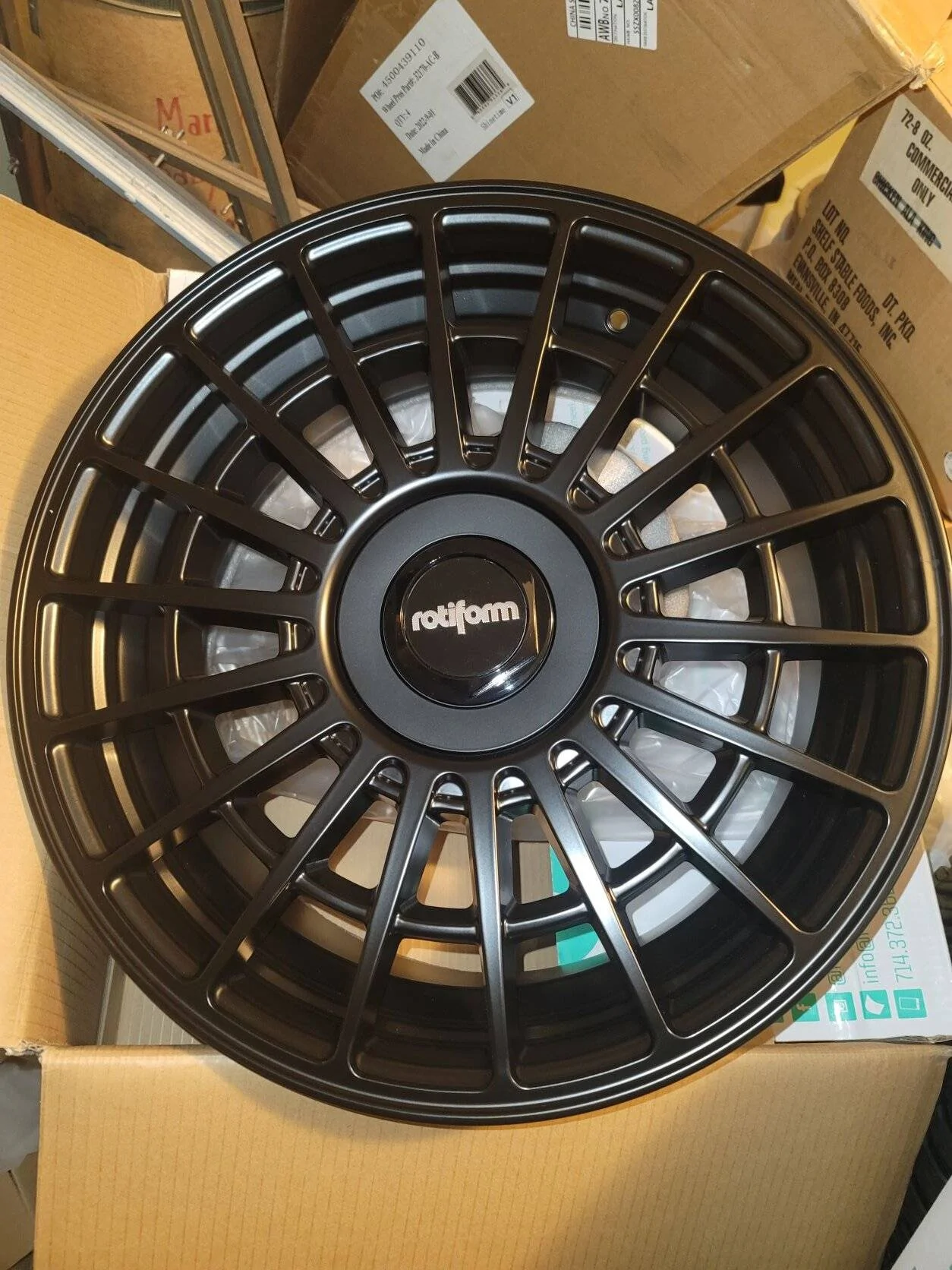

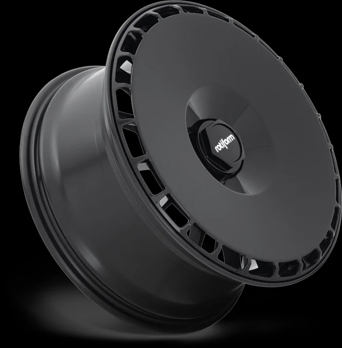

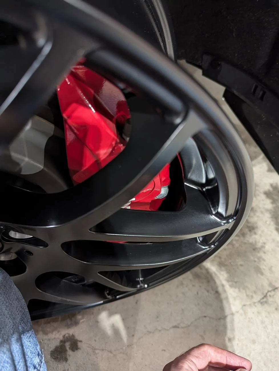

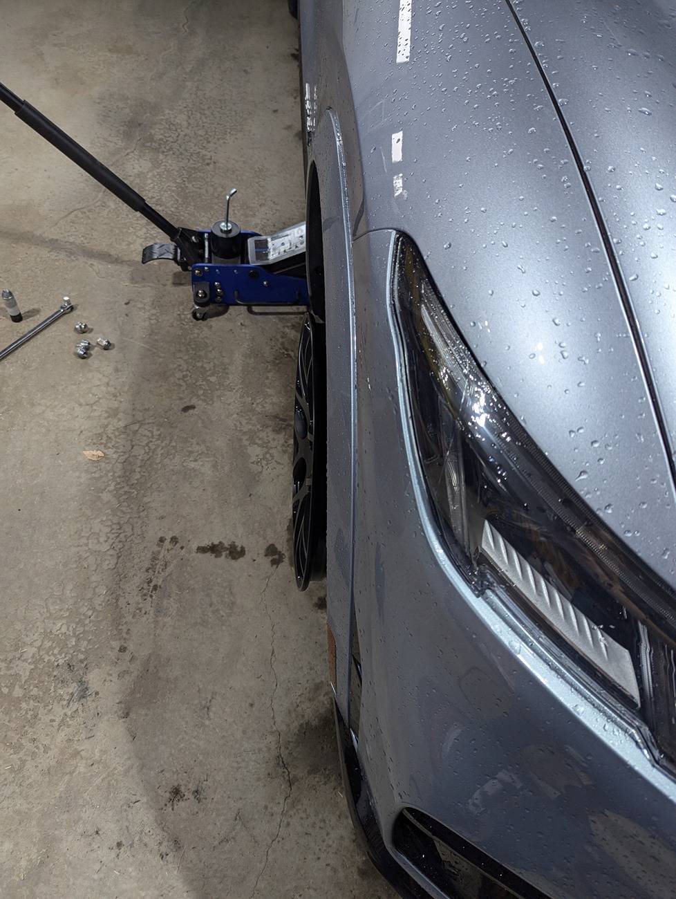

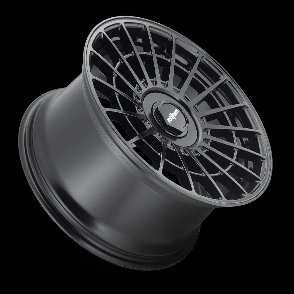

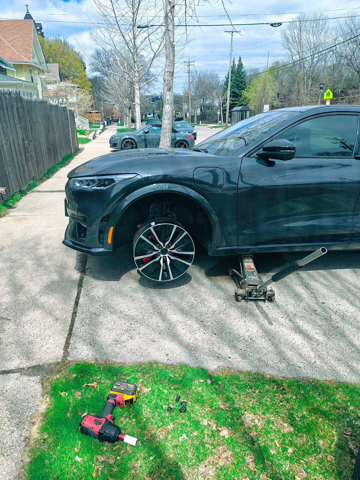

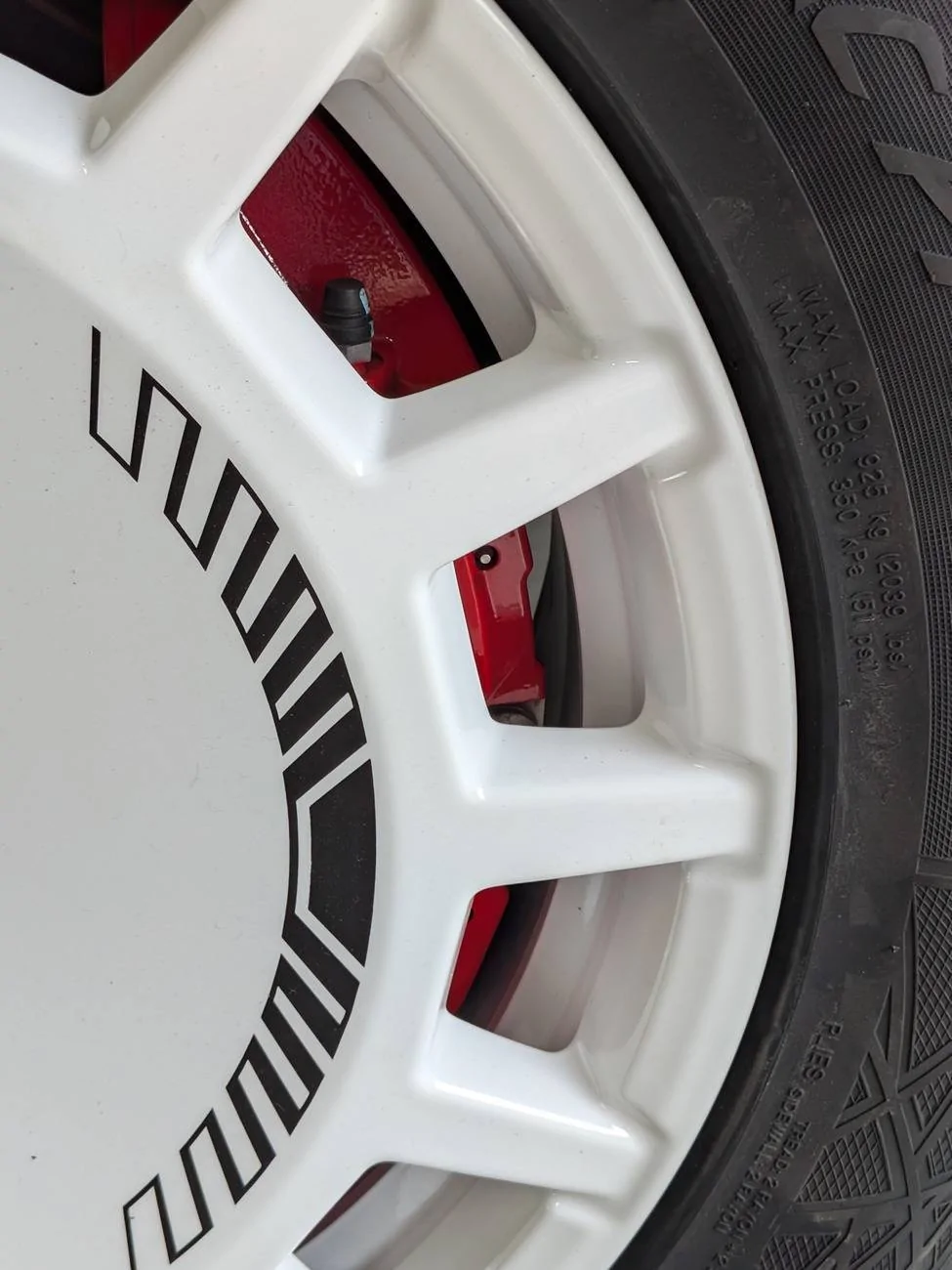

DOES NOT FIT | Rotiform LAS-R (with Aerodisc cover) |
| https://www.rotiform.com/wheel/40085/monoblock-las-r/?styleID=4200 |
