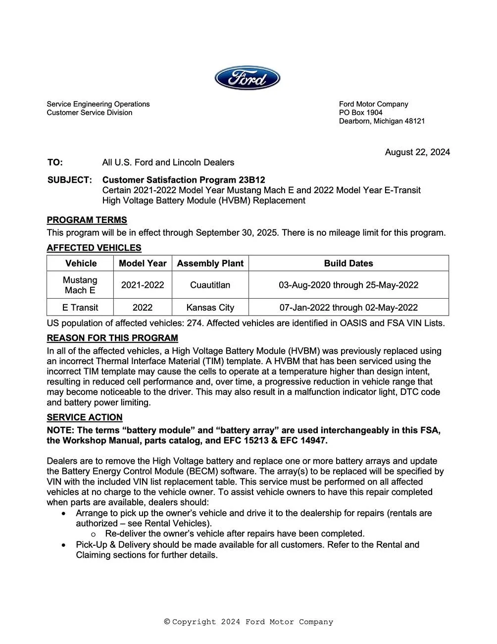

A customer satisfaction program (CSP) has been released for a small number (276) of 2021-2022 vehicles with incorrect applied thermal interface material (TIM, AKA thermal paste) due to an incorrect template that was sent out to Ford dealers. This only affects vehicles where a battery module has been removed or replaced previously (rare). The thermal paste bridges the battery cells to the cold plates so heat can be transferred from the cells for thermal management. If the paste is not applied properly, the affected cells will run hotter (or colder in the winter), which degrades them faster than the rest of the pack and causes greater cell capacity mismatch and range loss over time.
The fix it to replace the affected cell modules with new ones (usually 1 pair), and reapply the thermal paste with the correct template. This will involve dropping the battery pack. A battery module is one of the "bricks" inside the battery pack that contains about a dozen cells.
This is NOT related to the HVBJB recall/repairs.
It only affects a small number of vehicles that actually had a battery module removed or replaced. This is rare.
As usual, check the Service > Service Campaigns section of FordPass to see if you're affected by any CSPs. If you do not see 23B12 listed, then you are NOT affected. I would recommend having this done if you're affected, it is not urgent however. Owner notification letters will be sent out starting in September.
Ford Mustang Mach-E CSP 23B12 - High Voltage Battery Module Replacement for Previously Repaired Vehicles 23B12 P1

What, if anything, does the "23" mean, in the CSP ID number "23B12"?
I had the impression that the first two digits identified the year in which the CSP was issued. But clearly my impression was wrong, since this one was announced in late 2024.
Here is a picture of the templates (blue sheets) used to apply the TIM to the cold plates. The cell modules sit on top of the cold plates and the TIM is sandwiched between them. It functions similar to thermal paste between a CPU and heat sink in a computer. During module replacement, the template is placed onto a bare cold plate and the TIM is filled and pressed into the slots. The blue template is removed and the cell module is installed, which spreads the line of paste out when it is clamped down. Each line of paste is for one cell.
