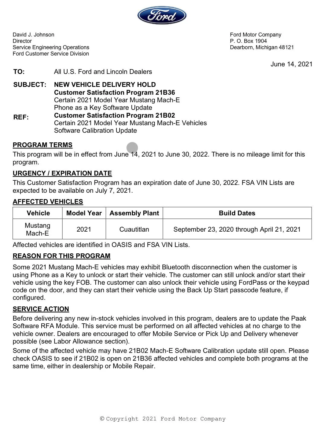

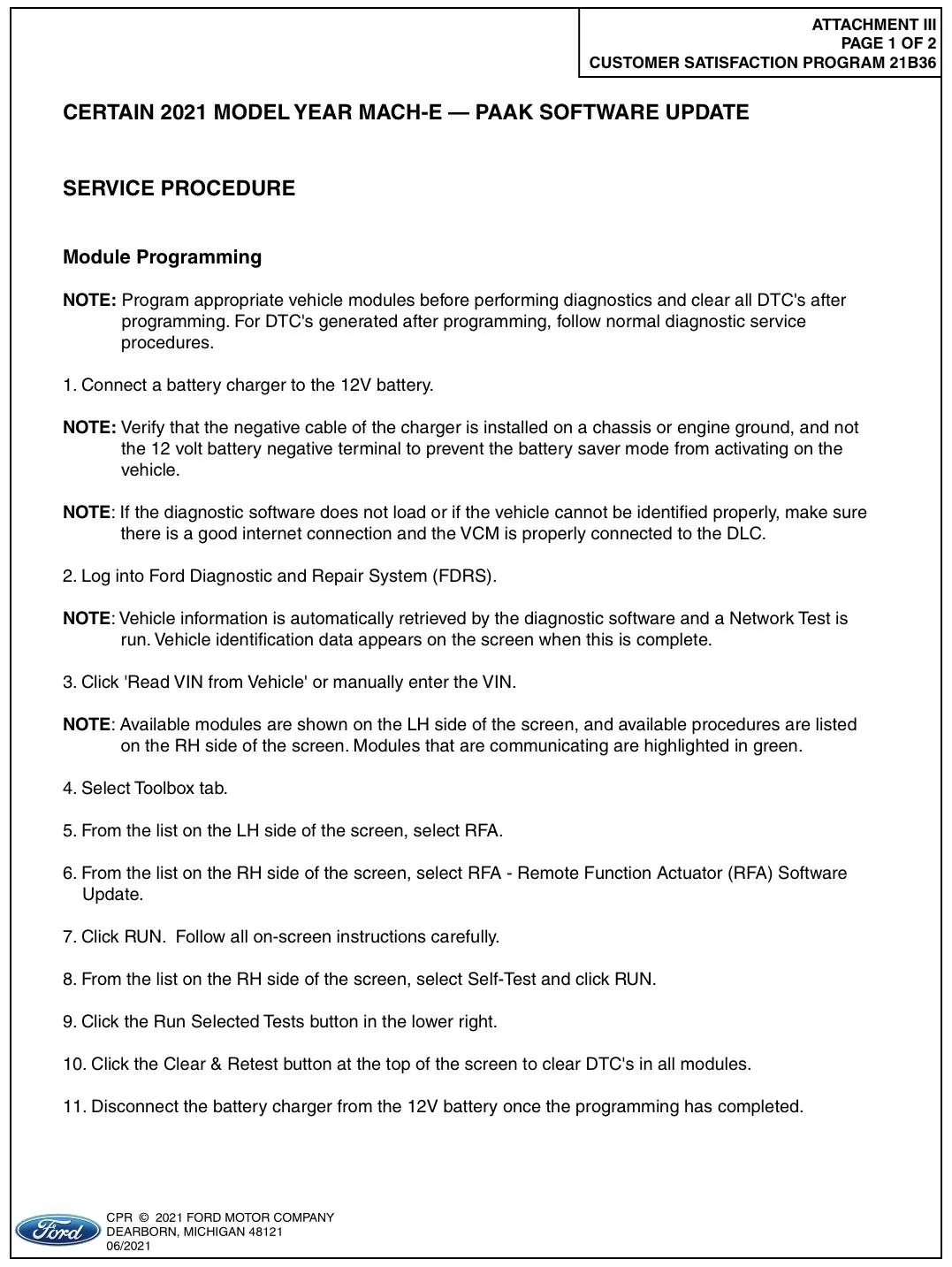

As many of you know this CSP was released recently. Here is the full info released to dealers. I started a new thread so this info wouldn’t get buried.
My PAAK works 95% of the time, then the other 5% it just doesn’t work at all. I’ve made the appointment so hopefully this solves those issues.
