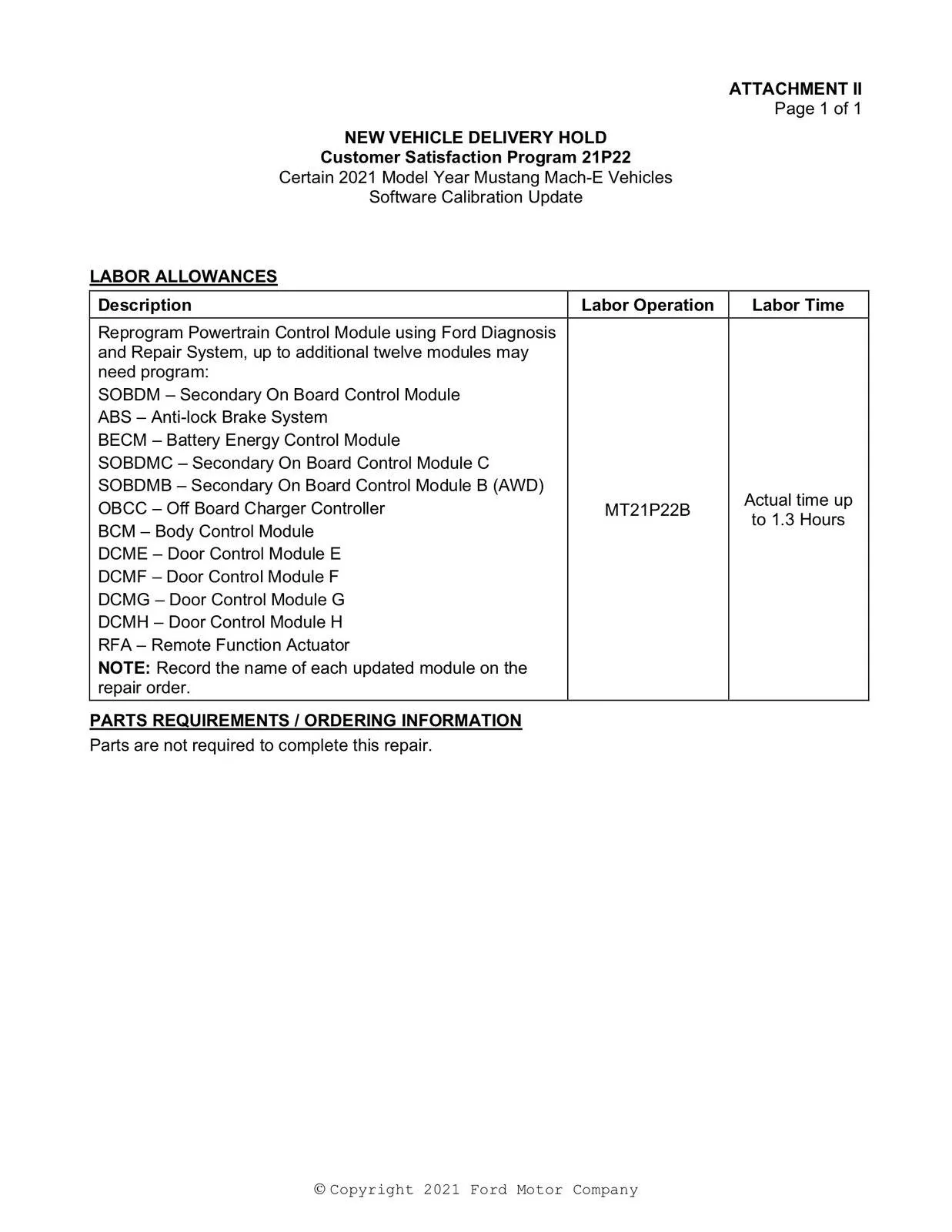

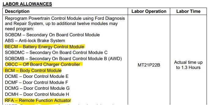

New CSP announced yesterday that includes quite a few module updates to address past issues including the hill descent shutdown issue, in addition to other improvements. This seems to be "Mach-E Service Pack 1" effectively, this will fix a lot of issues with the early builds.
EDIT: This update also improves the DC fast charging curve for non-GT vehicles above 80%. Charging rate from 80-90% is now ~45 kW (up from 12 kW), and gradually decreases from 90-100% SoC.
March 2022 Update: The program has been expanded to include vehicles built through Sept 30, 2021.
Original bulletin:

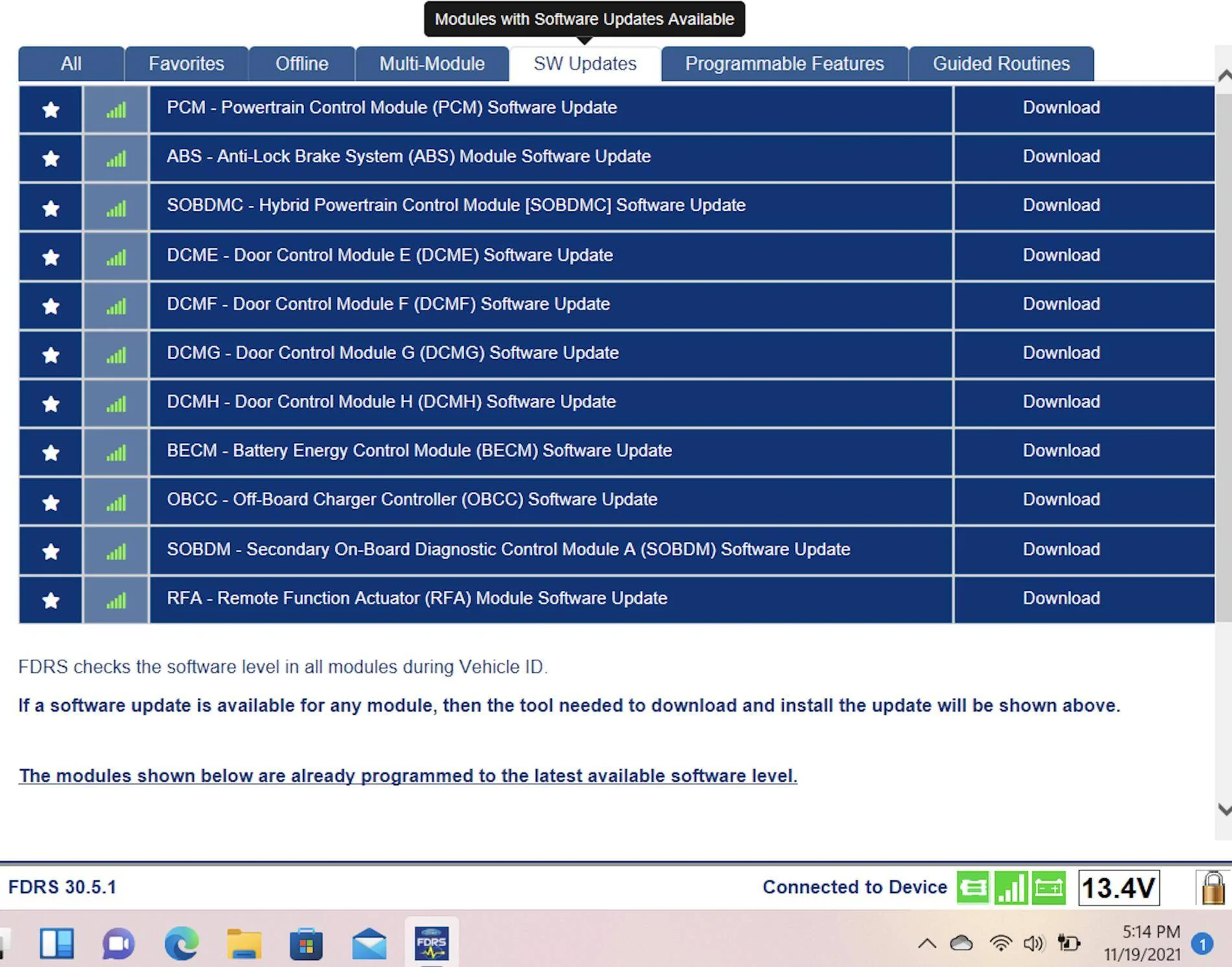

If you are having the windshield recall done, it would make sense to combine visits and have the updates done at the same time. When dealers look up your car on their system (OASIS) by VIN this should pop up in yellow for affected vehicles. There are also step-by step technical instructions for the technician to follow if they aren't sure how to do the updates. These updates are also available in FDRS for DIY self-updaters.
Original bulletin:
