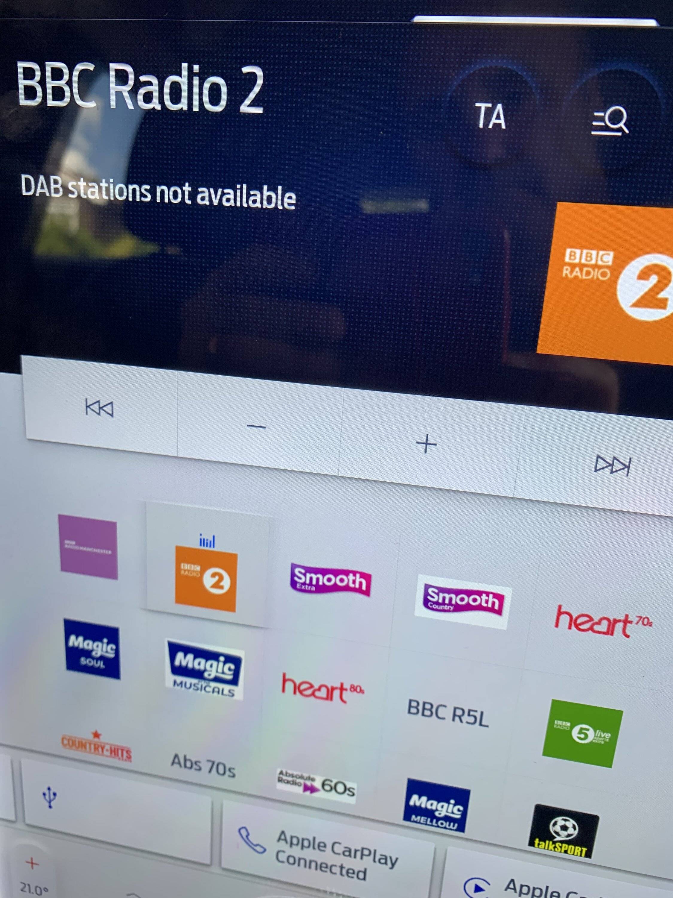

Anyone else had this on the screen.
All DAB stations were working fine went shopping came back 20 minutes later now all I get is DAB stations not available ..FM works fine . I have reset the screen parked the car up for an hour exactly the same issue. Any ideas. I have tested DAB in another car works fine …
