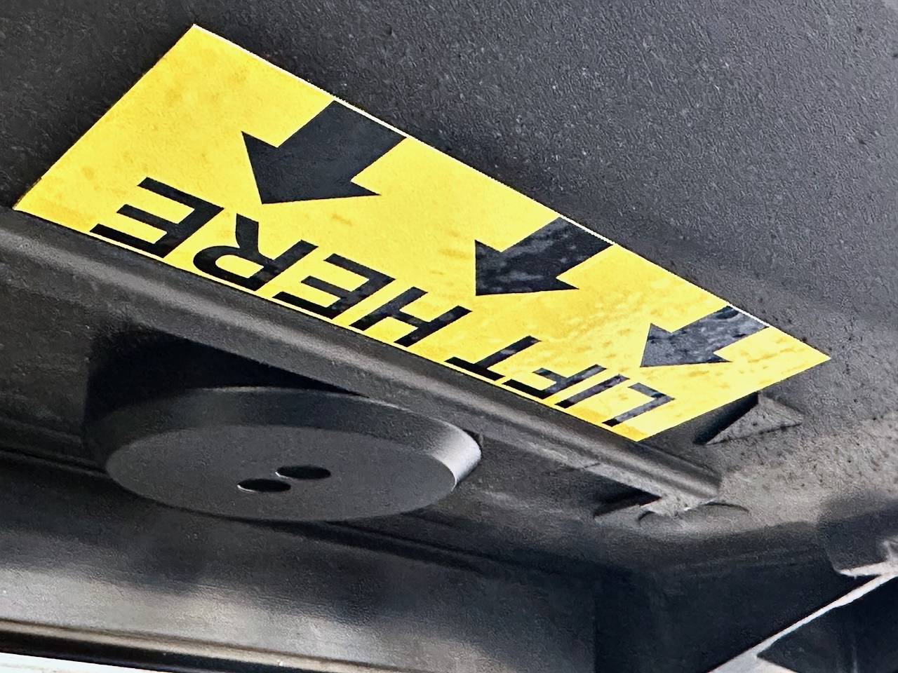

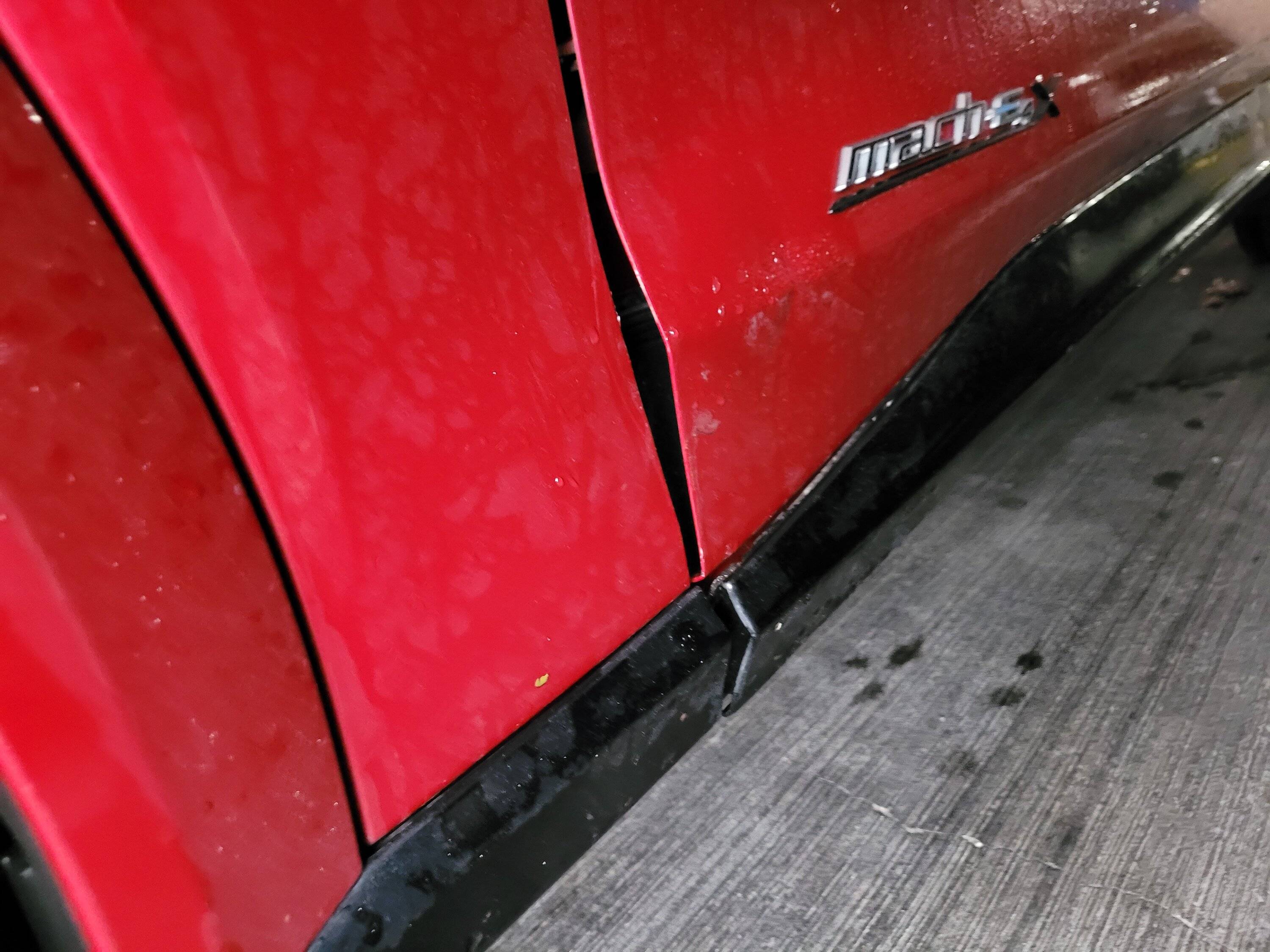

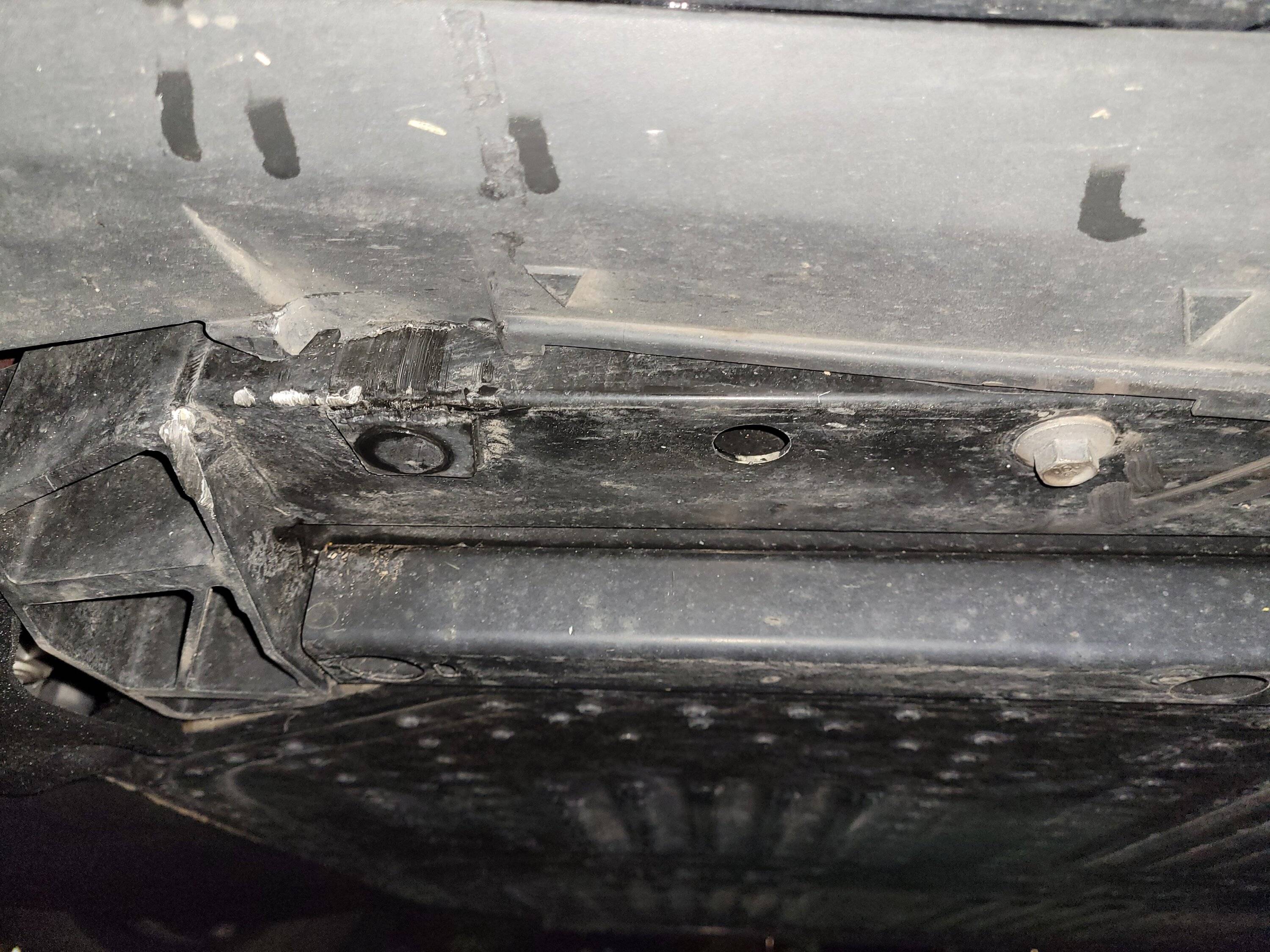

The jack slipped off the lift rail, and the weight of the car came down on the outer trim, crunching it and the driver door. It appears they lifted just forward of the designated spot between the triangle marks, probably landing on the forward bolt then slipping off.
