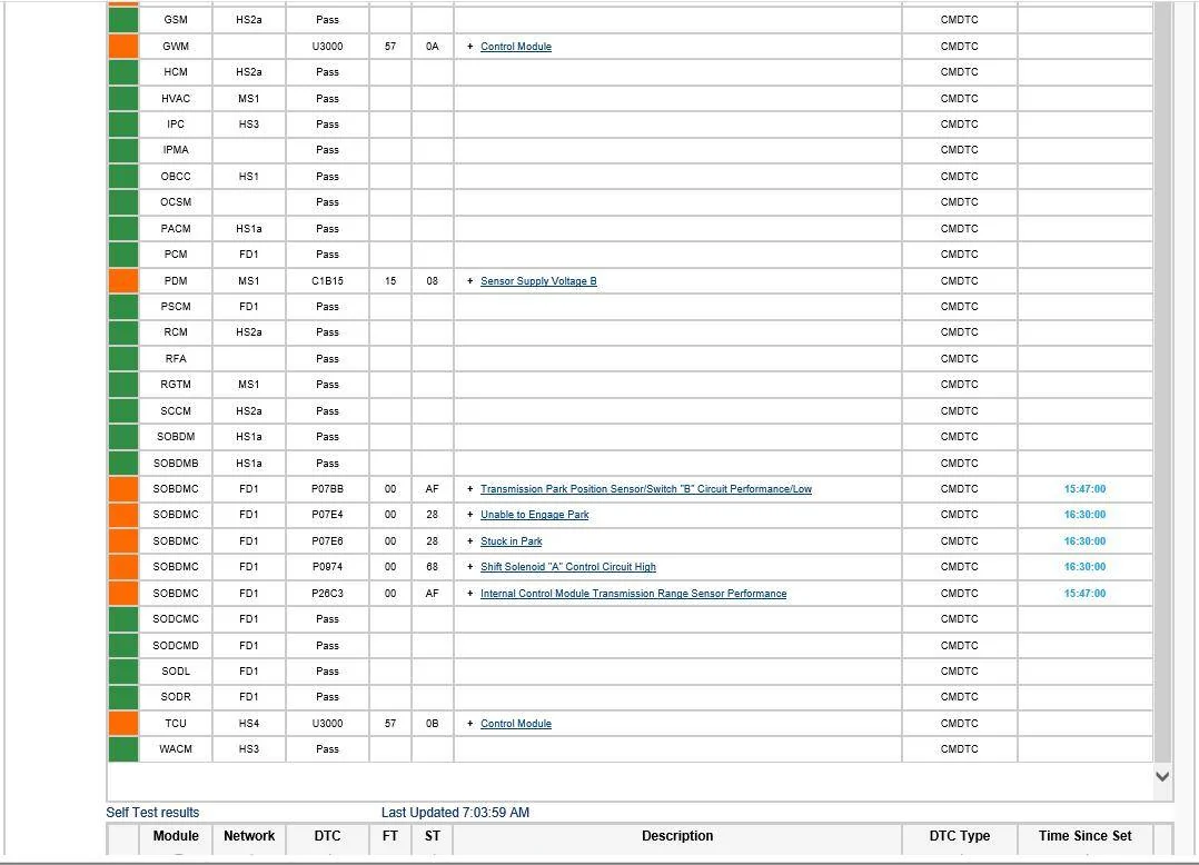

Curious if the dealer gave you the specific DTC (trouble code(s)) for your park issue?
For the sake of understanding what happened, it can be looked up in the service manual.
Hope your car is good to go!
Lots of them:

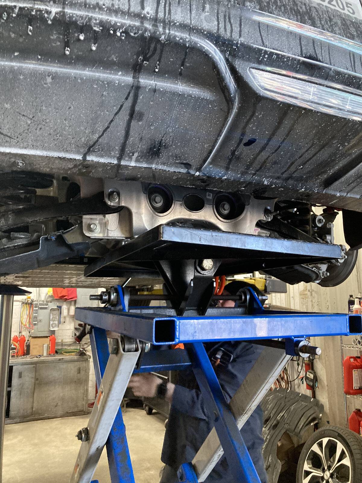

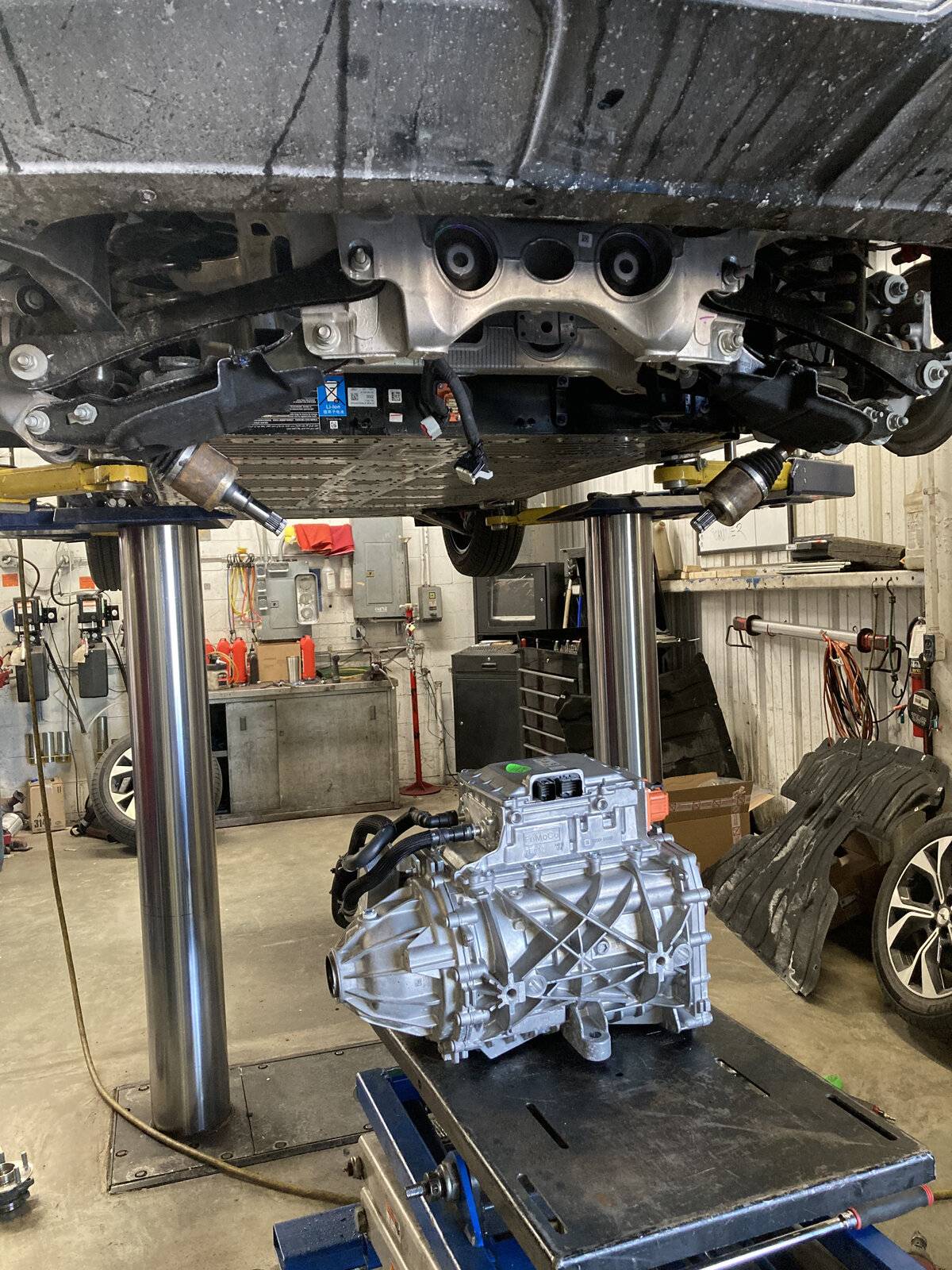

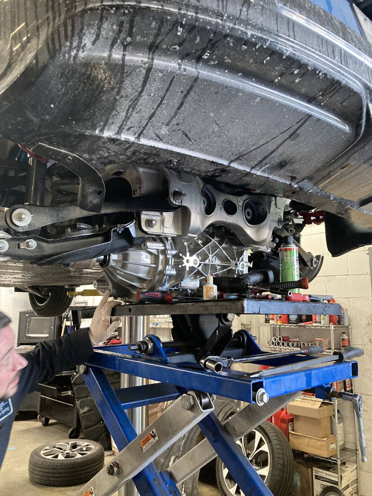

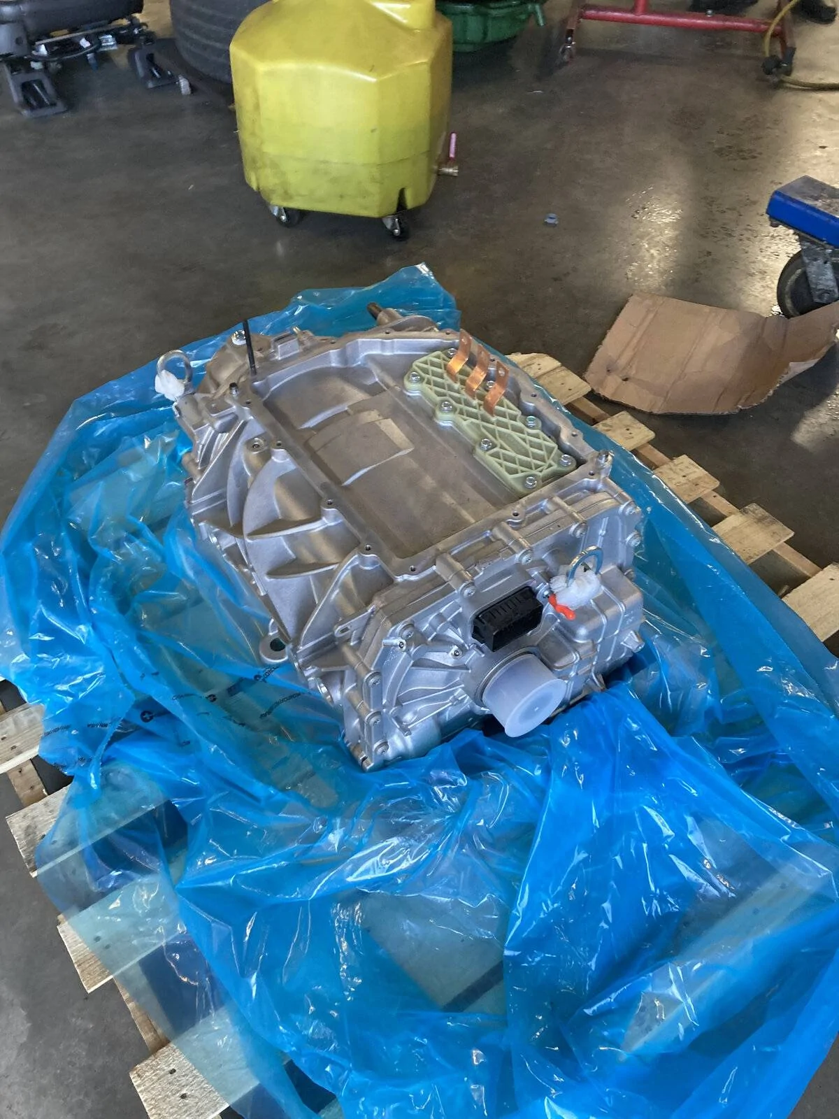

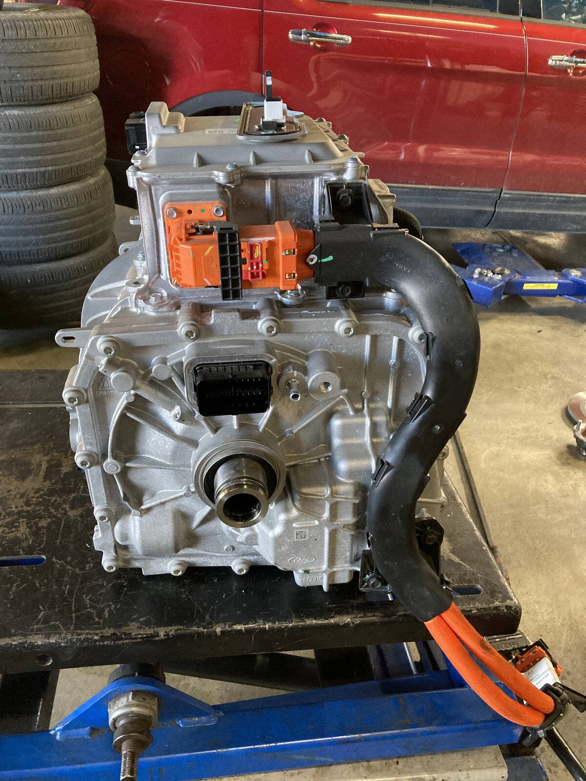

Marlin now has a brand new Primary (Rear) Drive Unit and wiring harness. Ford was really quick at getting such a new and major repair accomplished. Most of the replacement was done in one day. The next day was buttoning up, replacing a couple of one-time use bolts, and calibrating the new PDU. The Field Service Engineer was concerned they might not get finished on Friday when the calibration didn't go smoothly but they managed to solve the issues and got Marlin back to me Friday evening.
Here are some shots the FSE took for me, including proof I got some new electric ponies for Marlin:
"Old" PDU removal
The new PDU
Saturday I put 60 trouble-free miles on Marlin and did a partial charging session at the Columbia, MD EA station. Charging on my account worked, Plug & Charge failed. More on that and the trip to Florida as I pick up the story where we left off in
"Old" PDU removal
The new PDU
https://www.macheforum.com/site/threads/my-travels-with-marlin-gb-fe-delivered.3298/
Super interesting -- thanks for providing these pictures. Looks like it comes out easier than I thought! I thought the rear suspension would have to drop, or maybe the battery, in order to get the motor out.
