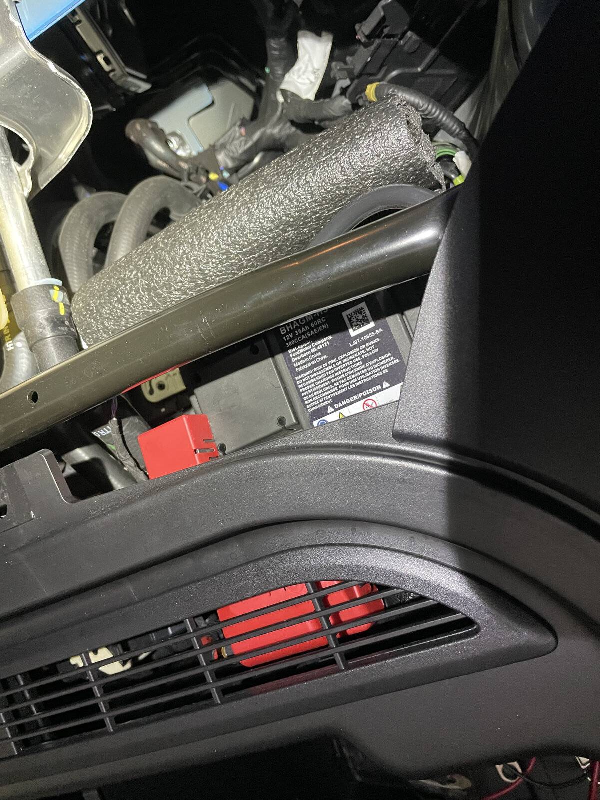

In the Frunk area, I removed the rear luggage compartment cover to access the battery and it was only reading just under 7.5vdc.
Video 11

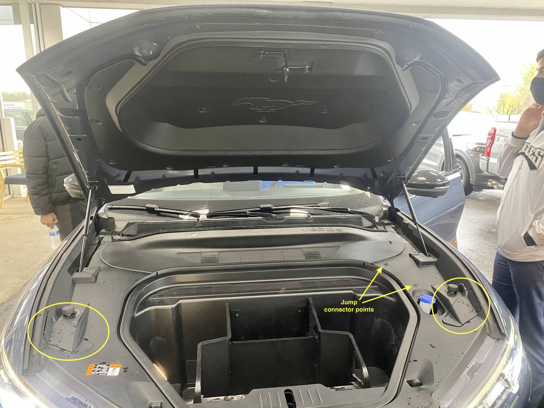

Removing the rear luggage compartment cover gives you access to the negative battery cable and an ability to reach under to put a probe on the positive battery lead. However, there is no safe way to jump the battery at this point as the positive lead is under a metal crossbar (under that red cap).
Not wanting to further drain the battery, I disconnected the negative terminal and the popping sounds ended. I left it that way overnight (temperature in the 20s). Before turning in, I found that the driver side door open and latch would not engage when trying to close it. Of course, the driver side door was open as I worked on Marlin.

I labored to remove the left luggage compartment cover. Removing these two covers is a real pain! I know Ford didn't anticipate many people needing to get jumps, but a large access panel or pair of smaller access panels in the left-hand luggage compartment cover to access the 12v positive jump terminal and negative ground point would make a lot of sense. Those large panels are not easy to remove in cold, dark conditions.
While I think I didn't damage the left one Sunday morning, while removing the rear luggage compartment Saturday night I broke off one of the permanently-molded clips, lost one of the slip-on clips and cracked the middle of the cover. This was despite having removed the rear cover off a Mach E once before. Access points like those at the headlights would make accessing the jump points much easier (see picture).

I checked the LVB. It was now up to 11.5v after resting. With wishful thinking well in hand, I reconnected the battery in hopes there was enough power. Not a chance. the systems energized better but the meltdown of system check failures struck again, so I disconnected the negative battery cable again. This did make the driver side door work. When I let the door close by accident I learned the driver's door now latched (locking me out until I reconnected the 12v). I made sure not to latch the hood as I didn't want to rely on those two leads in the front bumper actually opening the frunk space.
I put a trickle charger on the battery, connecting to the positive jump lead and the negative post on the battery.
