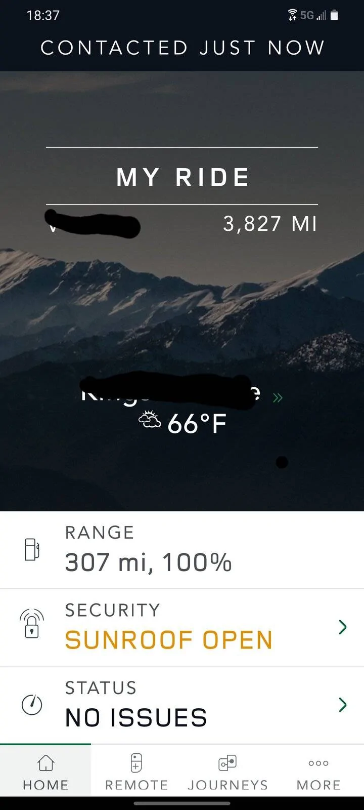

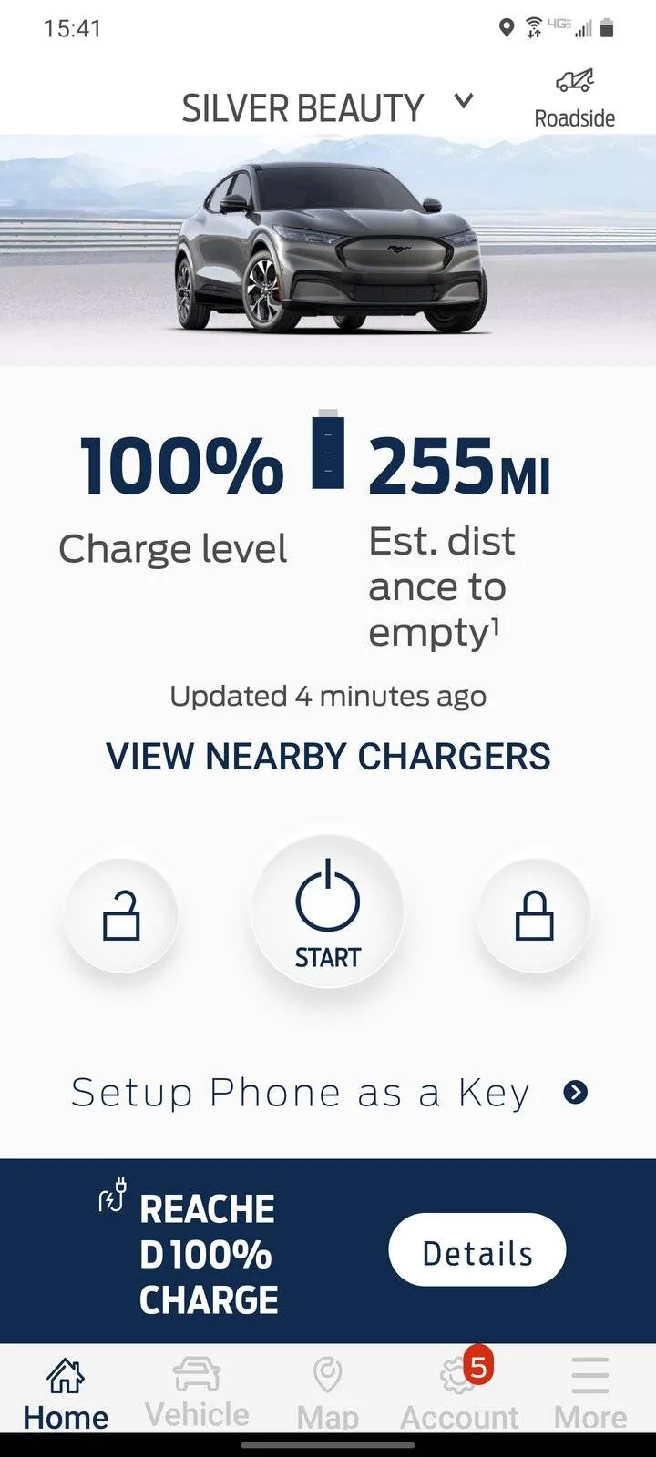

Pics of range, pretty similar. Gas vehicle has a 24 gallon tank too... I have never charged anywhere but home. The free 500 of charging is enticing too.
