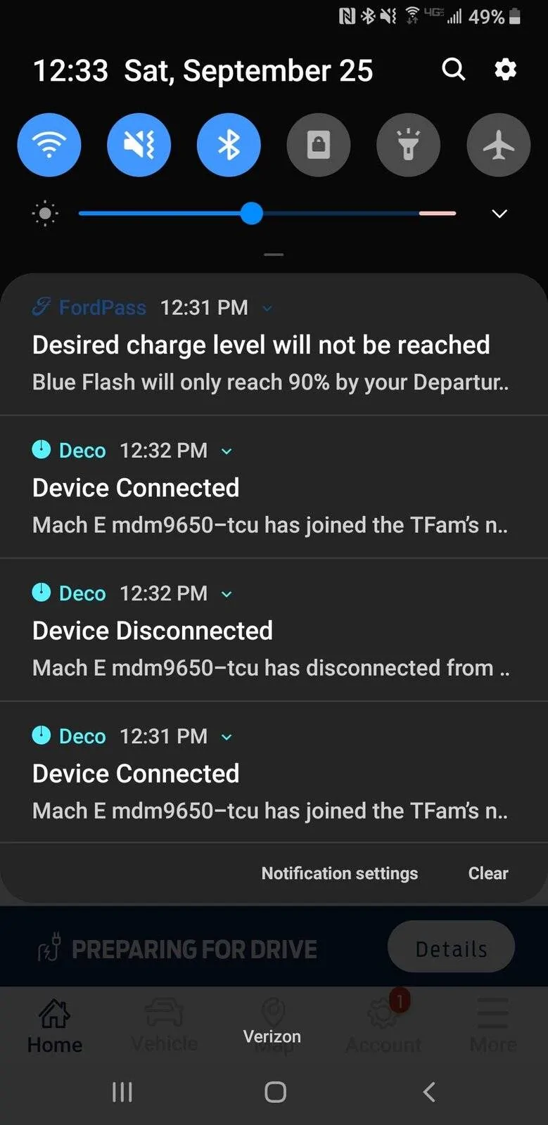

The first thing I wanted to find out is what the car would do if I set a departure time with the cabin temp set to Off. I set a 1 pm departure time and waited. At 12:31 I got the usual notification that the desired charge level would not be reached by my departure time. This has always been an erroneous message for me since the car is already at the desired charge level of 90%.

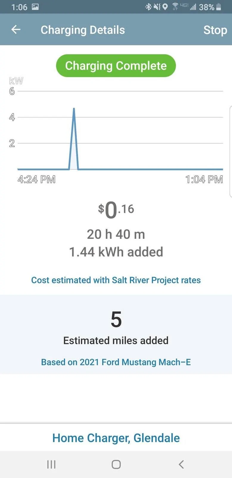

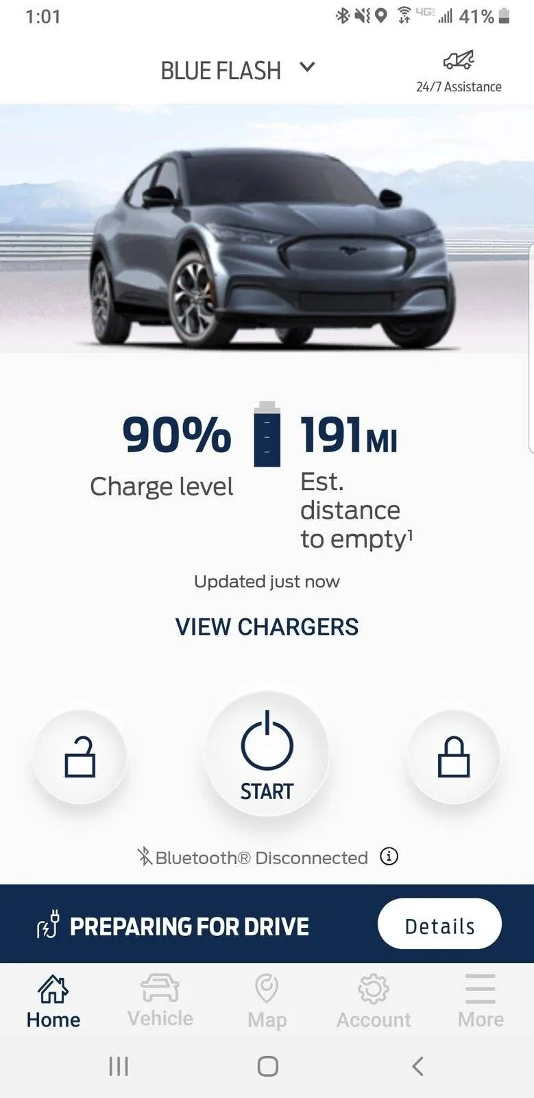

The MME also connected to my network. The ambient temp in my garage was ~97 degrees. As you can see in the screenshot it tells me it's preparing for drive. The only action I found the car taking was the coolant pump seemed to be running. The grille shutters were closed and there was no fan operation. It also did not draw any "shore power". The ChargePoint shows no draw during the 12:30-1 period. Since it is unclear what the "ideal" battery temp parameter is in the software this may be completely normal.
At about 1:10 I found I could no longer hear the coolant pump. The car showed no decrease in SOC even though it did not draw power from the house.

About 10 minutes before I was going to leave I remote started the car. Much to my surprise, even though it was plugged in it did not draw any '"shore power'" during the remote start event. Typically when I am using a departure time it draws at about 3.3kW for around 30 minutes to cool the cabin down.
