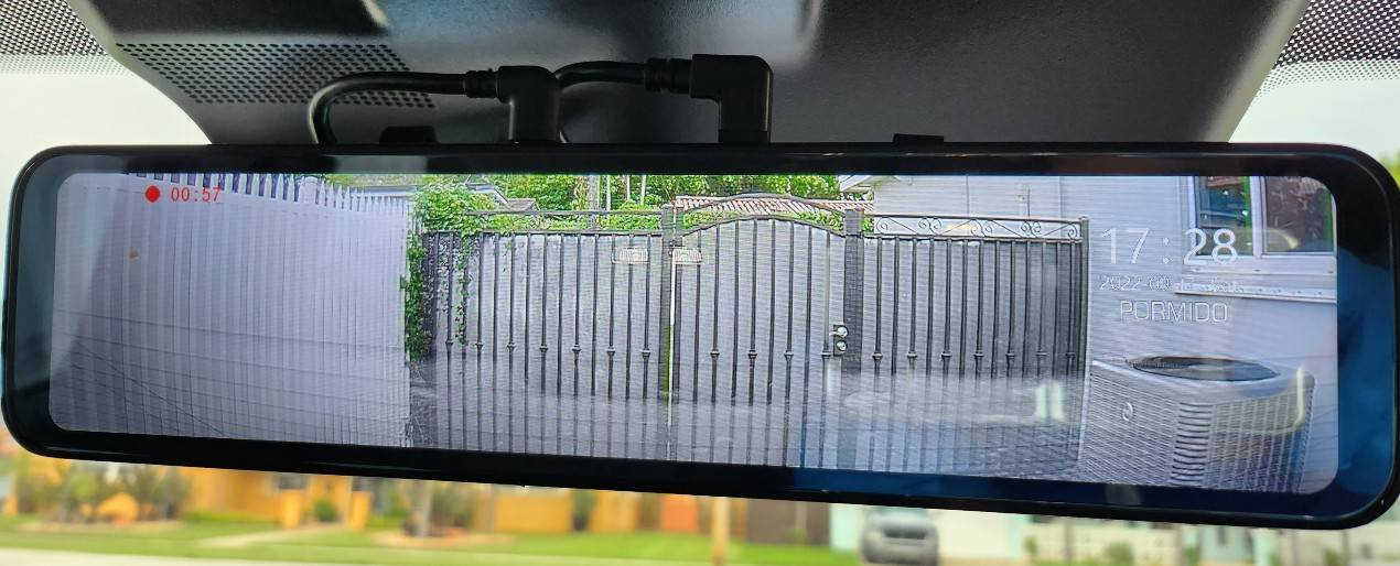

Rear view, camera mode:

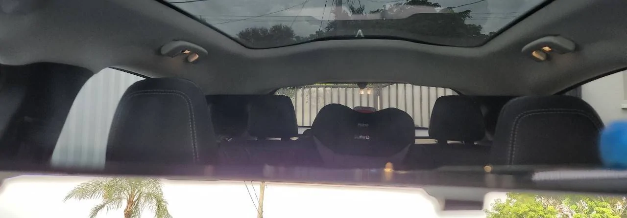

Mirror mode--more or less like stock, but from up close to prevent background from blowing out image. From normal driving distance your view would be narrower but hopefully you get the idea of how much is blocking your view back there. Even moreso if you have a large child seat mounted in the center. The small bump you see at the top center of the rear glass is the rear camera, mounted to the upper plastic trim piece:

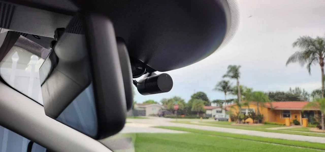

The front camera, mounted behind the mirror (and side view of the monitor strapped to the factory mirror):

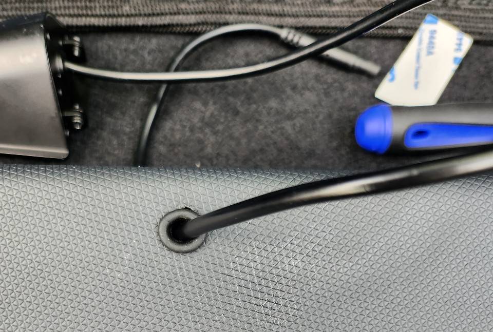

For the rear camera wire, I went the low route, along the floor down the passenger side instead of the headliner. I also used the driver (left) side tube/boot from the roof to the hatch, using a zip tie to fish the wire through.
I viewed countless other threads and videos as well; apologies for not linking them all; I will just send a general acknowledgement to everyone who shared some knowledge on this. I was reading and planning for quite some time, so if you posted, the chances are it helped me, so thank you.

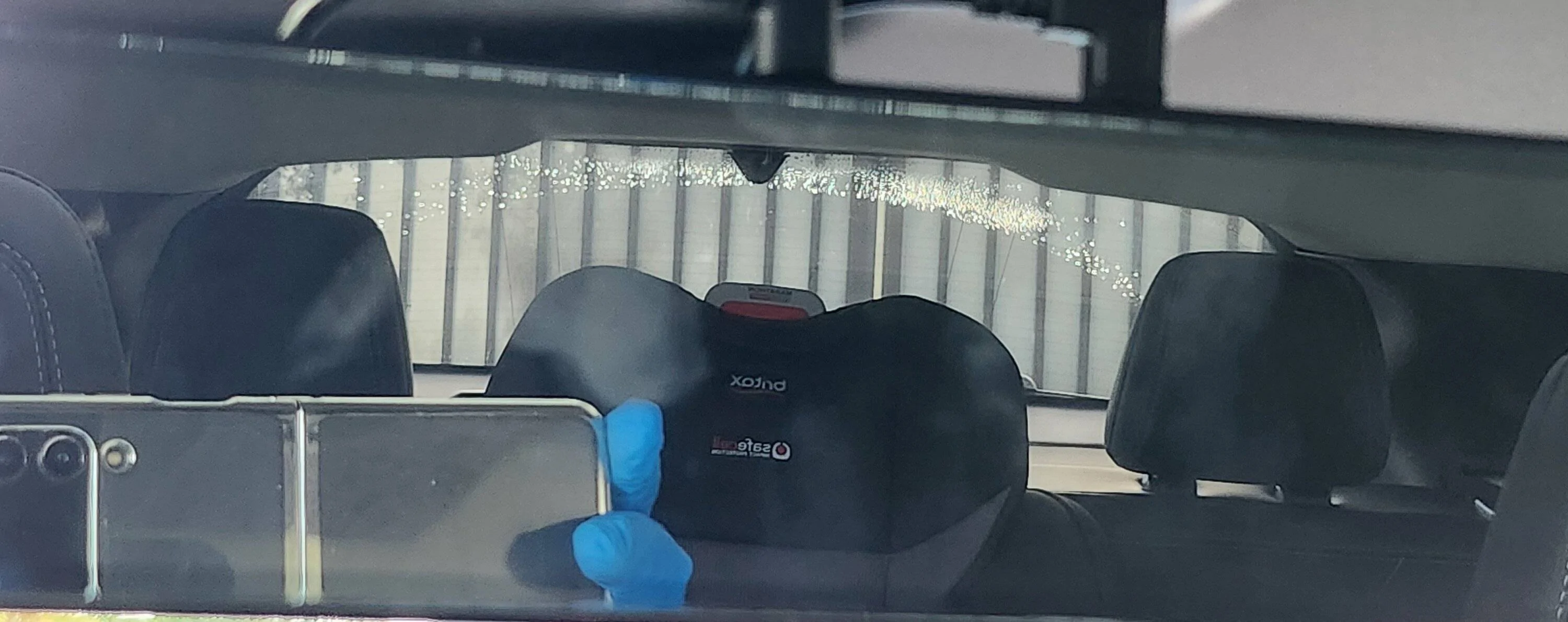

One thing that I didn't see mentioned anywhere is making a somewhat tidy hole with a grommet in the back panel for running the cable. You can see a close-up of the rear camera in the upper left corner, and the wire/coupler to the right of it:

I mounted it on the horizontal plastic trim at the top of the hatch opening. See the arrow here:

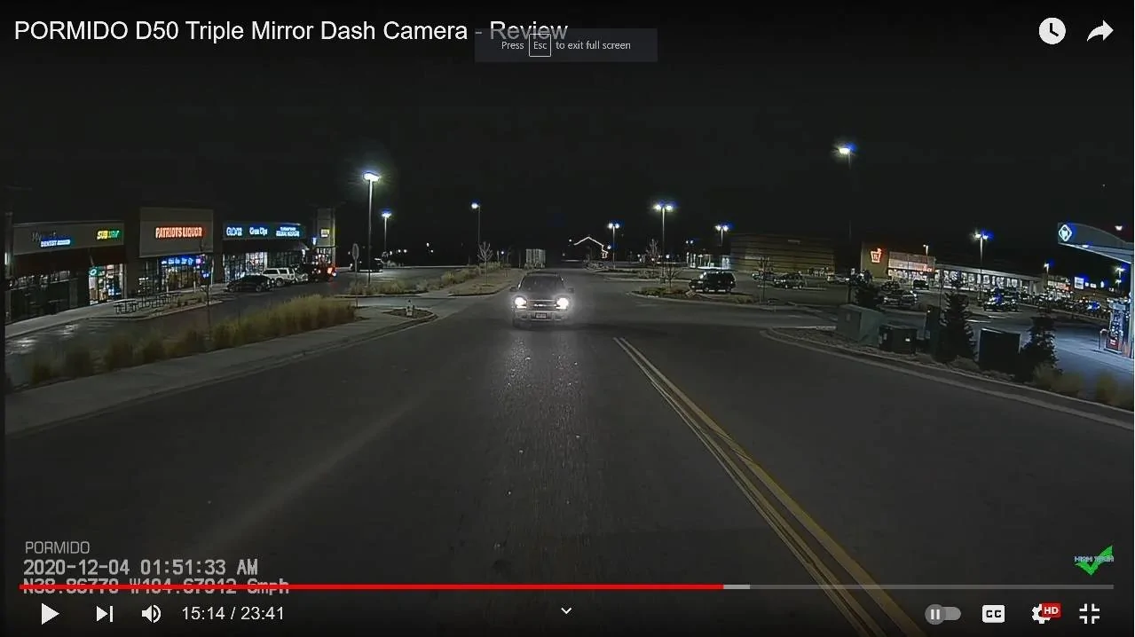

As for the Pormido, it does quite well resolving detail around bright lights at night (not my review):
Pormido D50 review with footage
I tried out a few different brands and models back in 2018 when I was shopping for these, and this unit was by far the best in this regard. I've installed four of these on friend and family cars and they thankfully all perform well.

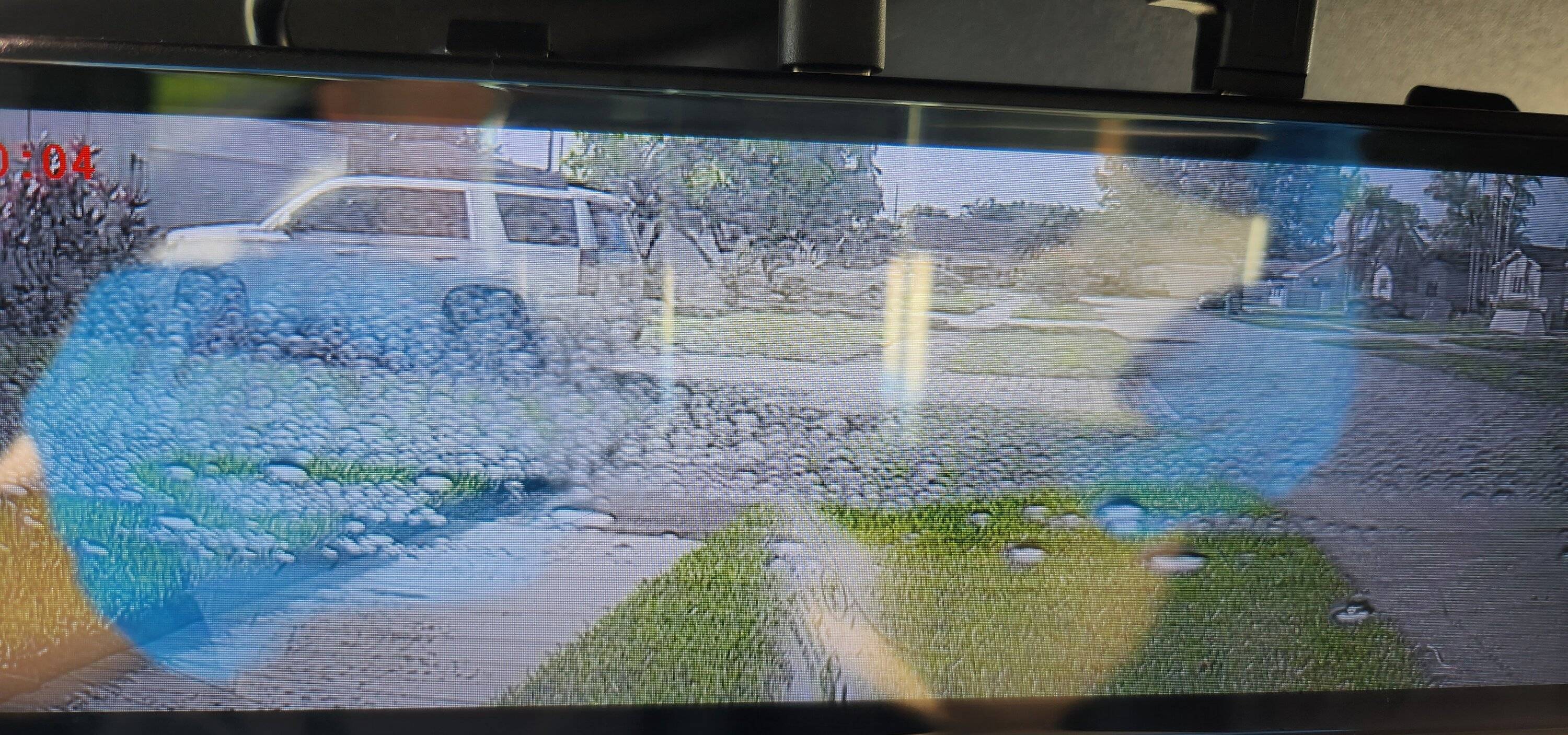

One slight wrinkle: a top inside mounting, such as my setup, is not in the swept area of the rear wiper. I found that with the untreated, mildly dirty glass, it was a problem. I've now thoroughly cleaned (including clay) and coated the glass, so hopefully it will be better. I am considering installing a longer wiper blade as well. Rain was a non-issue in the Blazer with its externally mounted camera.
Do you have the stock rear wiper blade or have you changed to the Trico 15-G? 😊🐩
I have the stock rear wiper and am considering upgrading to a longer blade. Is 15" the longest anyone has successfully used? My local Autozone has 16" single Duralast blades but I was in a rush and didn't have a chance to get a good look at the connector to see if it would work. I may yet give it a shot.
